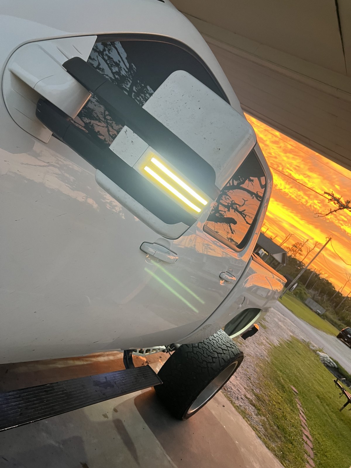

Color matched tow mirrors with led switchback turn signals

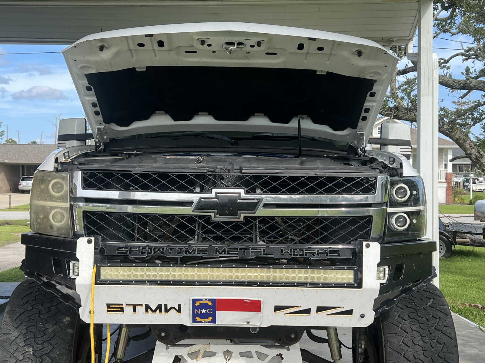

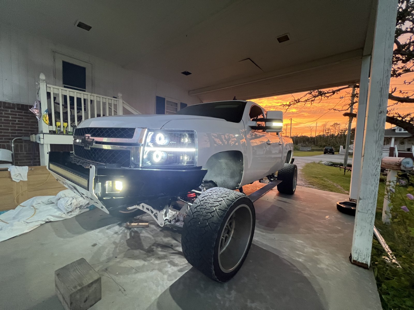

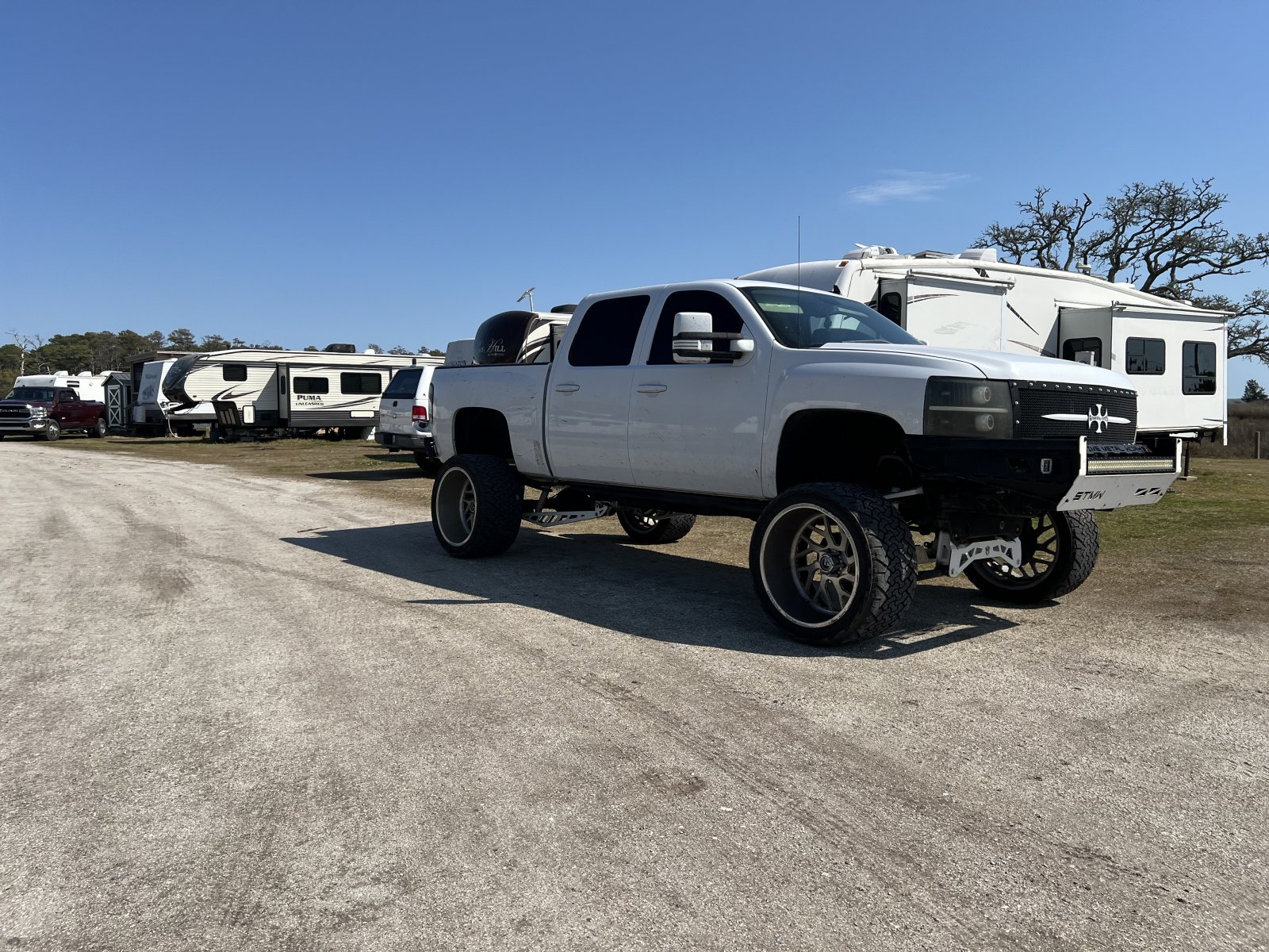

Nothing new really I swapped in a 2500 grill I still haven’t painted my bushwacker fender flares to put on it I still need to order halos so I can put new headlight lens and halos in the headlights

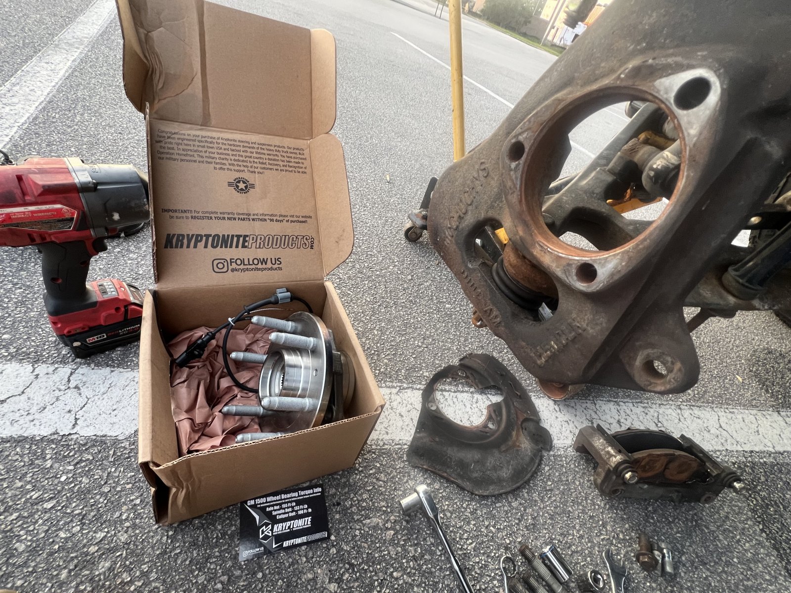

Did a wheel bearing and front brake pads last week along with a broke. Transmission mount on the tail shaft of the transmission AND currently getting the rear end rebuilt where that fell apart on me…

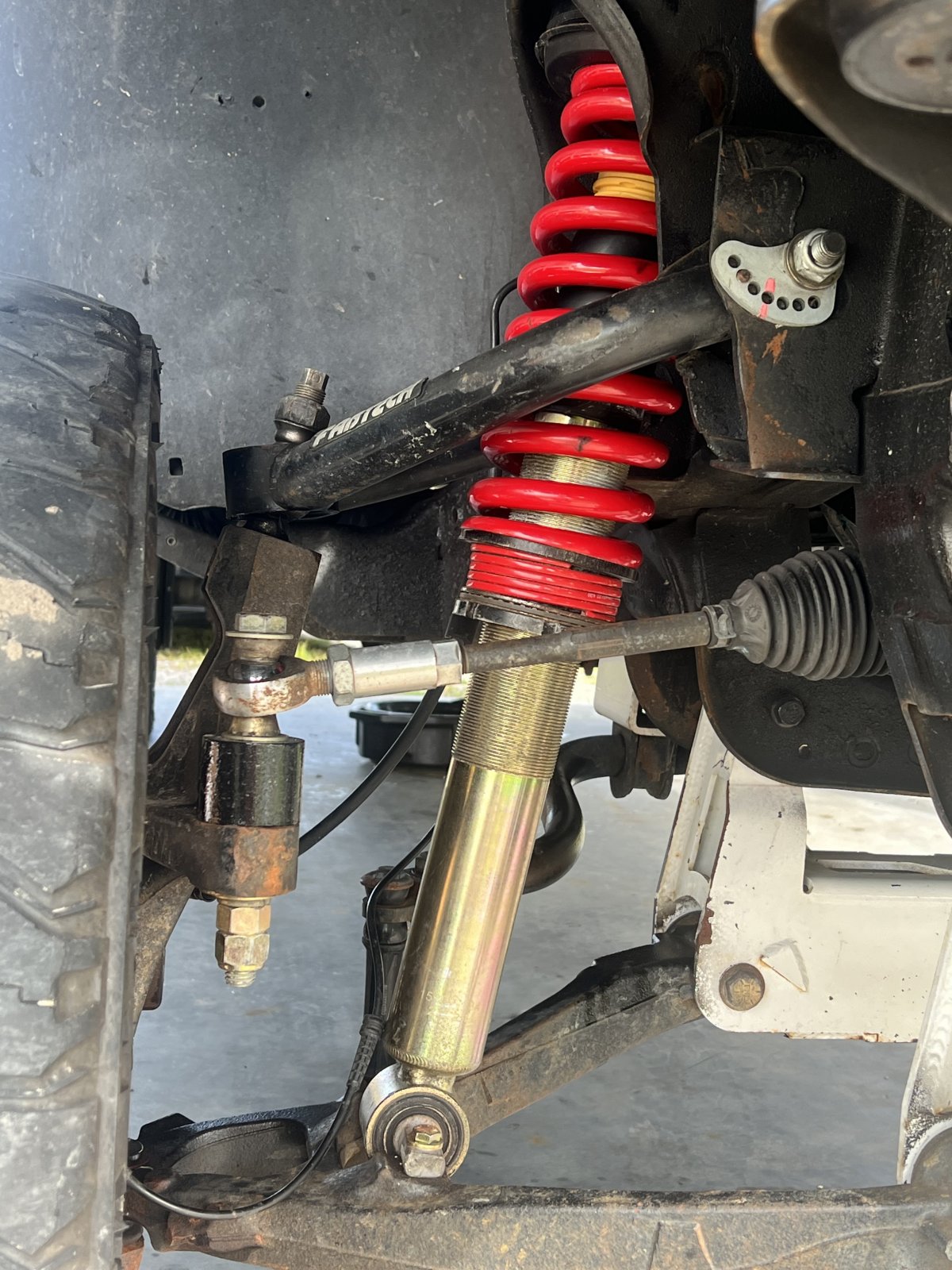

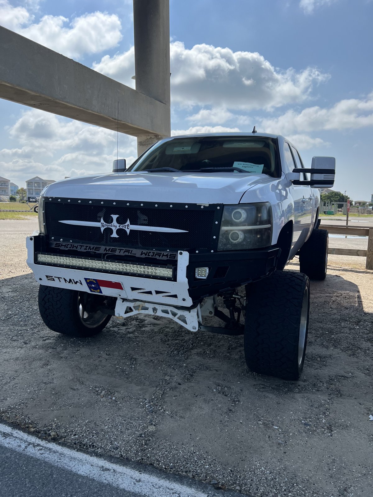

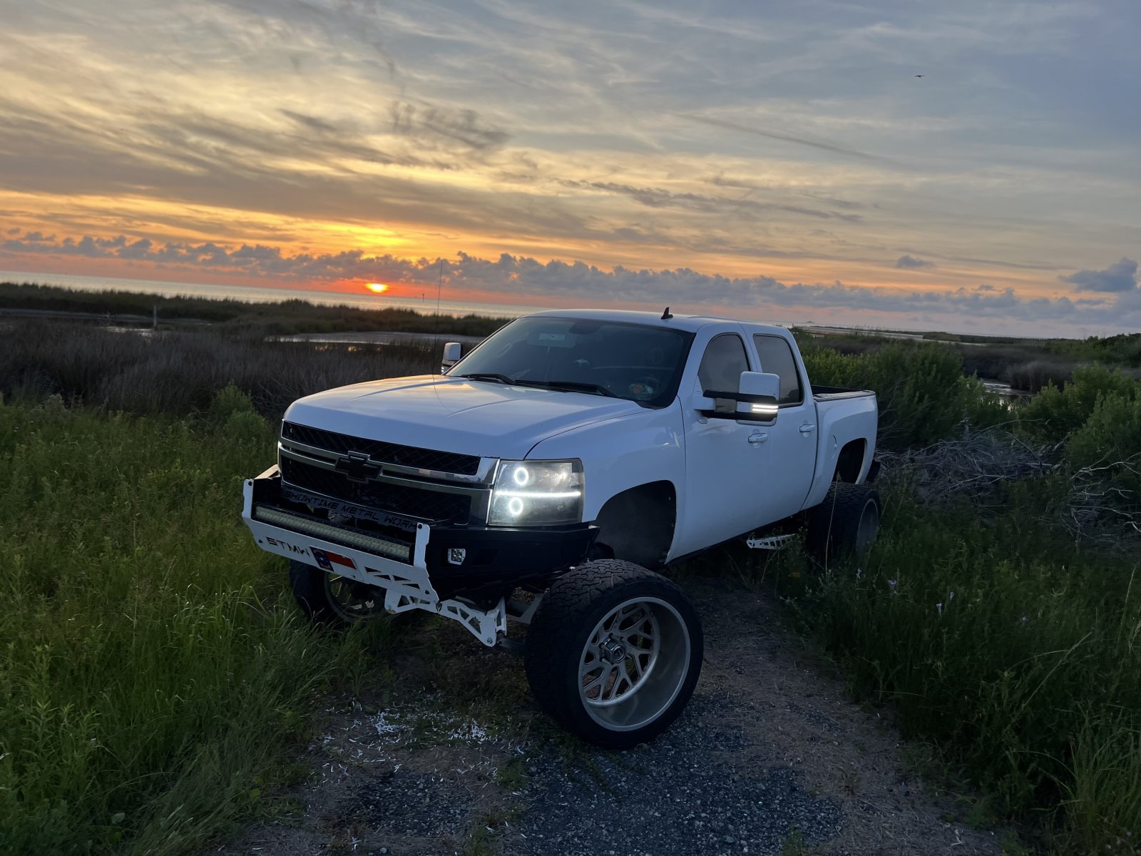

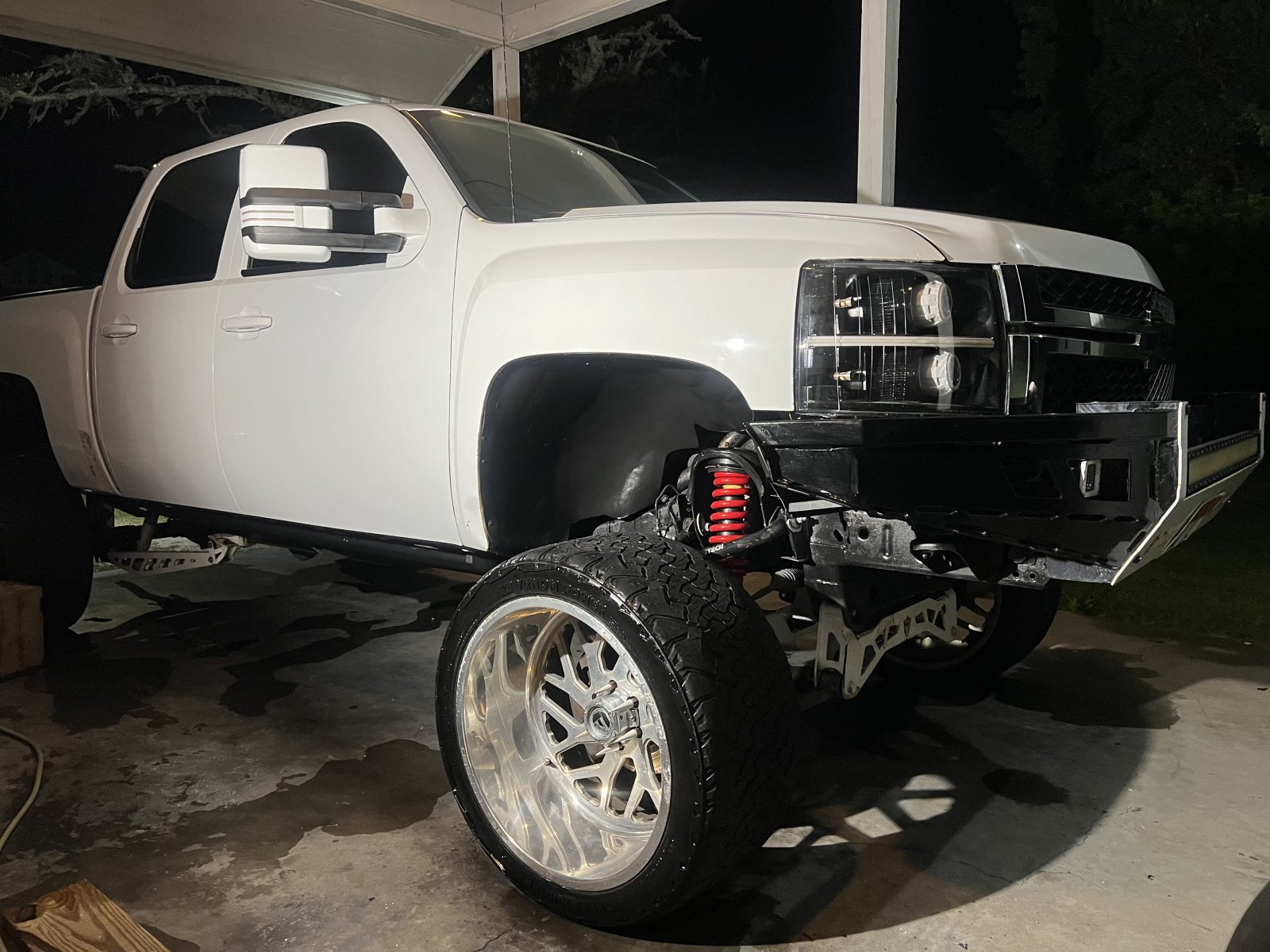

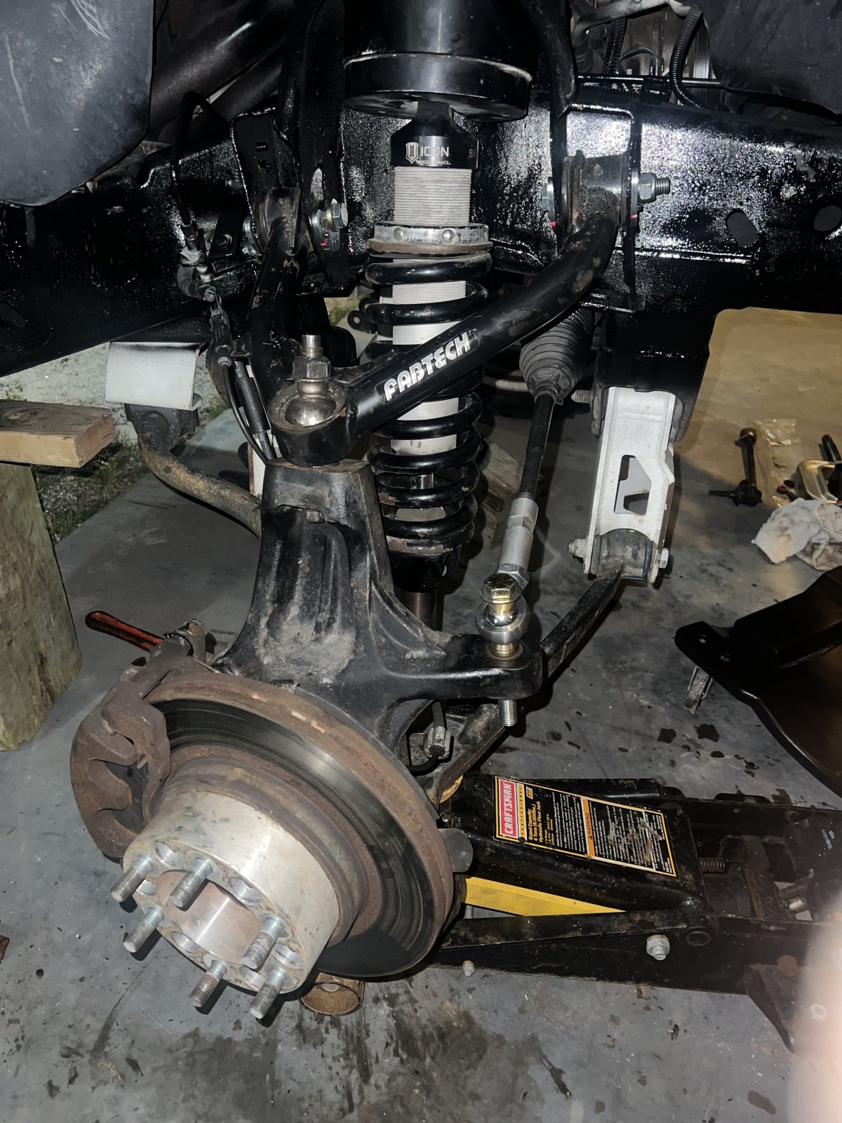

Got the rear end built
Tru trac posi with 4.56s new bearings and seals and new silver diff cover
Got some coil overs from @randeez i threw on there

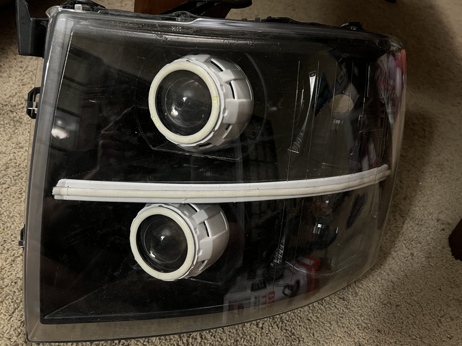

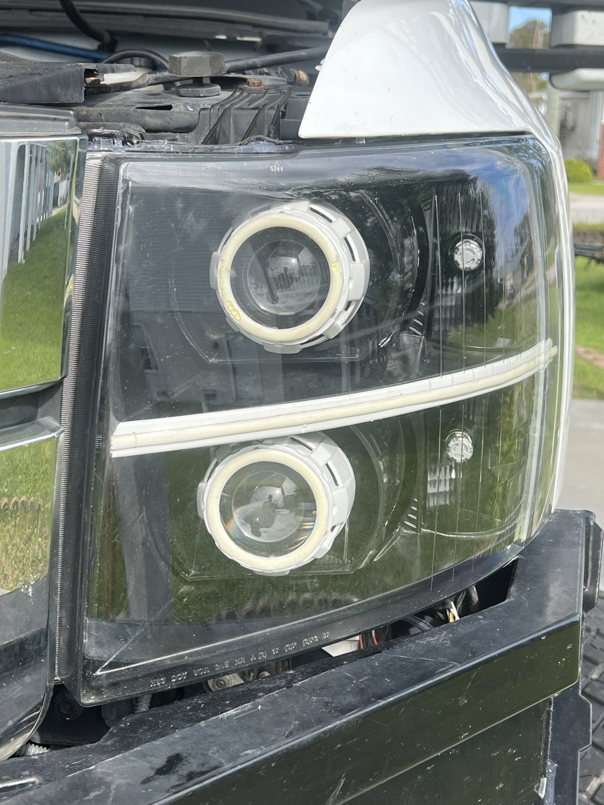

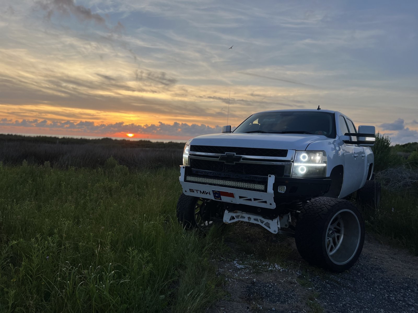

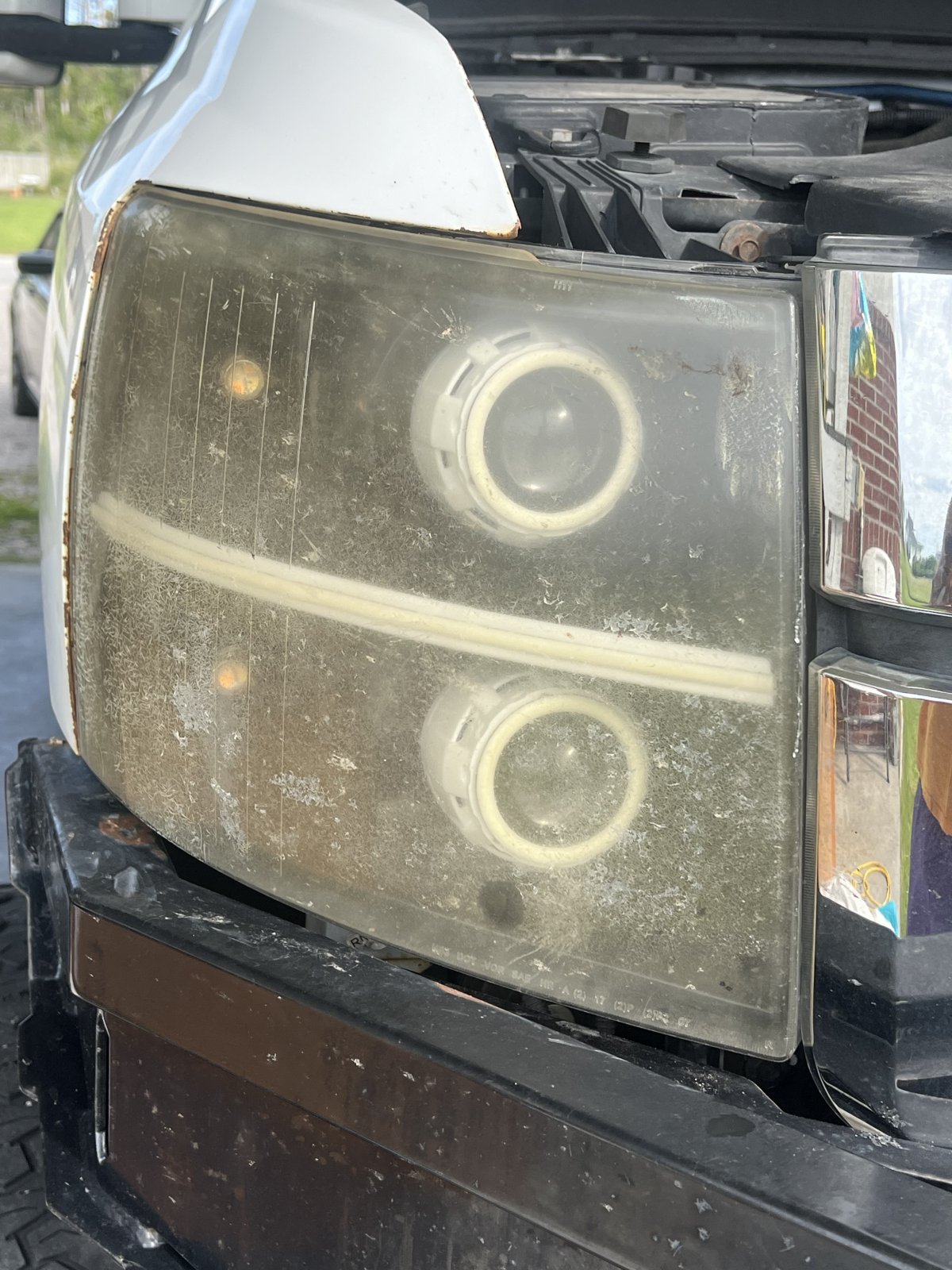

I also redid the headlights luckily the halo I thought was burned out isn’t it was just the switchback driver that went bad and another one has a loose connector I may swap the plugs on it for a toggle style male and female wire connector for a tighter connection and see if that fix’s it.
I still need to get the demon eyes in the projector hooked back up
Haven’t done much besides that stuff

how she ride on those coil overs?
for me they were a little firm but wanting to still drive 85-90mph in a lifted truck and not be all over the road had to compromise
T
Trey Hardy
Jun 12, 2020
3,552
9,637
Honestly not that bad they ain’t as bad as what the icons were I still need to get those rear fox shocks from you also though and ditch the mcgaughys shocks that’ll help out a lot hold em for another month or so and I’ll be caught up hopefully where I can get em off you! Ride is good I still need to dial the alignment though so steering is still a lil wacky but it’s good enough to drive for now… gotta get this overtime so I can go get her on the rack again… I need to find a buddy with some stocks also so she actually fits on the rack smh she’s too damn wide
