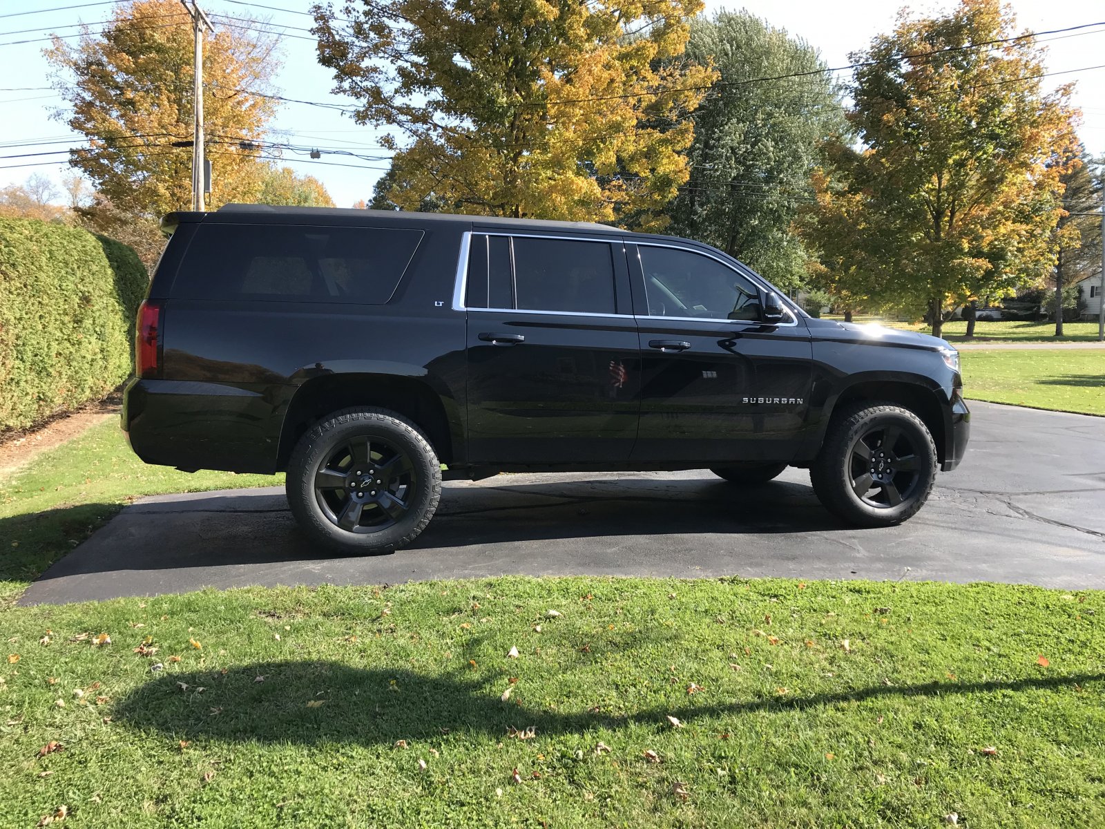

Well, I've installed the 1.5" front and 1" rear level, along with the 275/60/20 tires. It's a very nice looking combo and I have no rubbing. I think I probably could have squeezed a 275/65/20 in but I likely would have had some rubbing at full lock, which is another thing I didn't want on this truck. I'd imagine with a 2 or 2.5" level up front one could easily run the 275/65/20, but I didn't want to go that high.
The 275/60 tires are a full inch taller than the stock rubber with no rubbing, so that's an inch of ground clearance gained, which is nice and that's the whole intent of lift kits anyway.

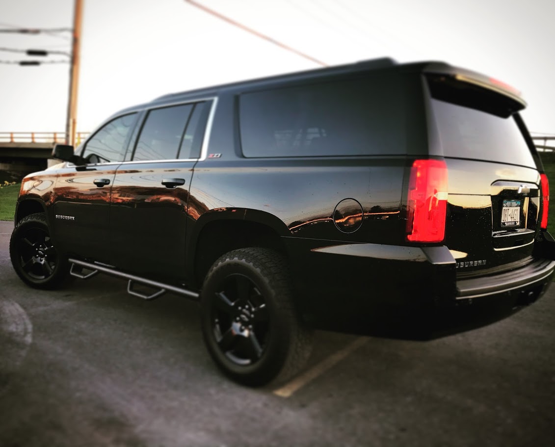

Here she is after I took the stock running boards off.

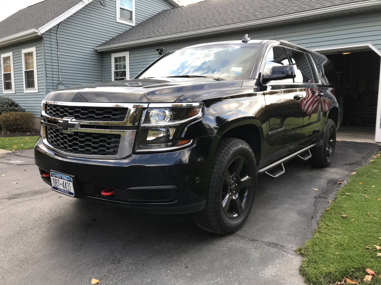

looks good, the removal of the stock step bars really makes the look appear higher...
RED TOW HOOKS ?? from where or are they painted ?
the wife would like a couple of red accents to her burb and i was thinking red hooks also. Like the look.

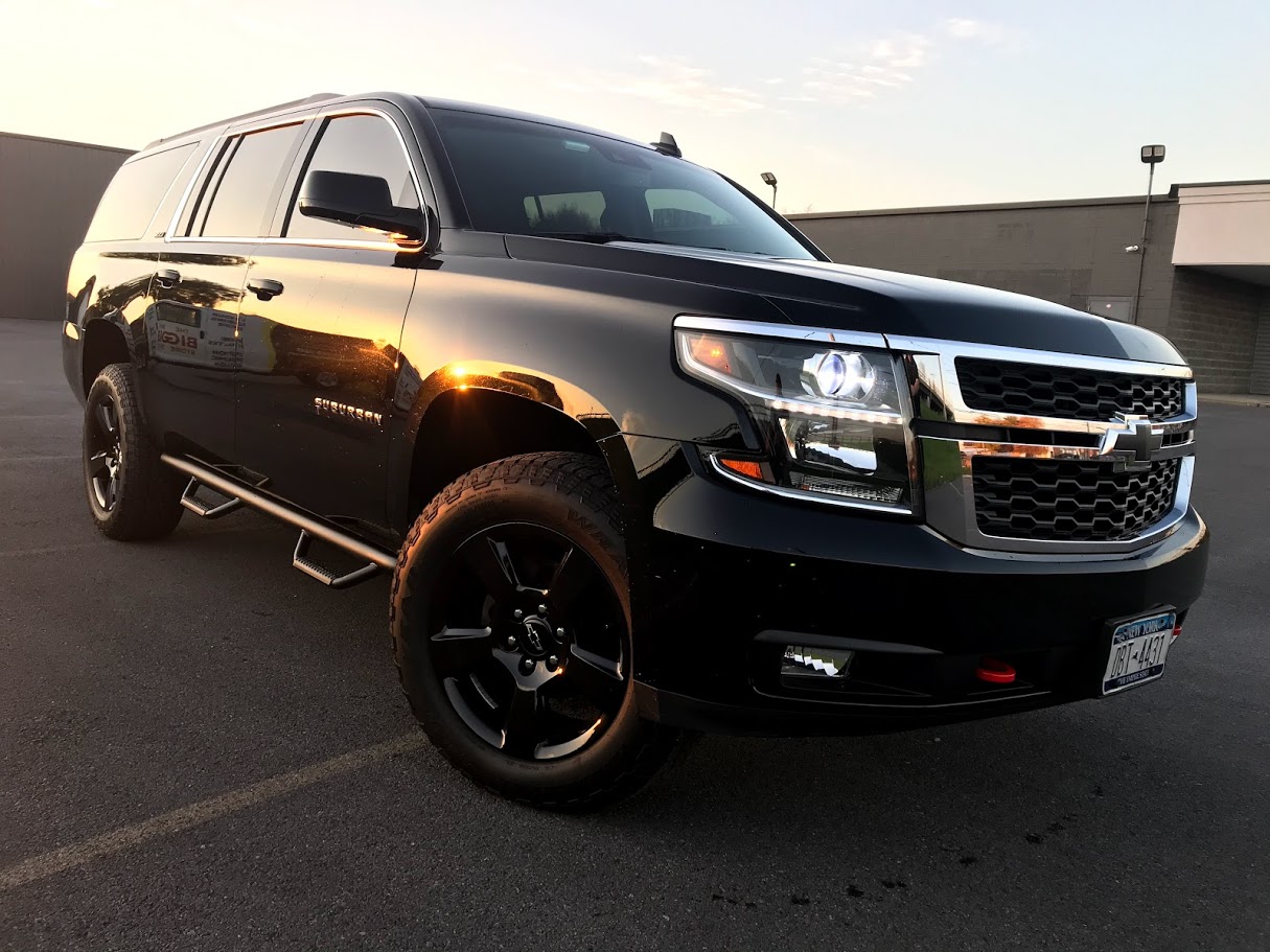

Thanks, I LOVED the way it looked with no side steps. Unfortunately my kids really do need something to clamber on in with, so I ended up getting those Rough Country steps shown in the second photo. If those start to rust out after a couple Central NY winters, I'll probably just take them right off and leave it with no steps.
The tow hooks are stock GM parts, I just painted them red with some Rustoleum. Since I took these photos, I also added some Z71 badges (with the red "Z") in place of the original "LT" badges. Got myself a decent Z71 clone. The red of the hooks and the Z71 badges provide complimenting accents.
Thanks for the kind words on the truck!
