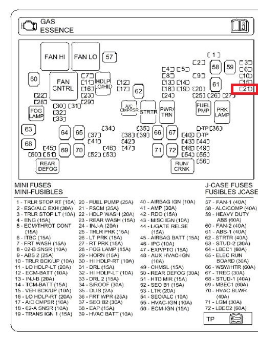

Parked my 09 Denali for a couple weeks. Tried to start and cranks but no fire. Trouble shooting, I found the fuel pump fuse was blown. Replaced it and still wouldn't start...didn't blow the new fuse either. There is a spot in the under hood fuse box for a relay, but isnt one there. Anyone know common causes of fp fuse blowing? Hoping it's not the pump, truck is in rough shape and not worth putting a lot of money into.

If I look at a 2010 fusebox, it looks like the fuse for the fuel system control module is in position 21, to the right of the fuel pump fuse. Not sure if yours is the same. Have you checked that one? Also, it would be good to probe both sides of the fuses to verify voltage through them.
Do you know if you have fuel pressure?
I think mine is the same, just didn't recognize the abbreviation for the control..will check today and get back...thanks you!!!
Finally got time to get back to the truck. You got it! The fuse for the fpcm was blown. Replaced it and fired right up. Unsure what would cause both of those fuses to blow, so not sure yet if it will be a recurring problem. Thanks for your help!! I like this forum and will contribute when I can!
