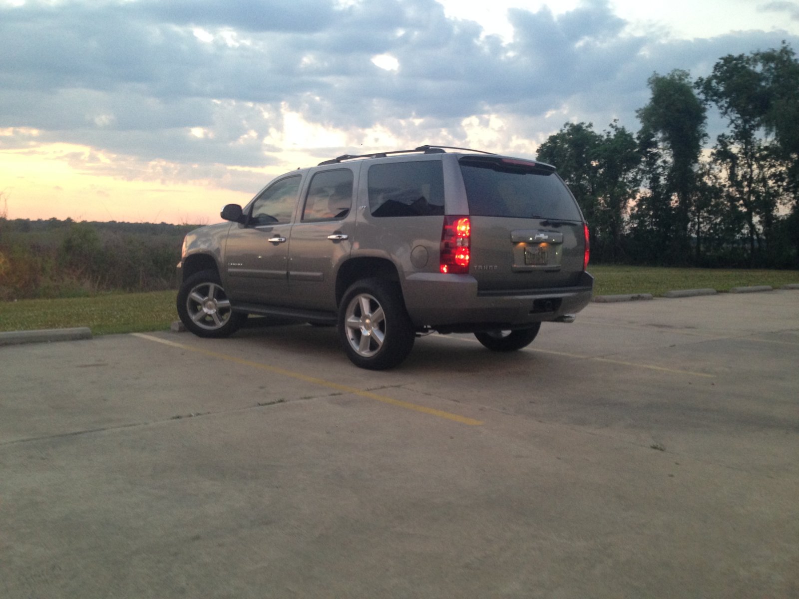

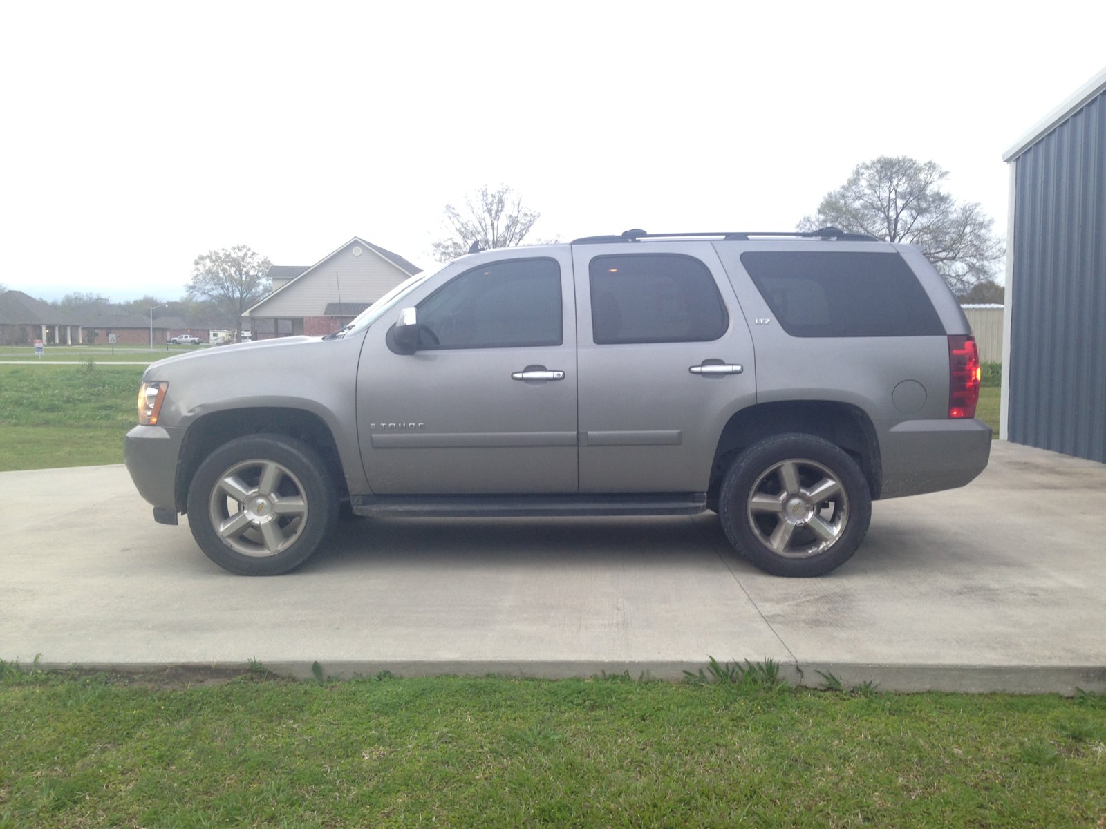

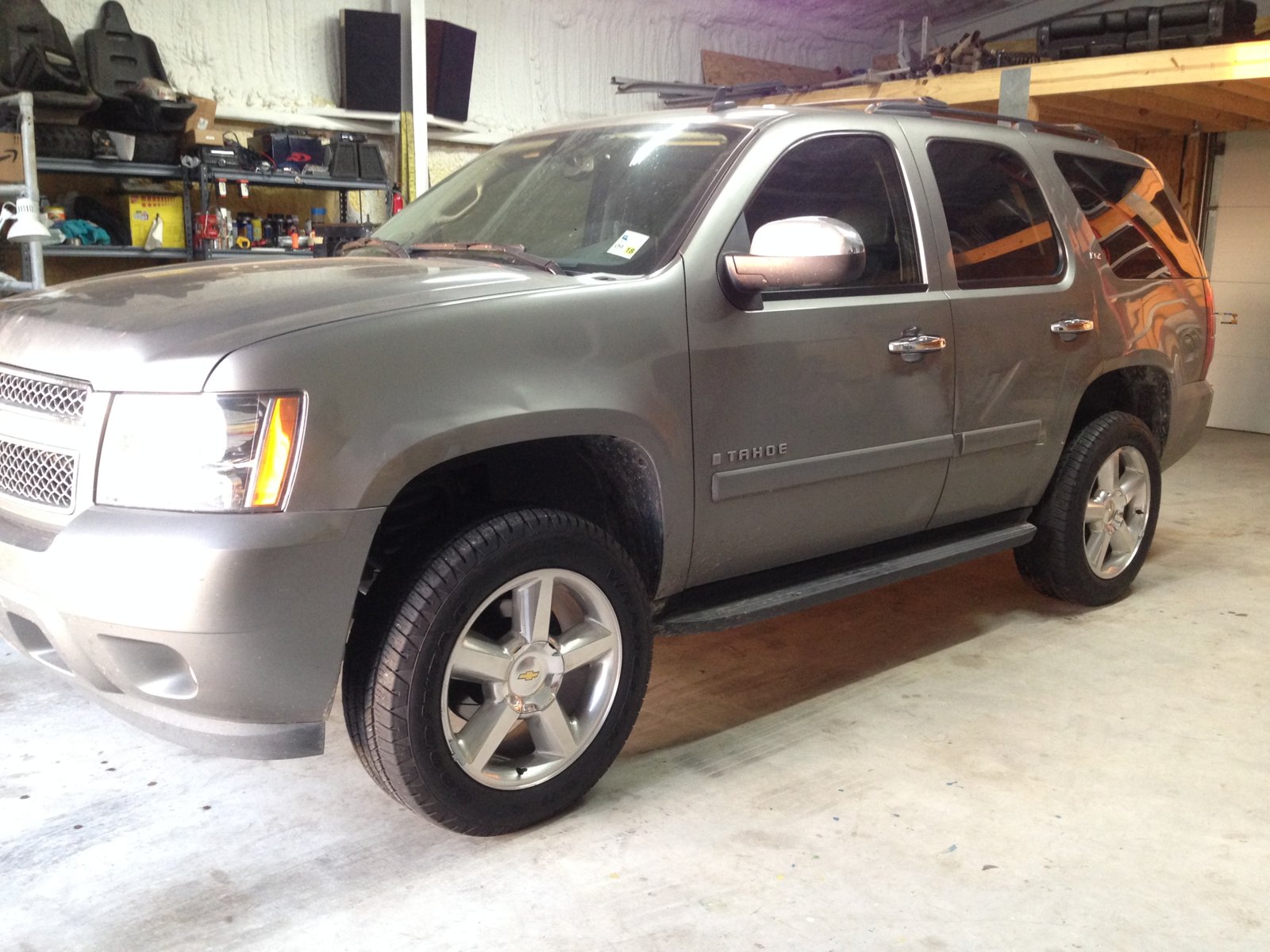

I'll post what I have. You can refer to my sig pic to compare stock-versus-lifted.
This is right after I lifted it. It actually sits more level than this, the rear springs probably needed to settle a bit since they were unloaded for a little while:
After washing it, rear settling and with new all-season tires. Oh, and after a little PDR on that front fender arch:

While parked at the store:
Again, I have 1.5" wheel spacers that help to improve the "effect", but may skew your wheel-to-body perception. So, keep that in mind. Also, my Auto-leveling system is inoperable, so that's not a factor.
