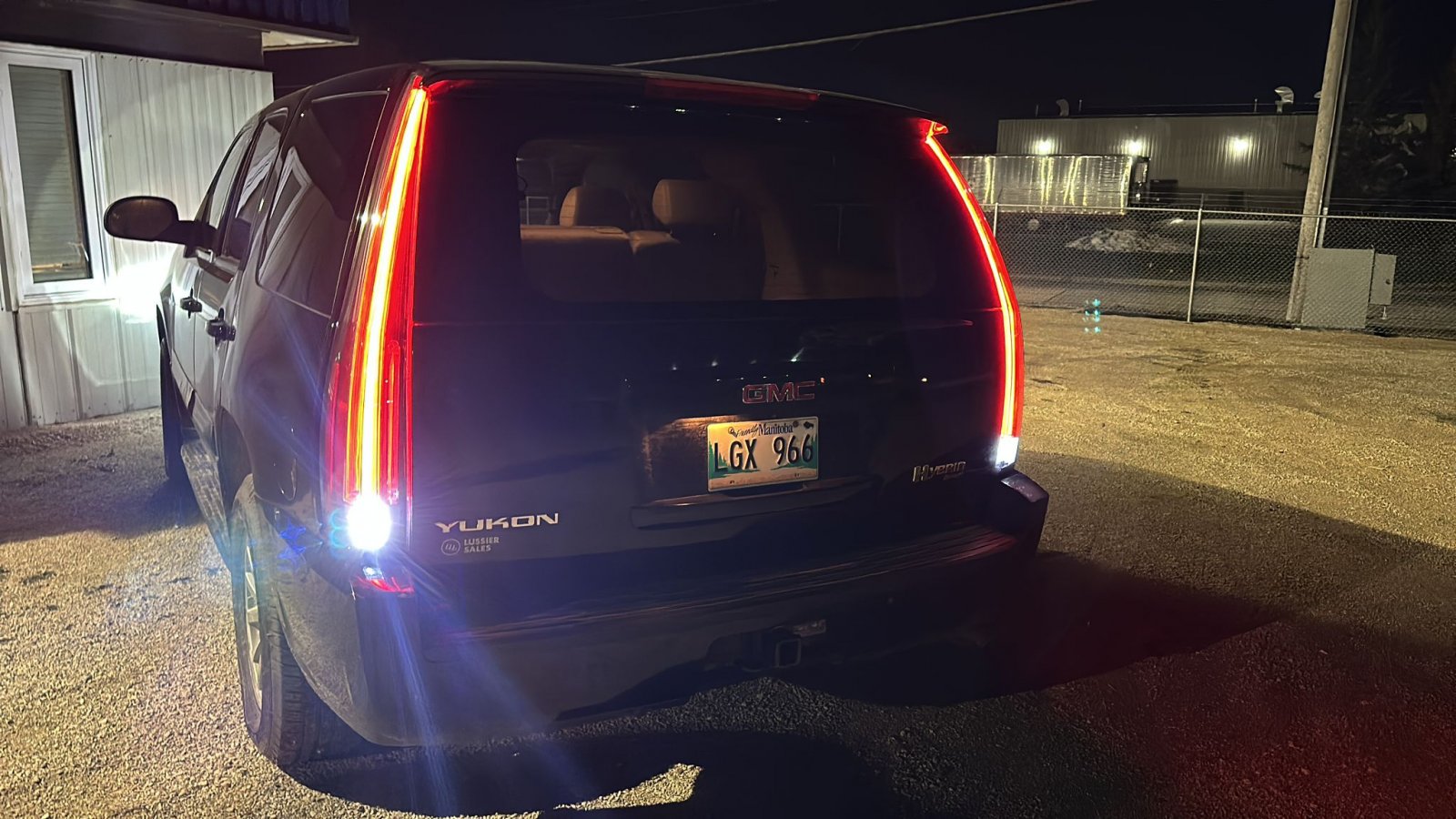

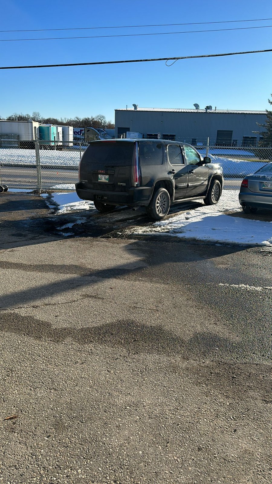

I did the Cadillac escalade light on my truck and it was plug and play.View attachment 414917View attachment 414916
it might be the hybrid yukon tails lights are different than the hybrid tahoe, since the Tahoe used a different aluminum hatch, the yukon doesn't. but after seeing your post I took a chance and ordered some tail lights that said except hybrid. thinking eh, I'll just move some wires if need be.
but happy to say they worked perfectly. the reverse light sockets do seem to take a different style. bulbs, the oem one works, but feels a bit loose. I was going to cross reference the Tahoe bulb and see what they used. but either way, I'm happy to get rid of the oem lights I didn't like.

Glad it worked out. I worked in enough of these GM things to know that it very minimal. I just di the Mirimoto HID lights. They are awesome
