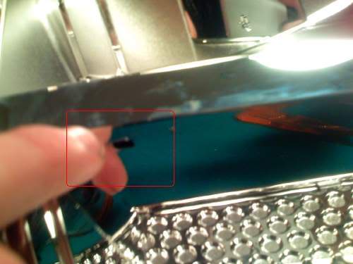

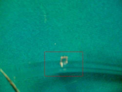

12.) Take the orange side reflector out
there are 3 clips on each one. Push on them from the inside, then flip them over and take a plastic knife to pry them out.
13.) Tape them ugly orange reflectors on both sides.

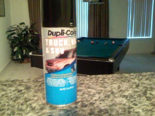

14.) Paint the reflectors on both sides. You chose, I went black cause I am doing my whole lights black. When I cleared my lights, I used chrome paint.

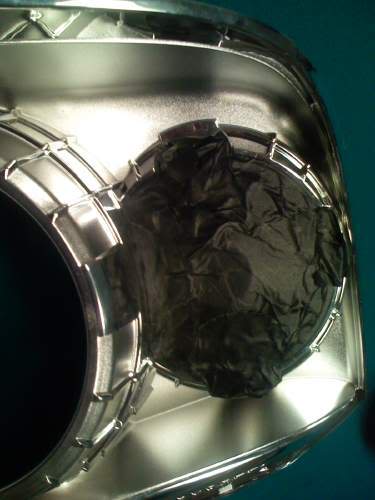

15.) If you are painting your inside lights, tape off the top clear cover. I couldn't get this darn thing out... there are 3 clips, and I could only get one out. So I just taped it off.

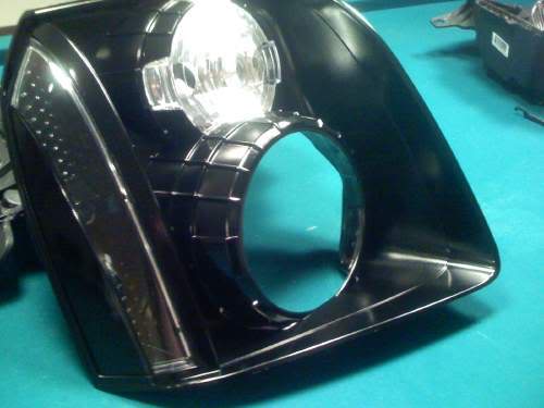

16.) Paint the inside of your lights. I had to use like 7 coats, cause the paint wasn't sticking to the chrome parts well. I probably should have used etching primer...
17.) Let them dry, then take the tape off
18.) Place the coners back in, the old orange reflectors that are now chrome or black.

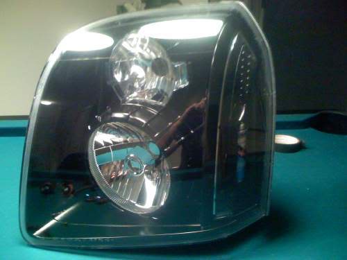

26.) Take the bungees off, look at your lights.
27.) Put your bulbs back in
28.) Put the lights back on your car!
I'll post pics of them on my car tomorrow morning!
