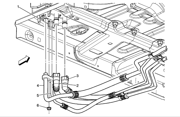

If Im not mistaken, the AC lines run under the pass side step bar and are notorious for corroding and leaking. Id start there.

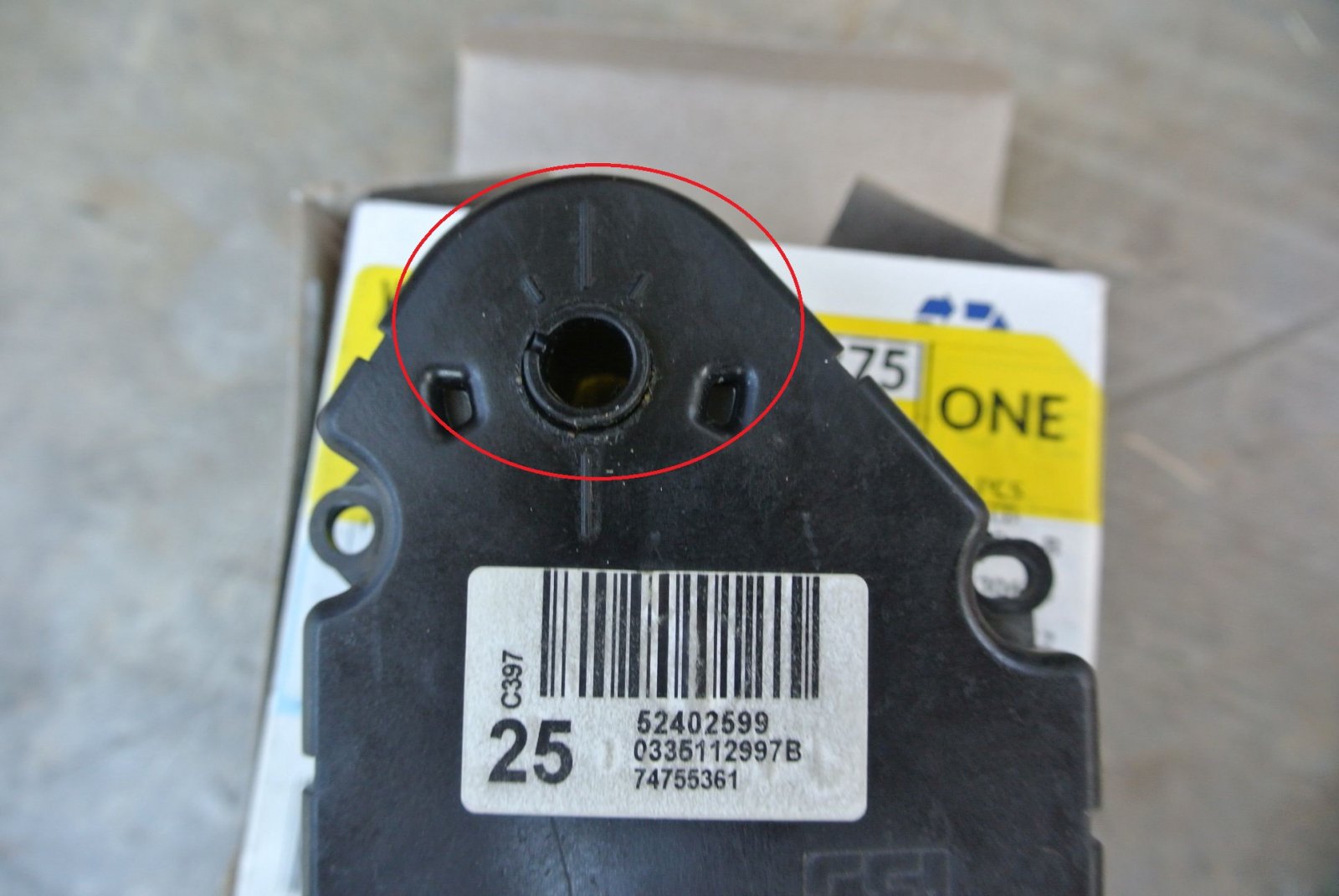

so did you remove the rear passenger side kick panel and visually watch the actuator? or did you simply adjust the controls?
the rear ac lines will not be very cold at all one will be warm and one will be very slightly cool, they are the metal lines
best thing to do is to simply pull the panels off in the back and look at the actuator to see if it is really moving or not, the one closest to the blower motor is the one that controls hot/cold
the center portion has a hole and notch in it, the notch should move all the way forward/backward to the corresponding marks on the outer casing, see attached photo for reference
