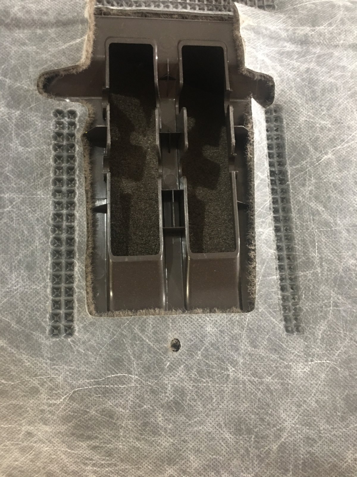

The plastic pieces don’t have part numbers, at least on the one’s I’ve purchased, individually, off eBay as well as the ones embedded in the OEM, new old stock rear carpet I got.
Here’s the new carpet on the backside showing how the manufacturer melts the PVC into the carpet to bond it.

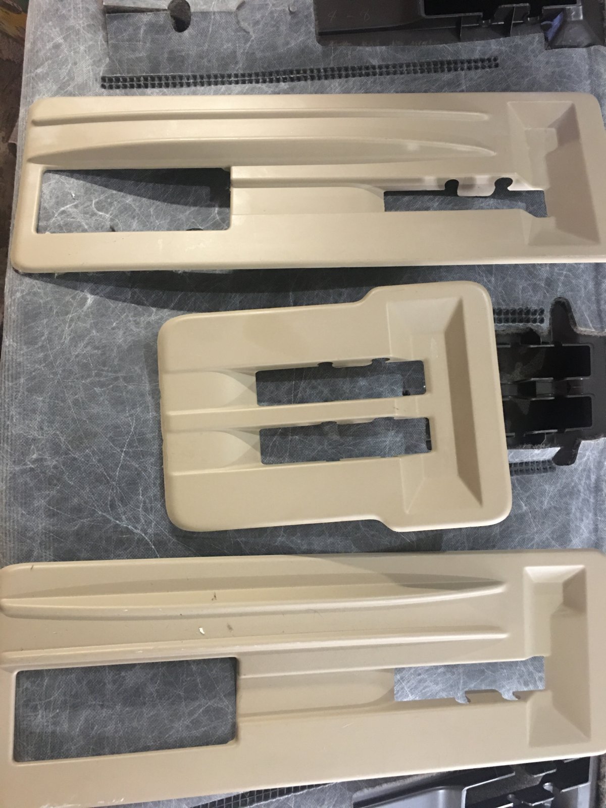

Here’s pieces purchased off eBay that’ve been cut out the carpet with a knife or saw blade. My bet is these plastic slides can’t be purchased from GM parts.
I just realized that if I would of purchased an aftermarket replacement carpet kit I would of had to remove these out of the existing carpet and graft / glue them into the uncut, aftermarket rug.
Anyway, if you need the tan pieces I’m not going to use, $50 + the cheapest post and they’re yours. That’ll bring me flush for what I’m into them.

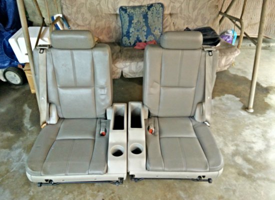

By the way, is this the style of 3rd row seats you’re installing? I love these things.
The only thing you’d have to be sure on to install these in a Tahoe is ensure from the peeps on the forum that the 3d row seats and plastic sliders are not specific to the XL chassis. If not, you’re golden and you’re third row passengers are styl’n.
