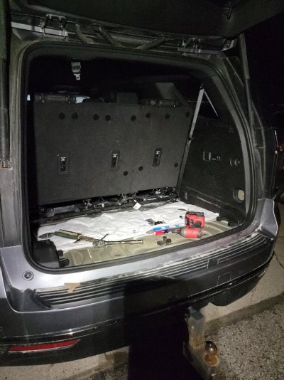

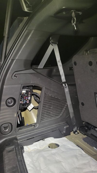

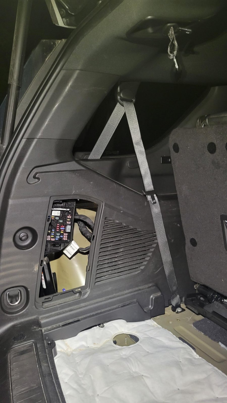

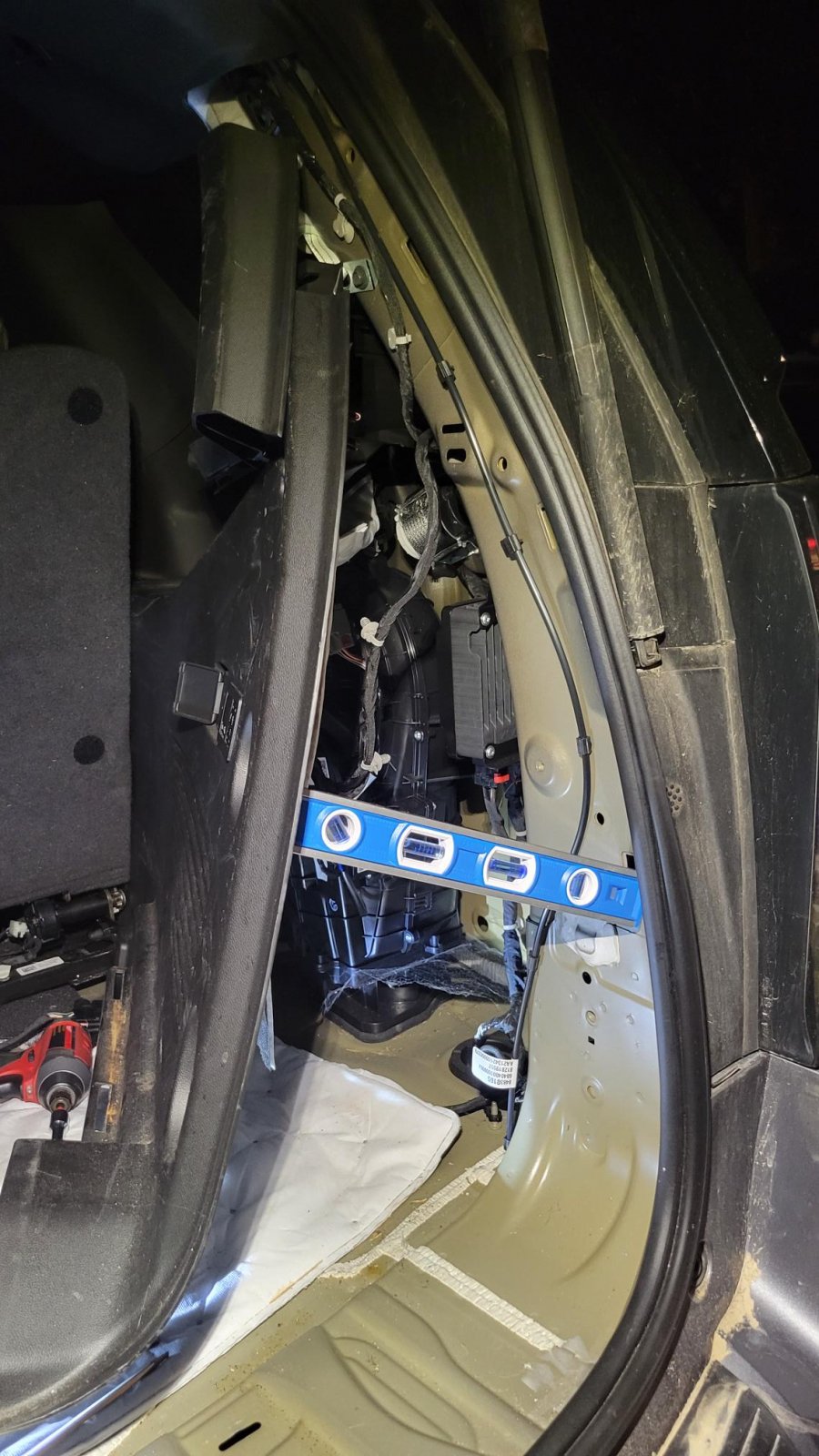

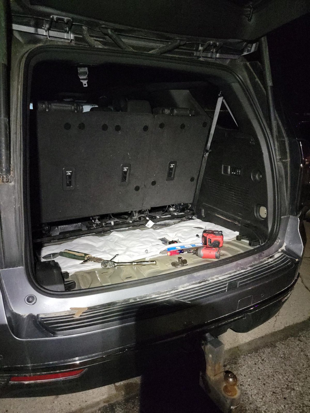

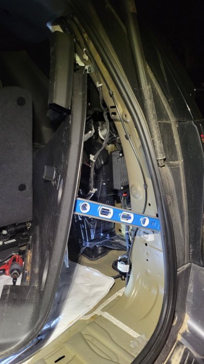

I ended up doing this last week. It wasn’t that bad, but it's a little of a pain.
Here are the parts.
85553511Driver Side 3rd Row Seat Belt Retractor$68.95
855535173rd Row Passenger Side Seat Belt Retractor$65.05
You have to move the 3rd row seats up to get access to the bolts that hold the seat belt. This is the hardest part. There is a good post on how to do this. 3rd row seat removal Premier Edit:deck added | Chevy Tahoe Forum | GMC Yukon Forum | Tahoe Z71 | Cadillac Escalade - Tahoe Yukon Forum I tried to get to the bolts without doing this, but after doing the whole thing. You need to remove the 3rd row seat. The bolts go through the car and you can see them between the wheel fender and the mud flaps. Mine were already a little rusted which made it a little harder to get them out. The driver's side is easier to do than the passenger side. You open the access door, and you can see the bolt for the seat belt. On the passenger side, you need to remove a few more plastic to give you access to the bolt. The retractor has a little pin on it that slides into place so It stays while you put the bolt in. Took me about 2.5 hours in total. I am sure I could do it faster now.
