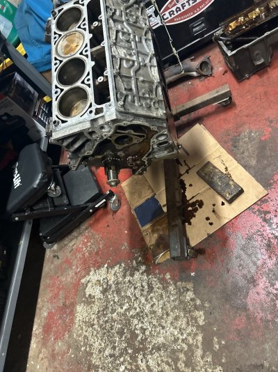

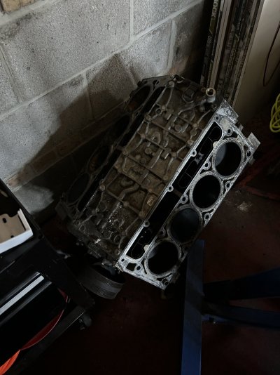

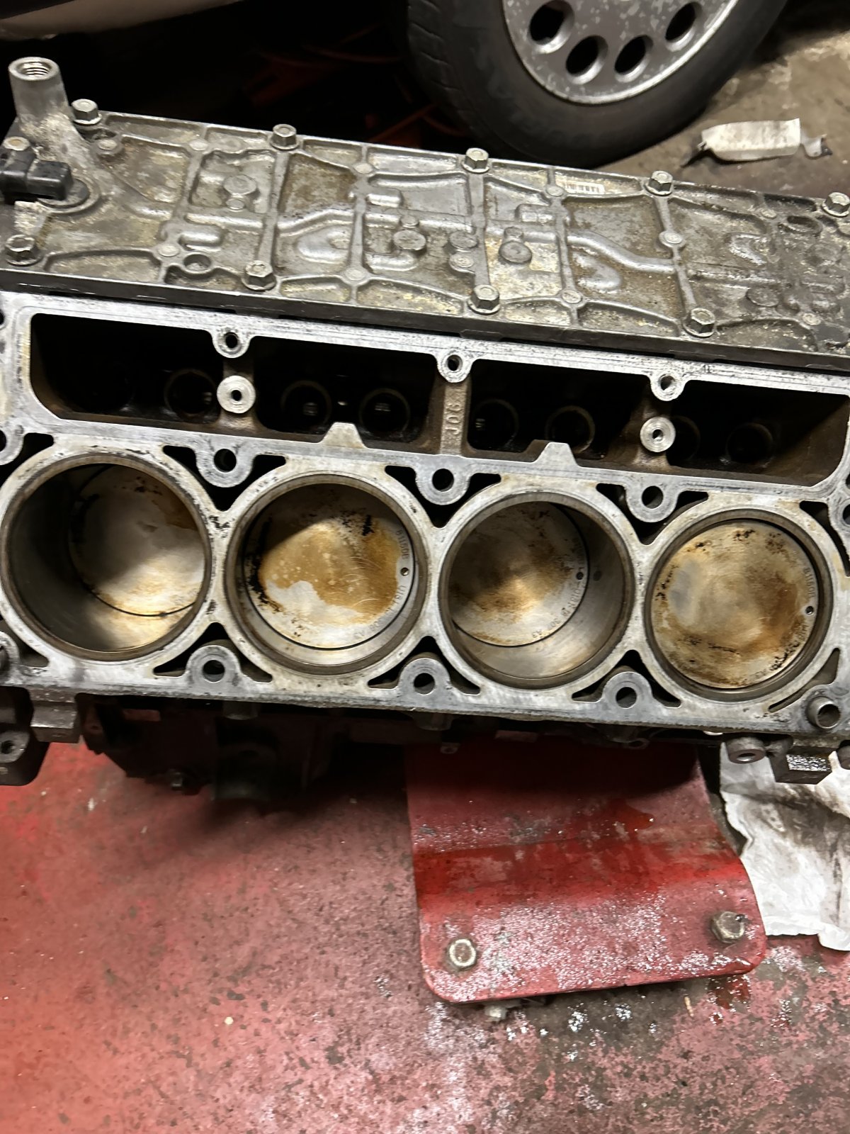

Thanks for the response when head was off all cylinders on the bank were similar. I did clean them up with a brass wire wheel. I attached some before and afters. Motor just turned 201k cylinder walls were great still had some cross hatchings,PO travel the Midwest so he stated all highway miles from when he purchased at 60k. I will look into VLOM cost any suggestions were to get one a good cost? Also any way to test the vlom?
All sounds good. I tore mine down to delete AFM right at 200K. The cylinders looked great and all the compression numbers were very good. The VLOM is the control center for the AFM and the first design had flaws which GM greatly improved on. They also improved the design of the AFM lifters.

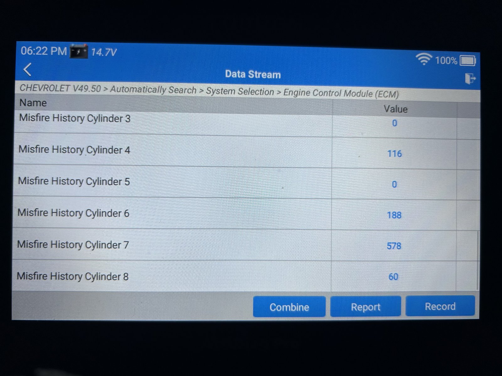

Thanks haven’t done the spark arc test yet may look unplug everything tomorrow and re tighten/verify all ignition components are sound. See pic now it has multi Misfires at 1st it was just 3-7 after restart it seems to be across the board.
45,012
Thanks haven’t done the spark arc test yet may look unplug everything tomorrow and re tighten/verify all ignition components are sound. See pic now it has multi Misfires at 1st it was just 3-7 after restart it seems to be across the board.View attachment 416742
And this steers me back to an AFM-related issue. AFM cylinders are 1, 4, 6 and 7. Yes, there's a #8, but its count is much lower and could be a false detection from the adjoining cylinders. Or, it's the low oil pressure affecting all the lifters but affecting the AFM ones more.
