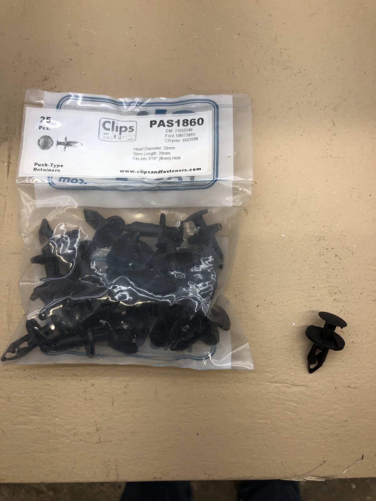

Here’s the only ones I’ve needed on my 02 Denali and 08 Silverado. There might be one or two of the other type that just pushes in and doesn’t have a pin but I got those at the parts store I think. These work for the wheel well liners and the core support cover under the hood. I have never broke one but if they get a little bunged up from r&r then I replace them. I like them to look new.

Thanks.
That looks like one of them. The other looks like a headed single barbed spike with no slider. I have no idea shy there were different ones used.

Just buy the ones I showed you from clipsandfasteners. That’s the only size of those you need, and takes care of 95% of what you need. The others are just the Christmas tree type and there’s only one or 2 sizes, they’re kind of forgiving and they go by hole diameter. This isn’t a difficult thing.

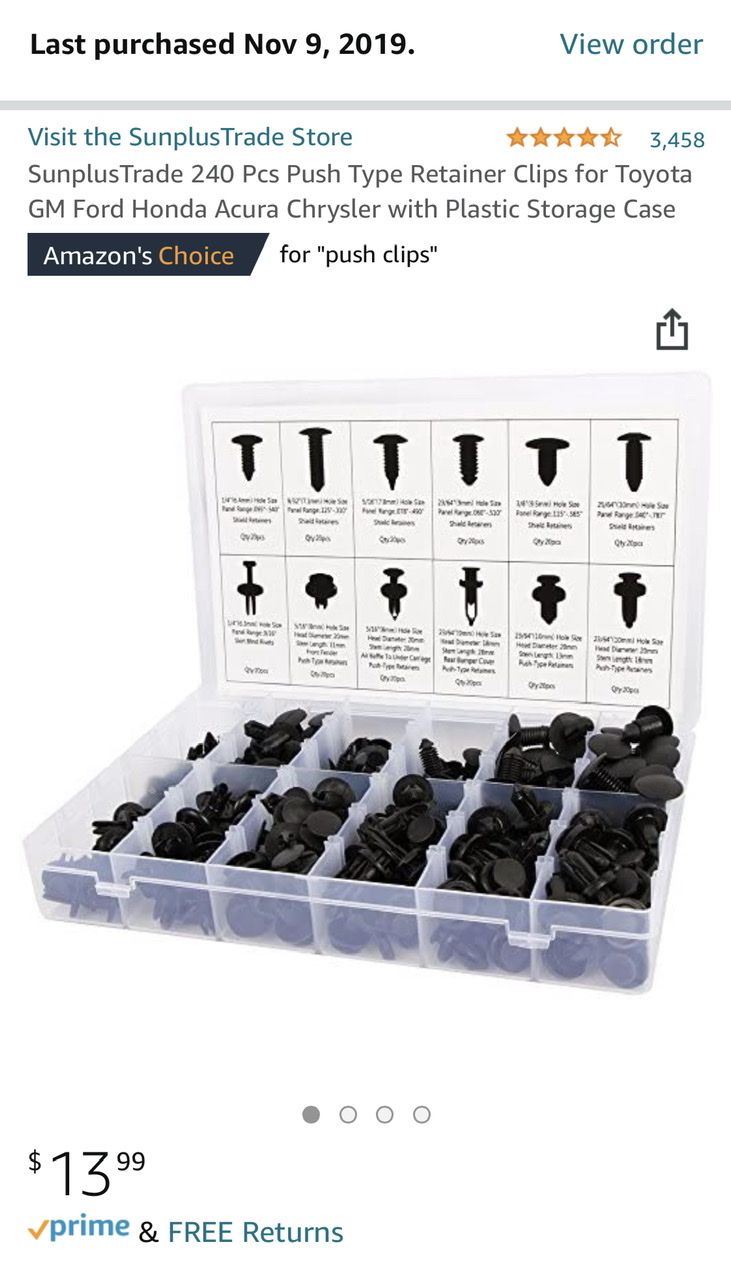

Here’s the cheap set I ordered from Amazon...
The good thing about this set is the variety and they hold well. But dang it...most of the tops peel right off when I try and relieve the pressure. I then need to drill them out.
Glad I remembered about this thread as my supply is running low and will be ordering the ones @Rocket Man suggested.
