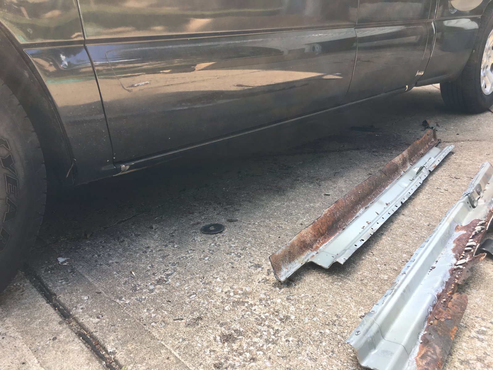

Rusty rockers and cab corners replace with new metal. One step closer to being ready for paint

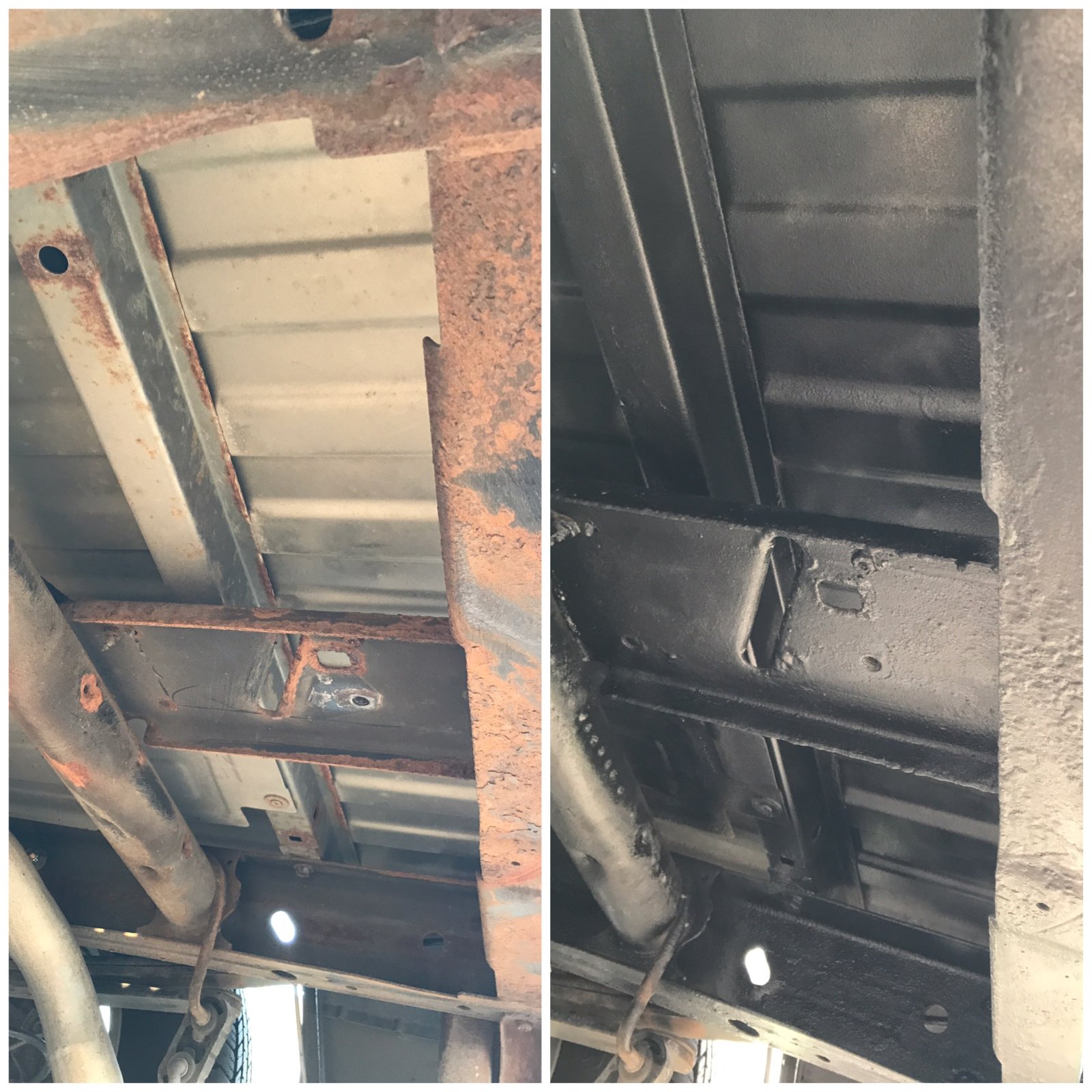

Another before/after shot for @Shaggy :D
Knocking off all the rust on the underside and here's an example of the project. Knocked down the scale, coated with Por15 and then when over that with some black Chassis paint. Got the back half done and will get the front half done in the next few days

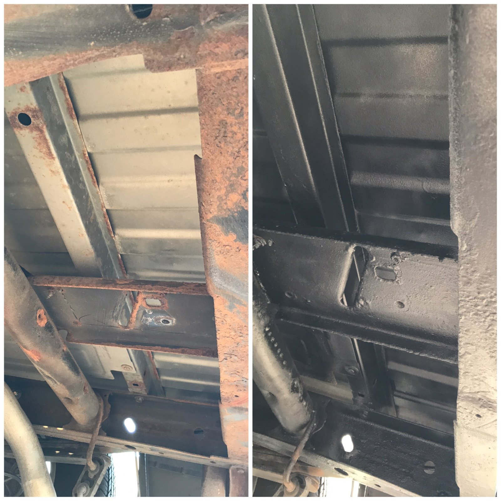

Did you do this on a lift somewhere?
50,977
19,519
Damn. I was wondering. Every time I even think of doing that my everything starts to hurt. Nice job.
Lol only did it cuz it was driving me bonkers and I knew if I at least started it I'd for sure finish it
