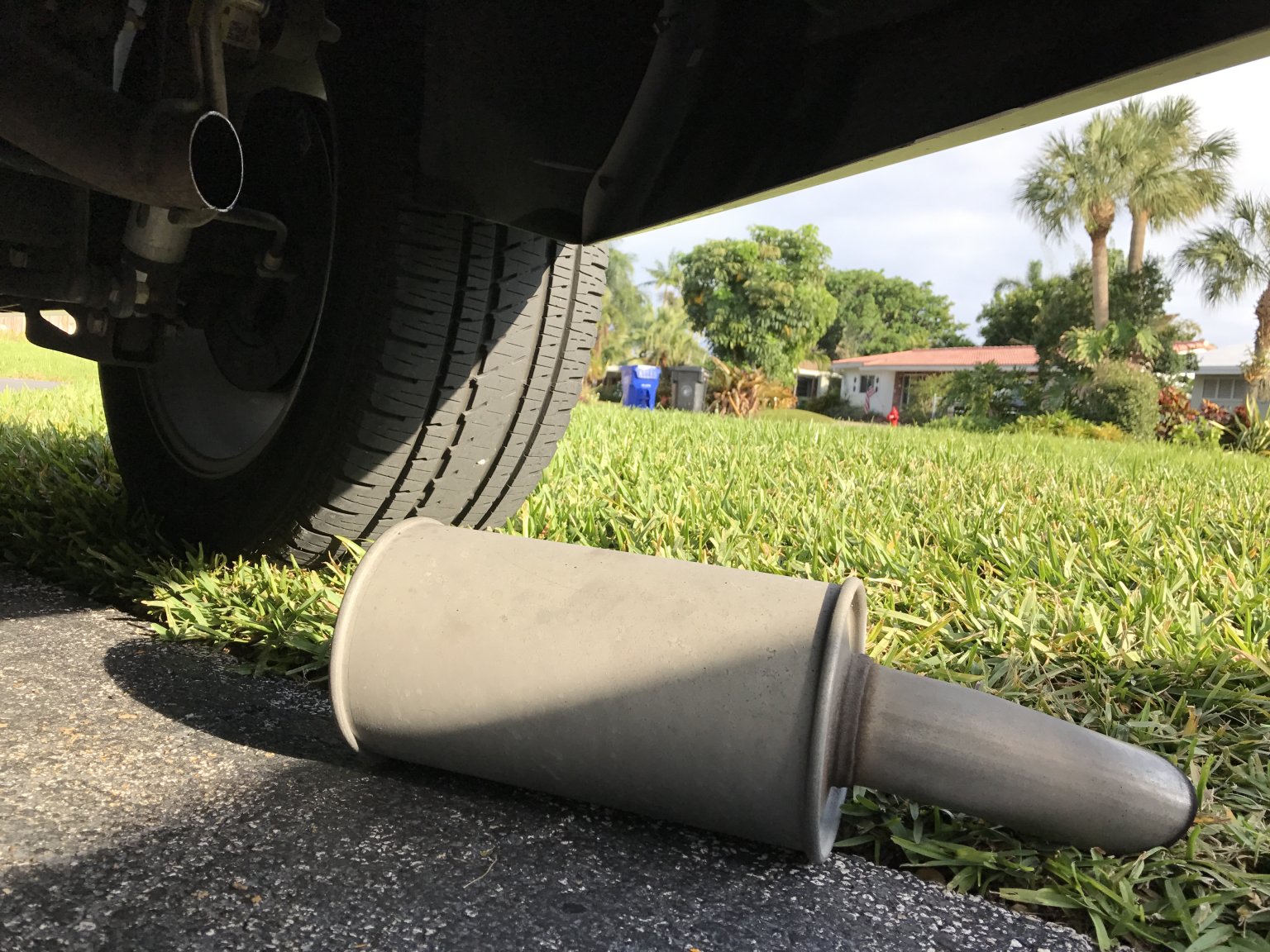

Here's the resonator cut off of my 13 Suburban just for a visual, then you can add the SLP Kit, get your own tip or leave it naked like I have. There has been no change in tone on mine from cutting off the resonator.
That MIT tube could be a winner without having to change out mufflers. 08HoeCD can vouch for that sound. Quiet for the Mrs. at cruise, with a bit of roar at throttle.
