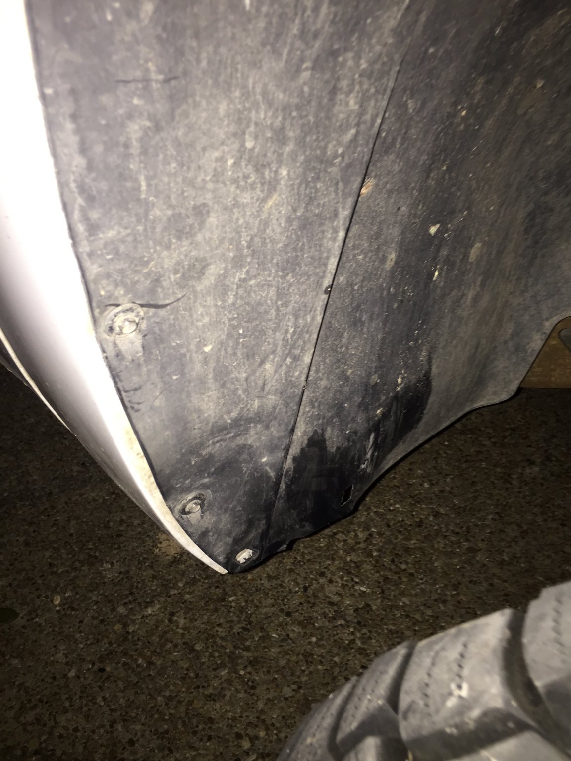

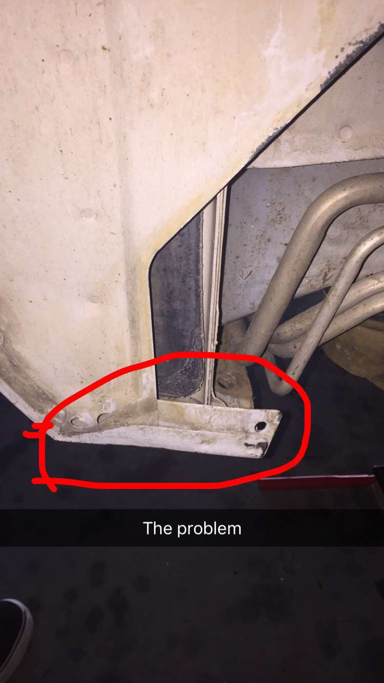

Only the front right tire rubs. front left is close as hell but not touching, the rears have plenty of room. Tires = Cooper ATP 285/70/17
The outside edge of the tire rubs against the lower mid area of the wheel well. I removed the plastic lining and there was metal behind it and other electrical components. I used a hammer to bend some of the metal back out of the way...cutting the metal would make for a better temp fix. just worried about destroying the tire

You can't go any higher than 2.5 on front without getting into major issues. Either using the 5100 plus spacers or staying with 2.5 spacer.
You can get a 3" body lift. Should relocate all parts up. Think zone or rough country makes them. I prefer the 1.25-1.5" body lift for trucks but haven't experimented with them to see how they fit the Tahoe.
Look up NorCal mod for back side of fender trim. If your rubbing on the front bumper then you can get some pro comp bumper brackets to trim up the edges.

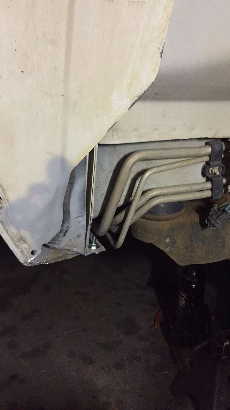

I performed the NorCal mod this afternoon and it was a breeze. I ended up taking off more metal than suggested but in the end it still looks neat. The pics below are of the rubbed area behind the plastic lining. Once the lining is reinstalled you can no longer see the cuts
Zed you're totally right, I still rub slightly when at full lock reverse or uphil right turns.

Yup that clears up rubbing issues. Post some final pics with the liner back on and tire clearance.
