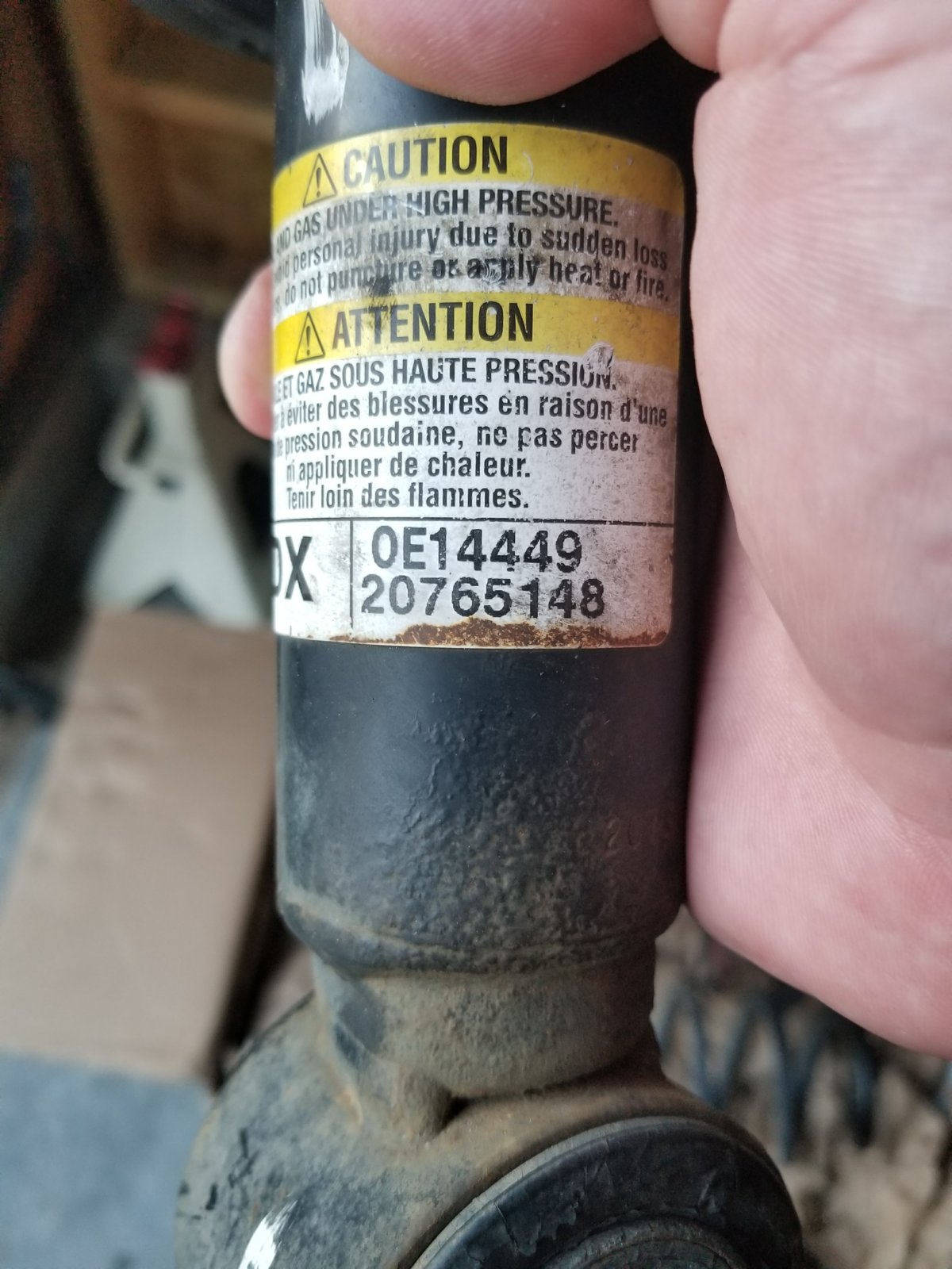

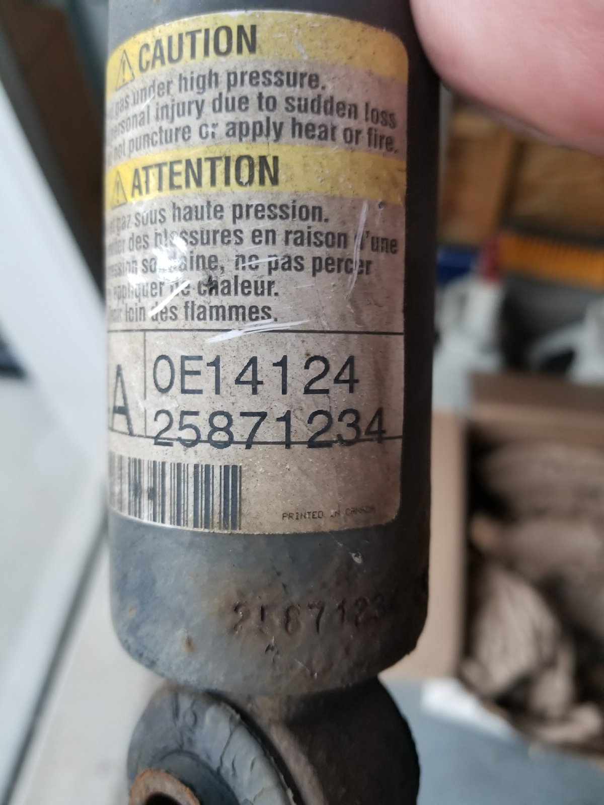

The part numbers have probably been updated since, but these are the part numbers I documented when I replaced all of my suspension when I lowered mine.

thank you. just to clarify, you replaced OEM PPV suspension with something different? and these were the OEM part numbers?
Correct, these were OEM I attached photos of. I replaced all 4 corners with Belltech when my truck was lowered.
To answer your questions about the differences, the spring rates are different on the PPV......as are rebound rates on the shocks. You'll find the shock absorbers fit other vehicles, which was the source for the difference in rates for the PPV application. So the lowered ride height is in the spring difference, which is about a 1" difference from a LS-up Tahoe.
