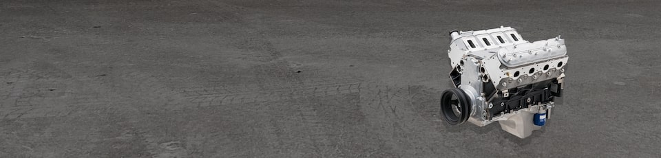

Just heard from the builder they are swapping the stock 6.0L in my 06 Escalade tomorrow! I'll be headed up that way on Tuesday and will post some photos then. This is what we are replacing it with, along with TBSS intake and fuel injectors and Summit Racing shortie headers.
LS364/450​
LS364/450
LS364/450 Tech Specs
  • Part Number: 19370163
  • Engine Type: Performance LQ9 long-block
  • Displacement (cu. in.): 364 cu. in. (6.0L)
  • Bore x Stroke (in.): 4.000 x 3.622 in. (101.6 x 92 mm)
  • Block: Cast iron with 6-bolt block,
    cross-bolted main caps
  • Crankshaft: Nodular iron
  • Connecting Rods: Powdered metal
  • Pistons: Hypereutectic aluminum
  • Camshaft Type (P/N 12565308): LS6 hydraulic roller
  • Valve Lift (in.): 0.550 intake/0.550 exhaust
  • Camshaft Duration (@0.050 in.): 204º intake/218º exhaust
  • Cylinder Heads: LS3 rectangular port; aluminum,
    as-cast with 68cc chambers
  • Valve Size (in.): 2.165 intake (hollow stem)
    1.590 exhaust (solid stem)
  • Compression Ratio: 10.3:1 (nominal)
  • Rocker Arms: Investment cast, roller bearing
    trunnion
  • Rocker Arm Ratio: 1.7:1
  • Recommended Fuel: Premium pump
  • Maximum Recommended rpm: 6800
  • Reluctor Wheel: 24X
  • Balanced: Internal
