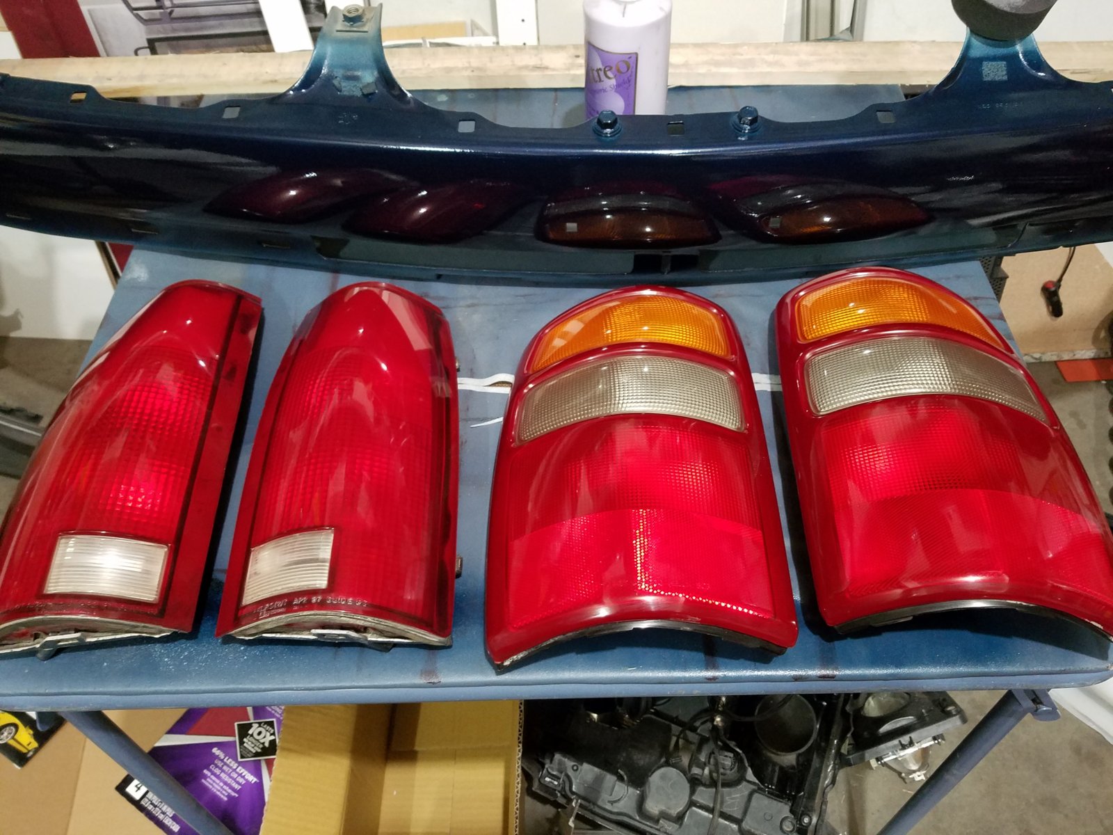

Shoot. The Nissans did look good. LTZs better. Lol
I have a set of matte black LTZs on 20s (5k Miles total) and the Suburban chrome LTZs could find a home too.
Too bad you are soooo far away.
If they nissans were 20s I'd still have them.

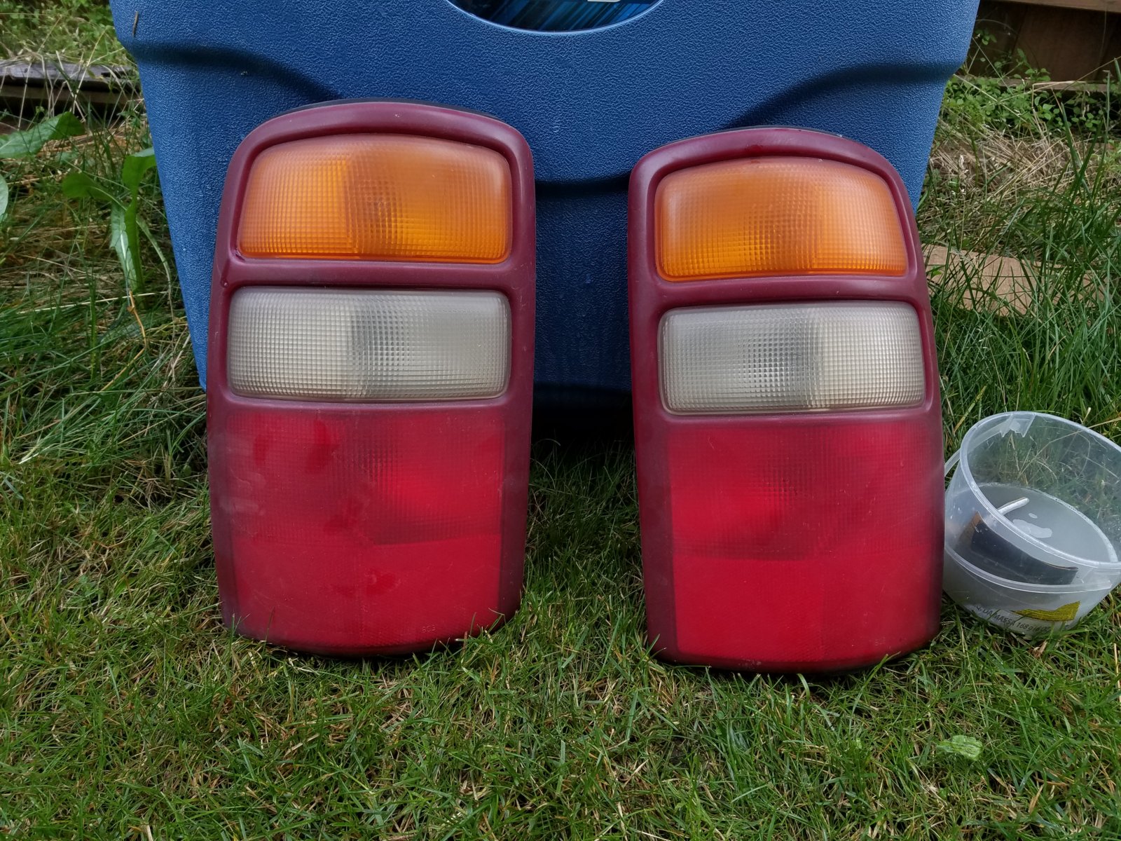

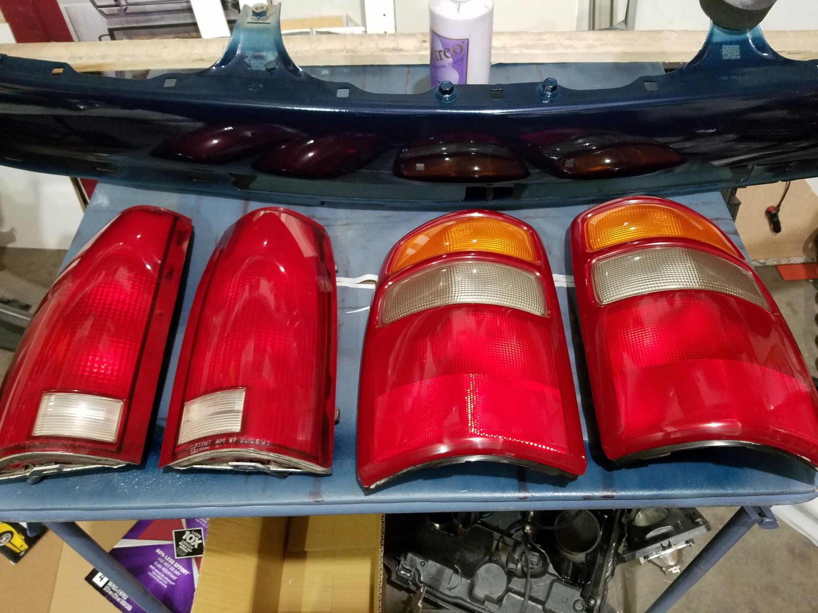

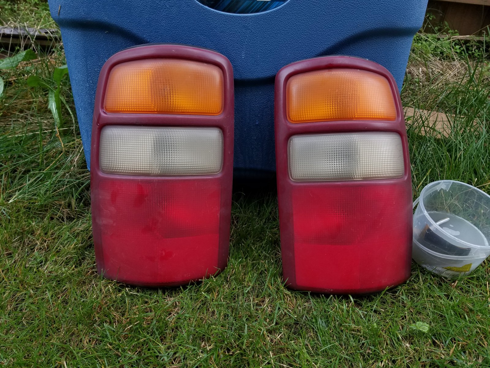

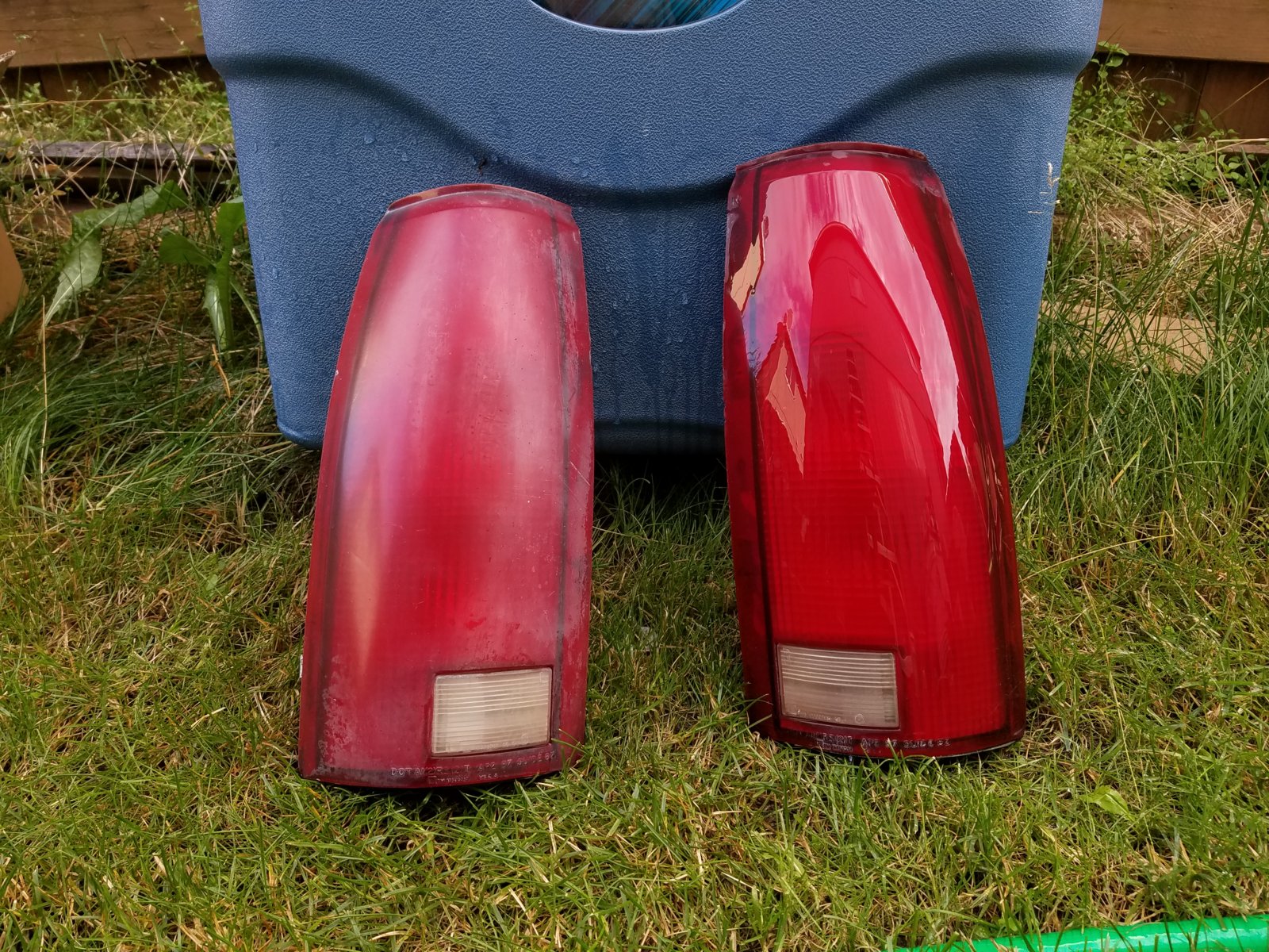

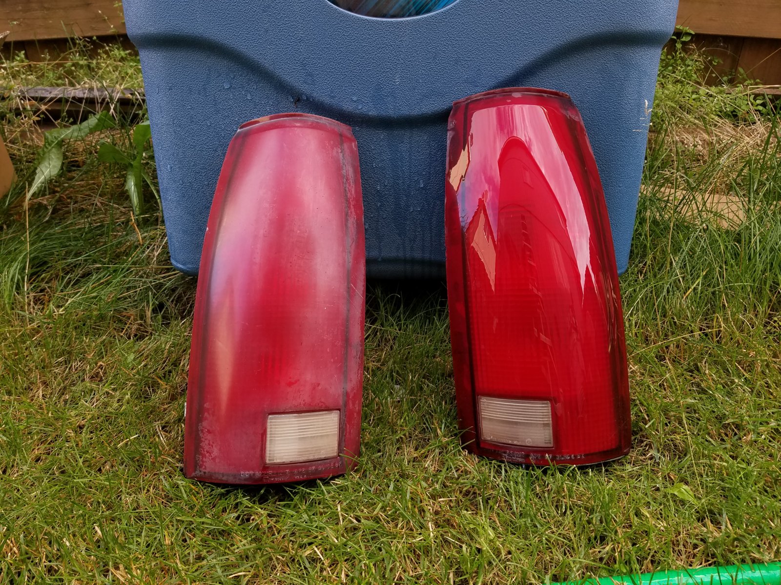

Side project for some friends. Remember, never toss your old tails because they're faded over time. 9 out of 10 times they can be brought back to life with a little wet sand, cut , and polish

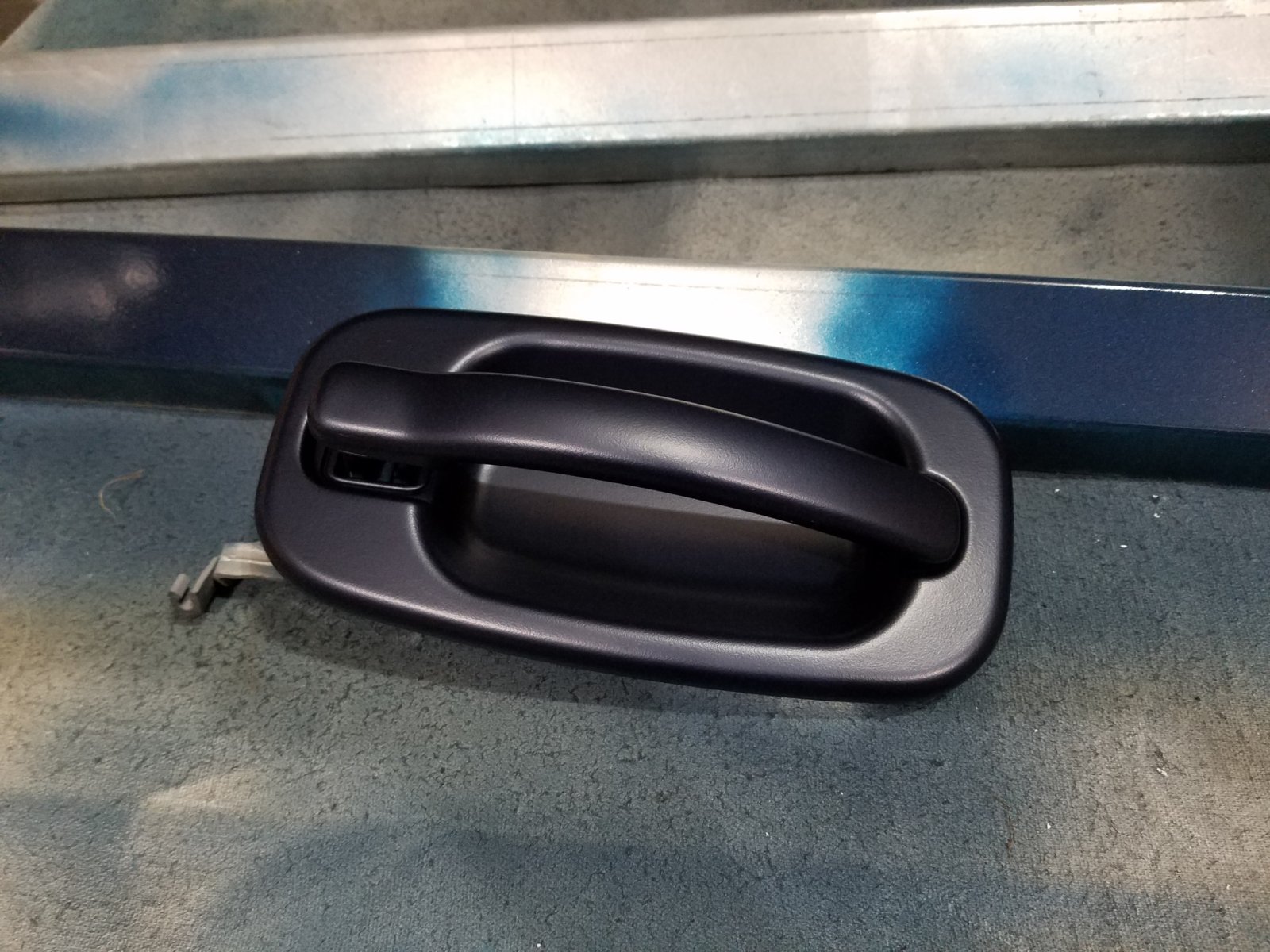

This is where things get interesting. Ive had 2 jobs past 5 months and still do, 70+ hours a week m-f. Not much time to post or do mods, but parts are stacking up and just recently I've had time to catch up. So once I had a couple weekends off I was hustling on the wife's car and the truck.
Painted a rear door handle without a key hole to install in the front door to deter thieves because GM 00-06 gm trucks are being stolen at an insane and alarming rate here in AK. Scheduling remote start and gps alarm here in a couple weeks.
Was silver birch off a Denali. Heres base coat
After 2k clear

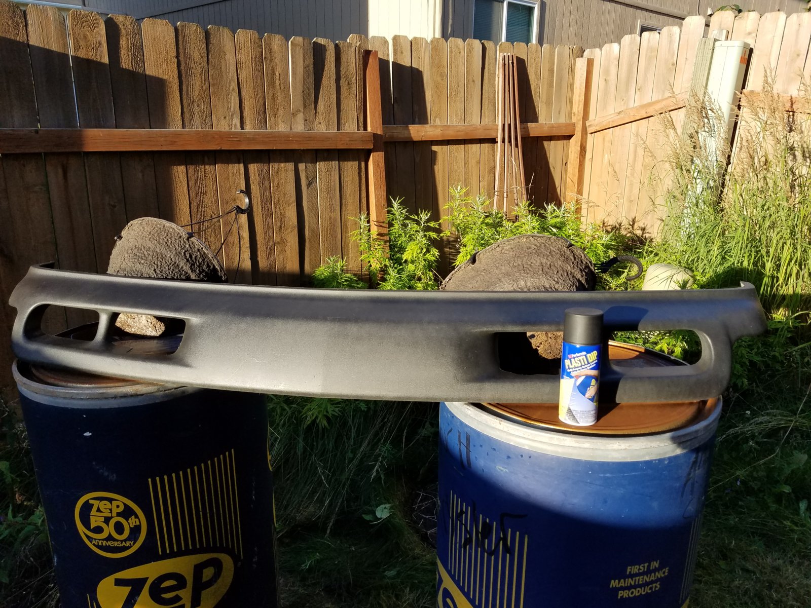

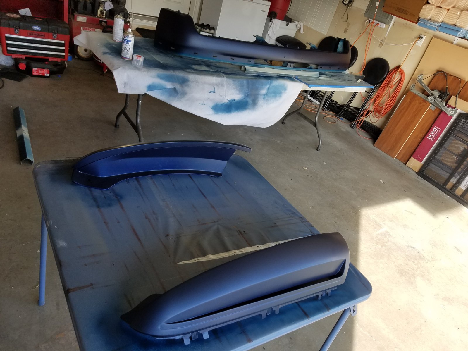

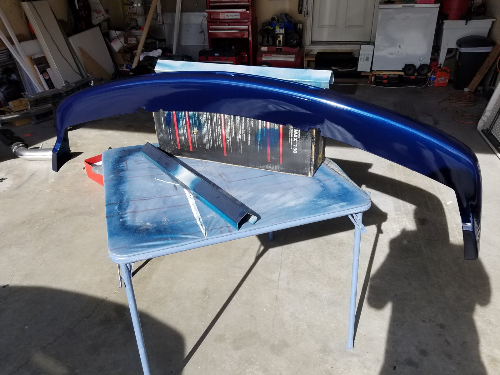

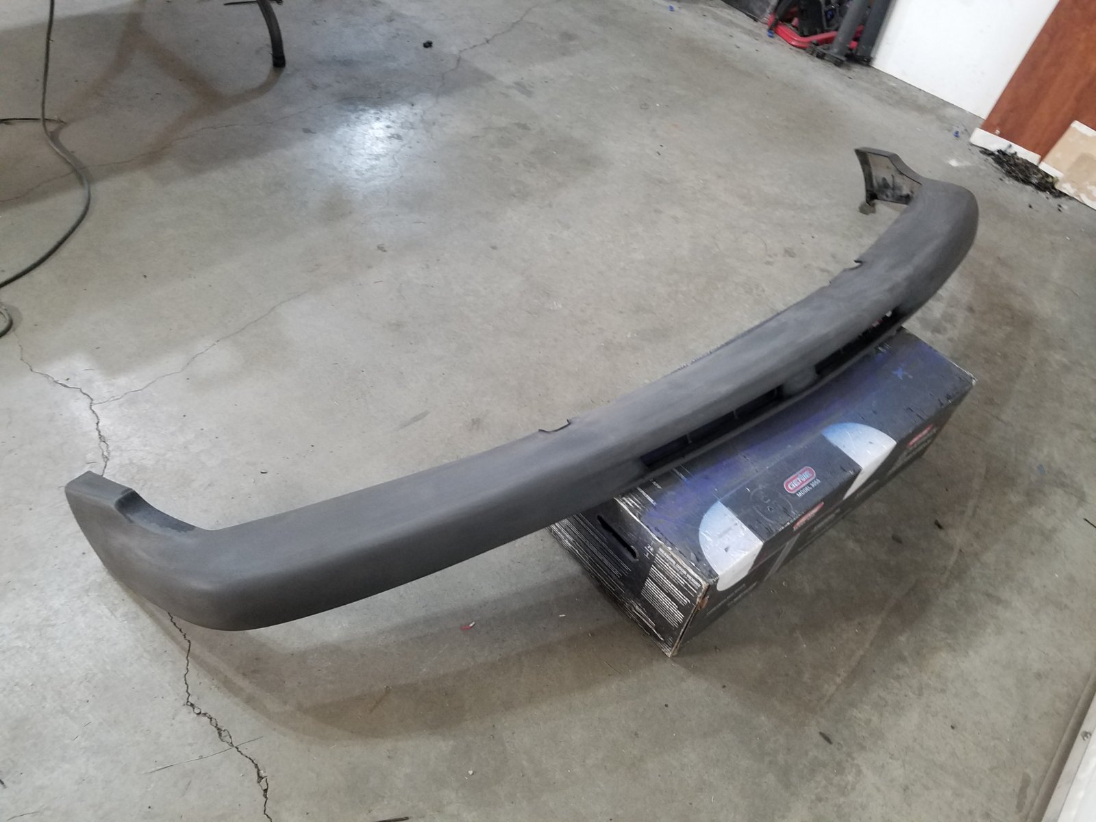

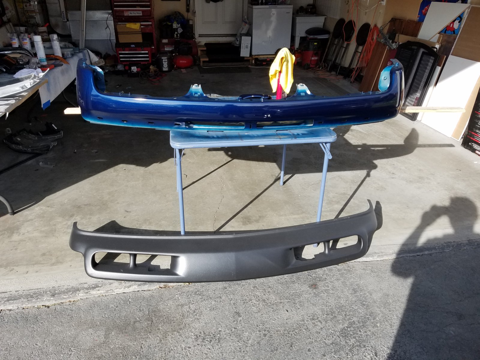

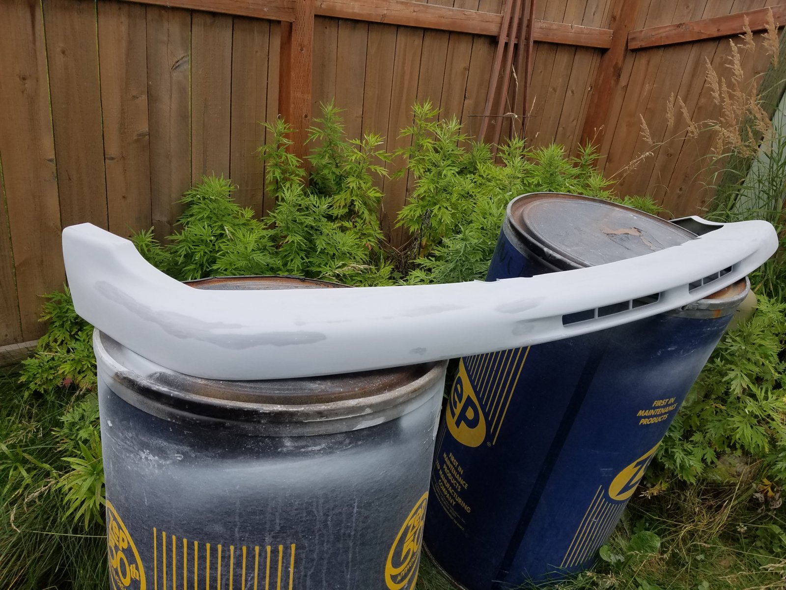

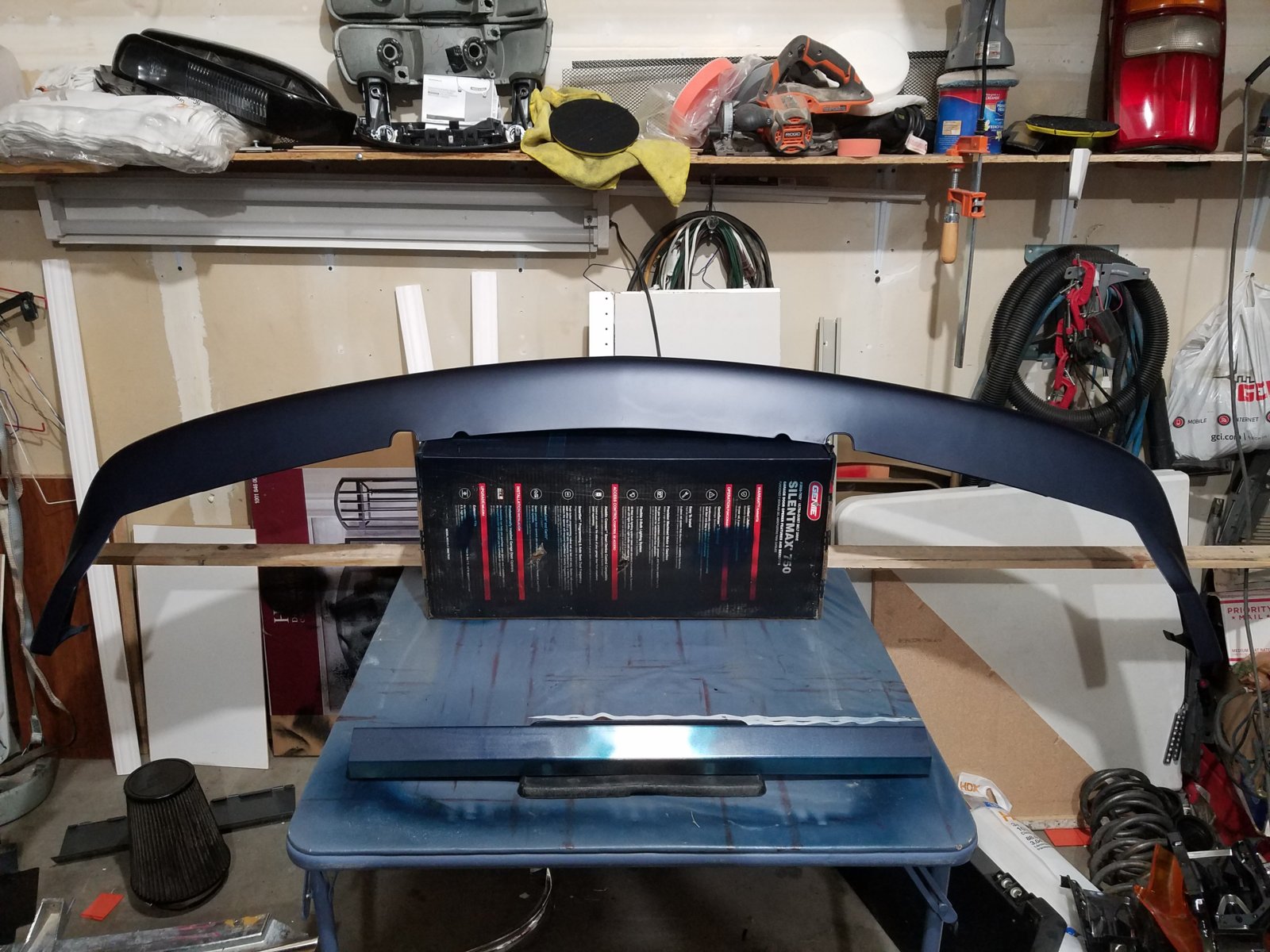

Sold my original valance and got another without the hole in it (check previous posts) they only come in grey so once again I plastidipped ot black for a dark satin look. Matches the 05 lip perfectly.
Took off the bumper pad for painting. That was a biiiiitch getting rid of the texture :emotions122:. Sanding, filler primer, more sanding, more filler primer, more sanding then custom mixed base and of course 2k clear
Garage is a disaster, I dont even care anymore :nolol:

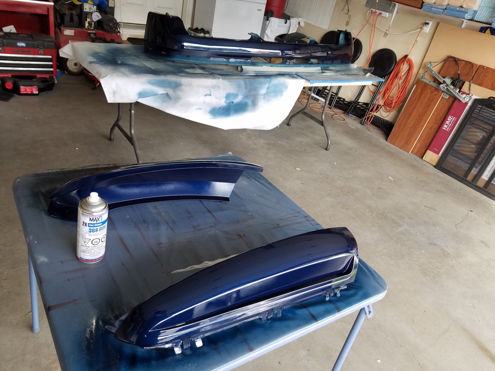

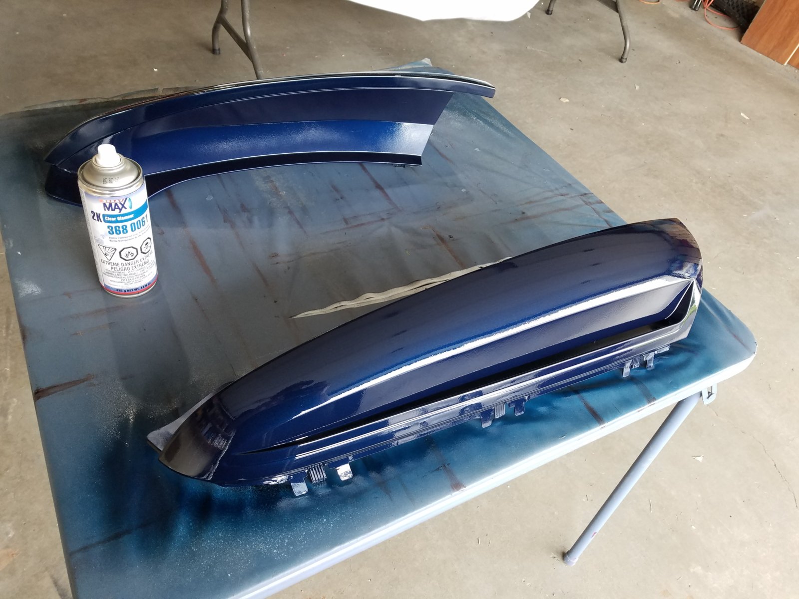

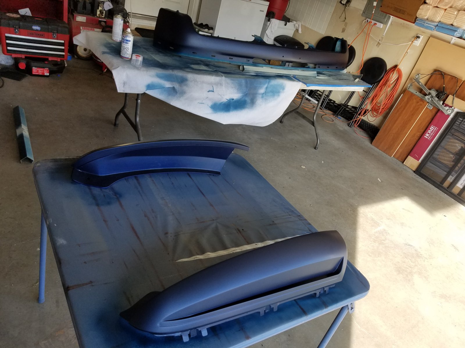

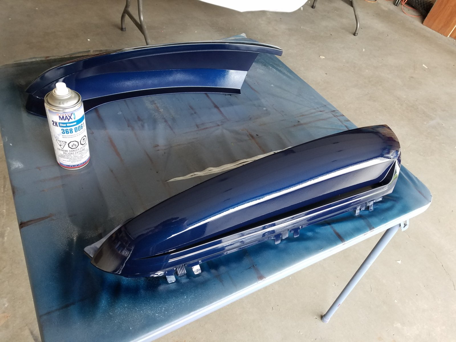

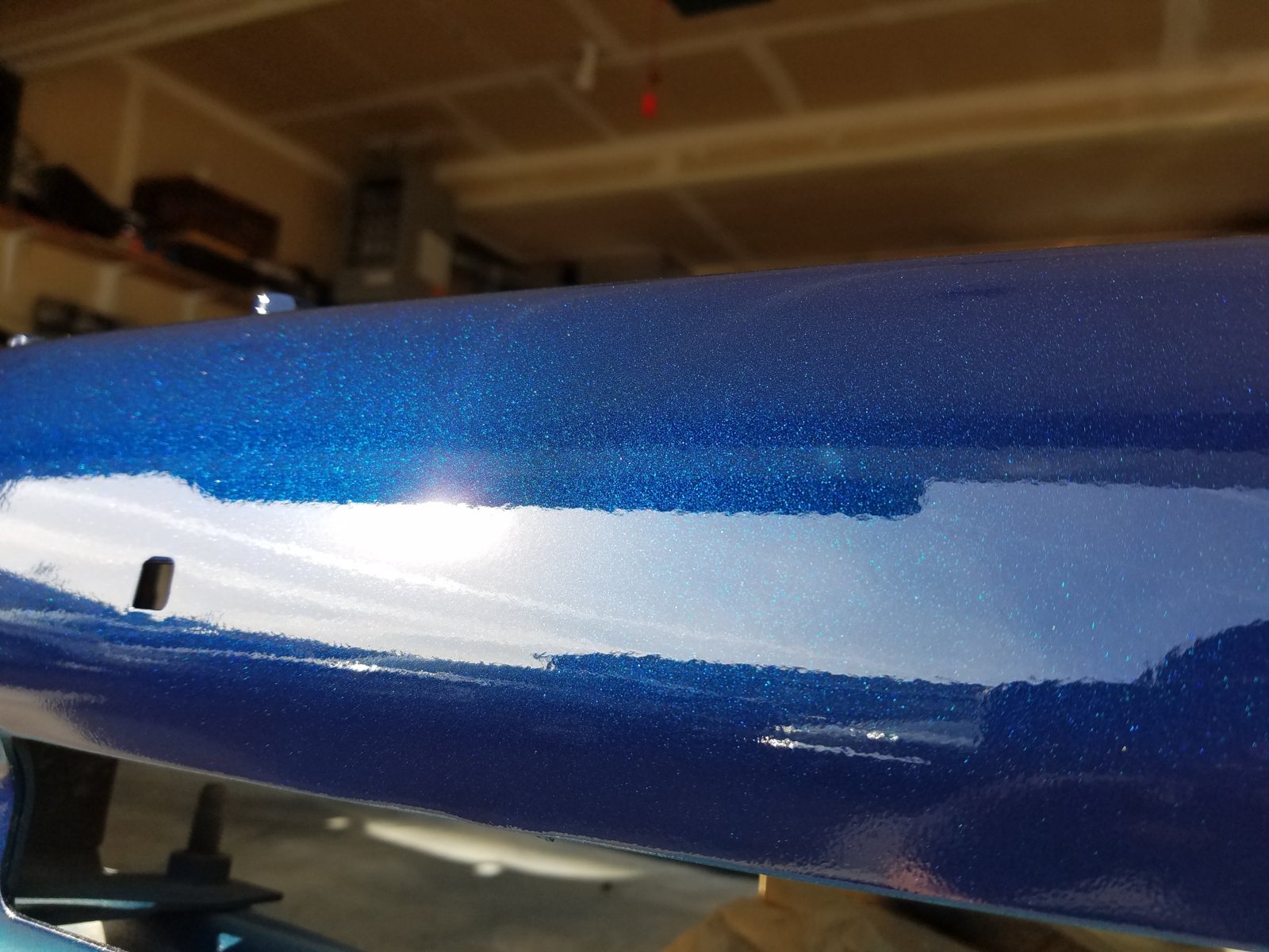

That indigo metallic blue pops like no other. Nobody believes me when I say its oem.
Of course any orange peel will need to be wet sanded after 30 days. Last time I didn't wait 30 days to wet sand my pillars , thats why they were a little messed up.

Hopefully you laid that spraymaxx on when the blue was still wet or tacky. If the base was dry when you put the clear on it will peel right off
I used it on my bike when I painted it and it peeled off cus I let the base dry. But when I did my grill I did my last coat of base. Waited 5 min and when the black was tacky I laid the clear
Also it looks amazing I can't wait to see it all together. You make me want to get paint and redo my bumpers hood and roof
It was a day later as I ran out of time and had to go to my second job:uhoh2: I prefer to spray wet on wet if possible.
Next day I scuffed up the base and sprayed the clear. Hopefully it holds up :boxing:

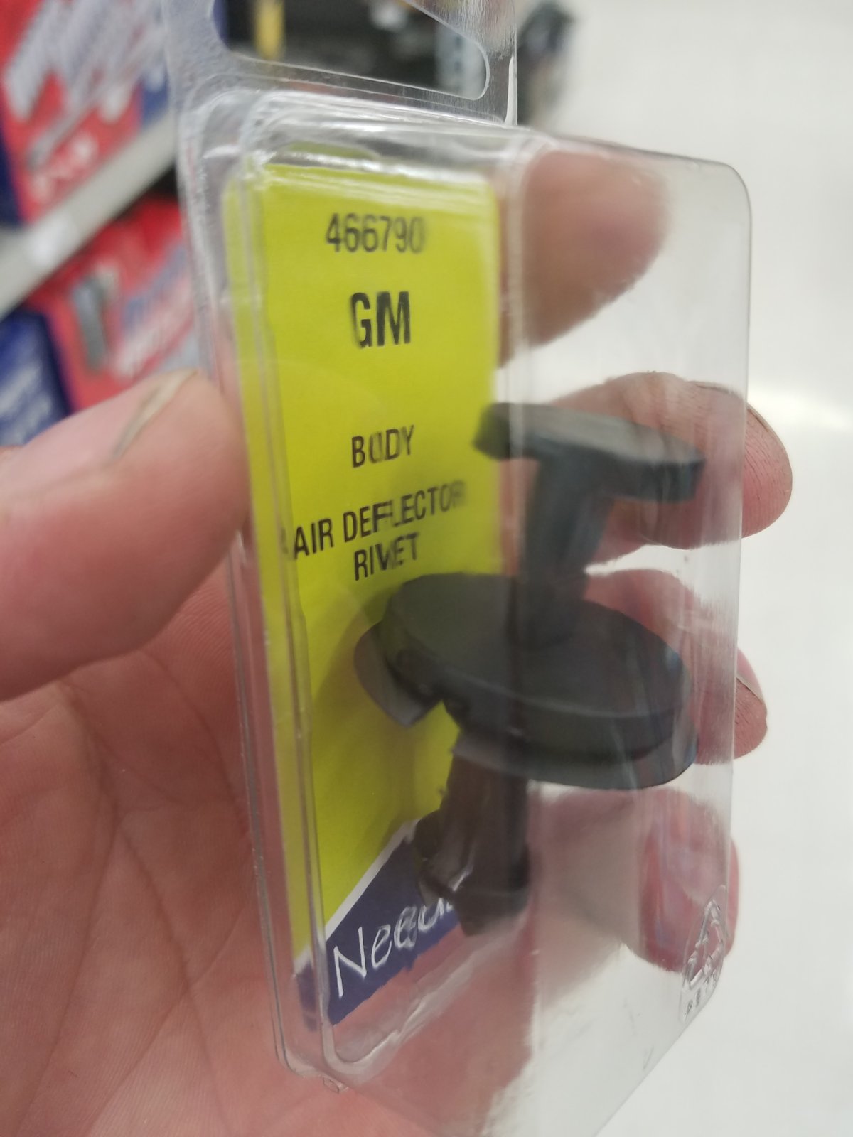

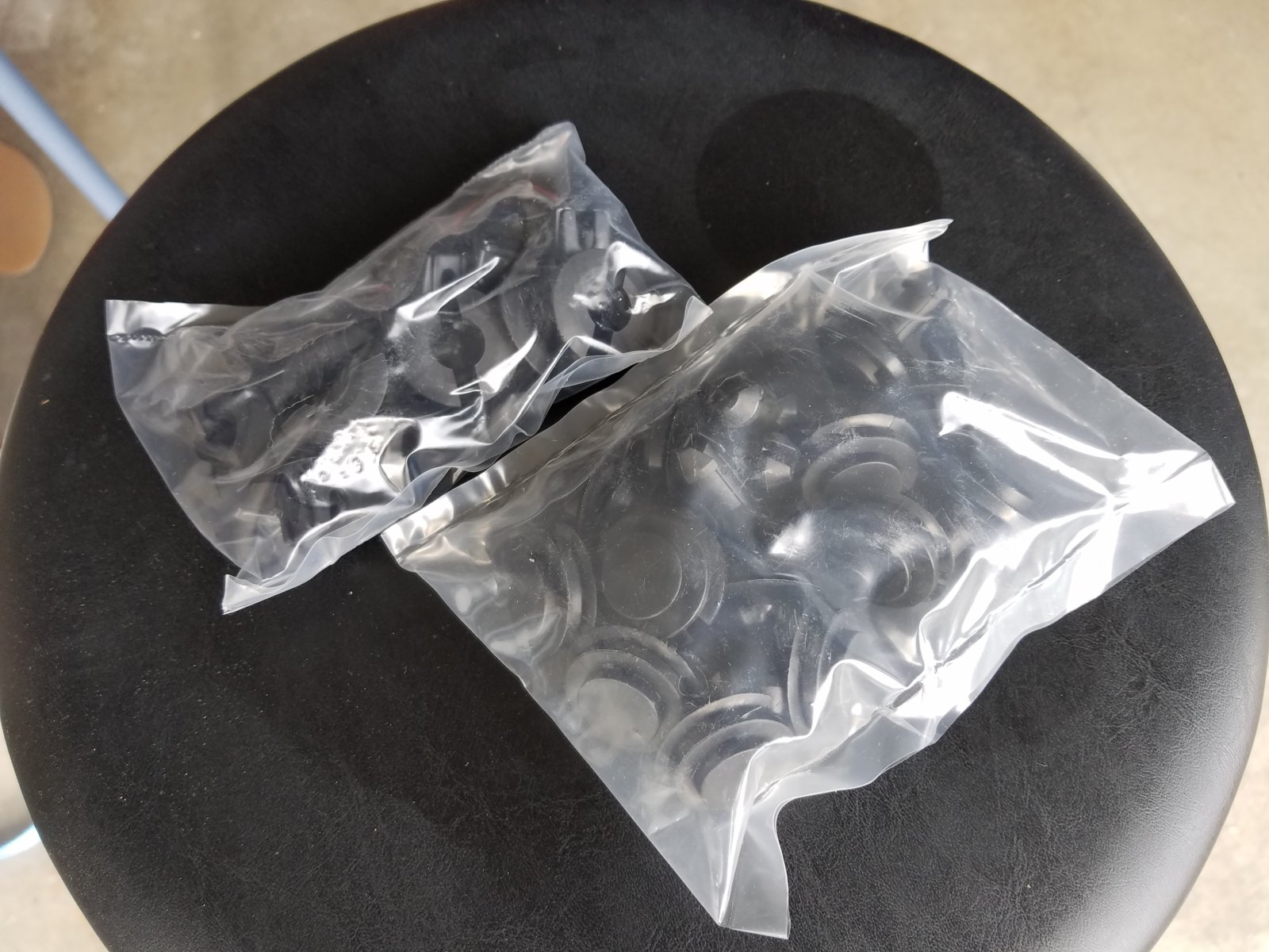

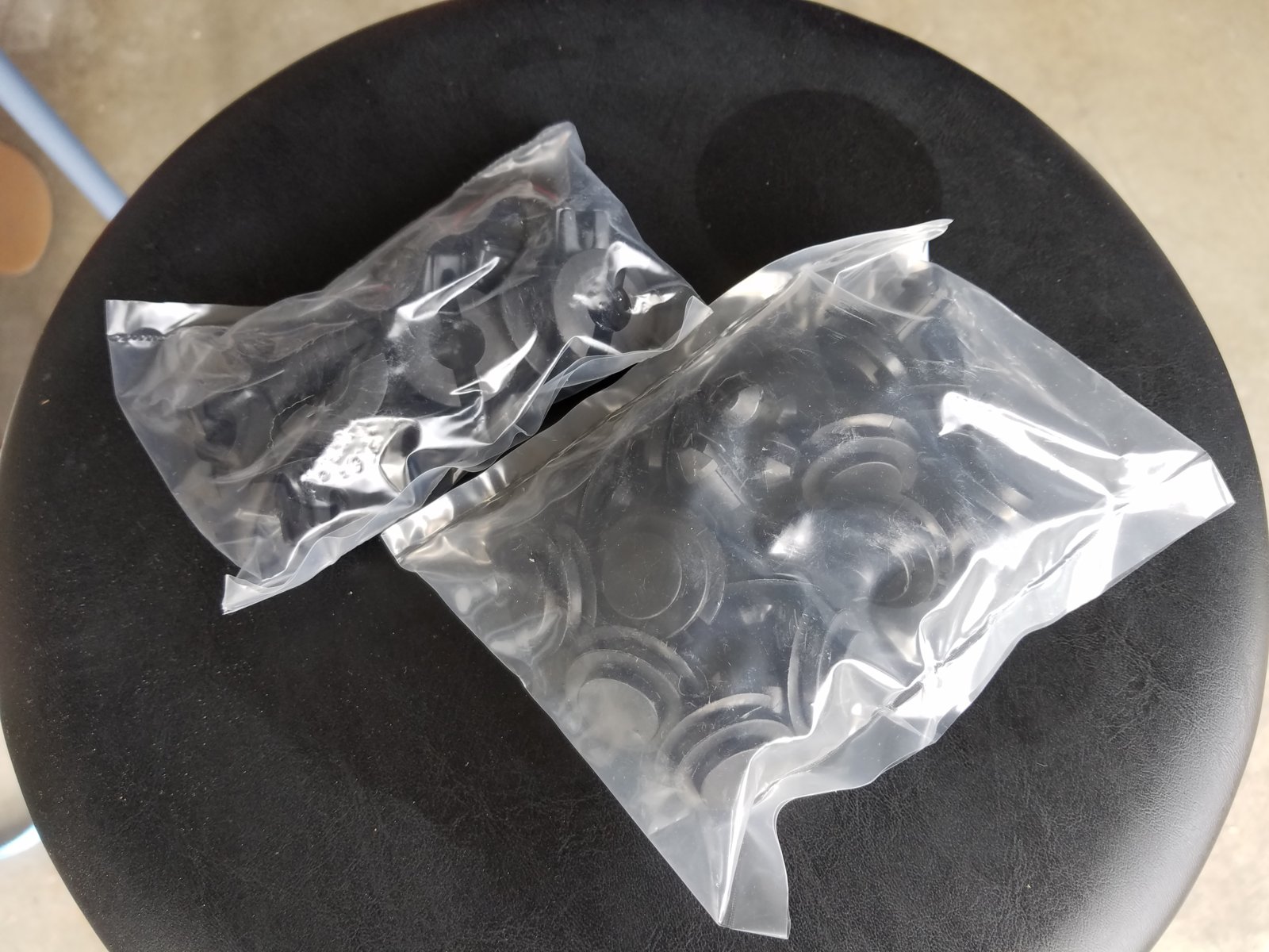

When I took the valance off I broke all but one of the 15 plastic retainer clips. Old and weathered so it was expected. Went to autozone to buy some, found them at $4 a piece. So instead of rushing and spending $60 on clips I found 20 on Ebay for $8, u.s. seller "oem" quality lol. Take about a week to get here.
52,954
View attachment 207592 View attachment 207591
Did you get them from clipsandfasteners.com? That's where I get mine from. Are they the same as the inner fender liner ones?

I want to do my front bumper so bad too. I had a front valance that had no holes, I didn't want/need it, so I trashed it. Oh well.
I meant this hole to the right of the licence plate. PO had a hitch with wiring coming through the valance. I always want the factory holes cut out for fogs.
33,342
51,831
I meant this hole. PO had a hitch and wiring coming through the valance.
I bought a front bumper off a Silverado that had a valance without tow hook or fog light holes, but it did have those "square plates" where they were supposed to be. I would've kept it, but I was still in an apt at the time.
Northstardistributingusa is the seller. But I guess gm used these clips from 99-15 or something crazy like that. And I'm not sure, I've never replaced my inner fender liners yet.

Of you've sprayed anything before your notice its very user friendly, sprays even and lays down nicely. My front bumper and cap will need a wet sand to get rid of the orange peel, not even that noticable. My Denali rear bumper cover and appliques layed down so smoothly they dont even need wet sand.
And I've used the spraymaxx over duplicolor products before with great results.
