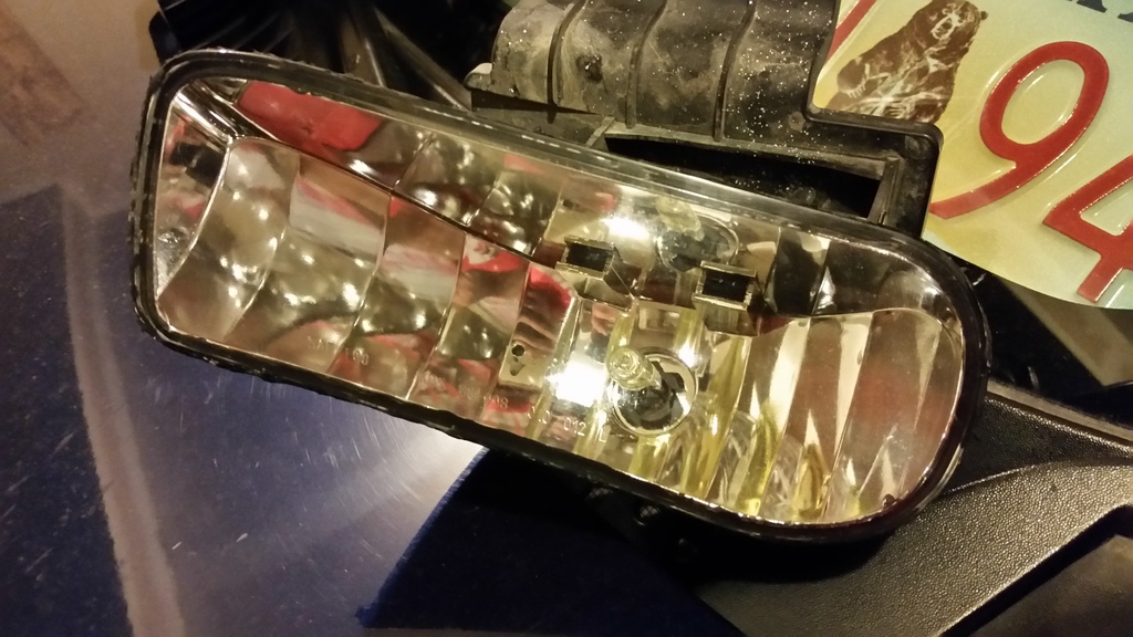

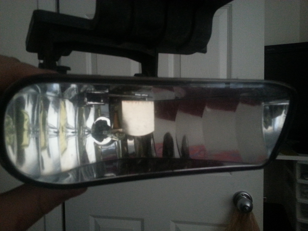

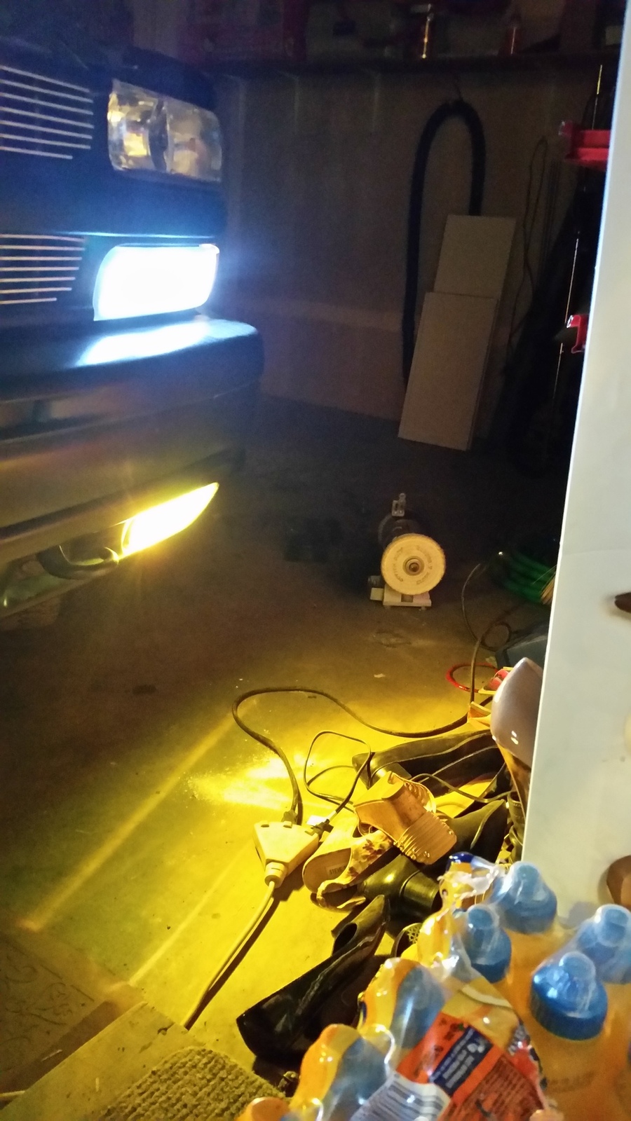

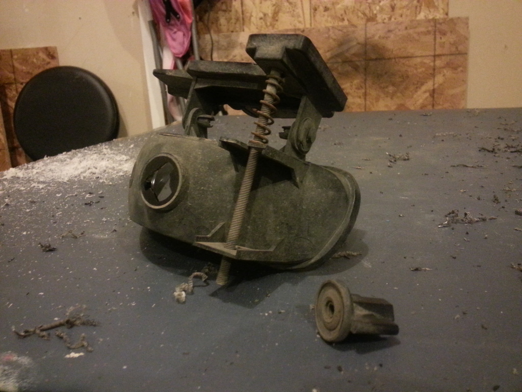

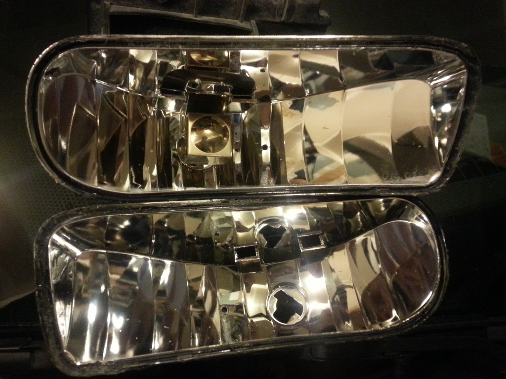

Took the fogs off for some work. Tried to push the chrome shield away from the bulb to let room for longer hids bulbs later on. Also maybe free up some light.
I didn't like it so after I wet sanded the lens i opened them up using a heat gun and two flat heads and patients and removed the shield completely. Huge difference in light output.
Cleaned the chrome reflector bowl. It gets hazy and foggy after years of halogen bulb use and heat. Again big difference.

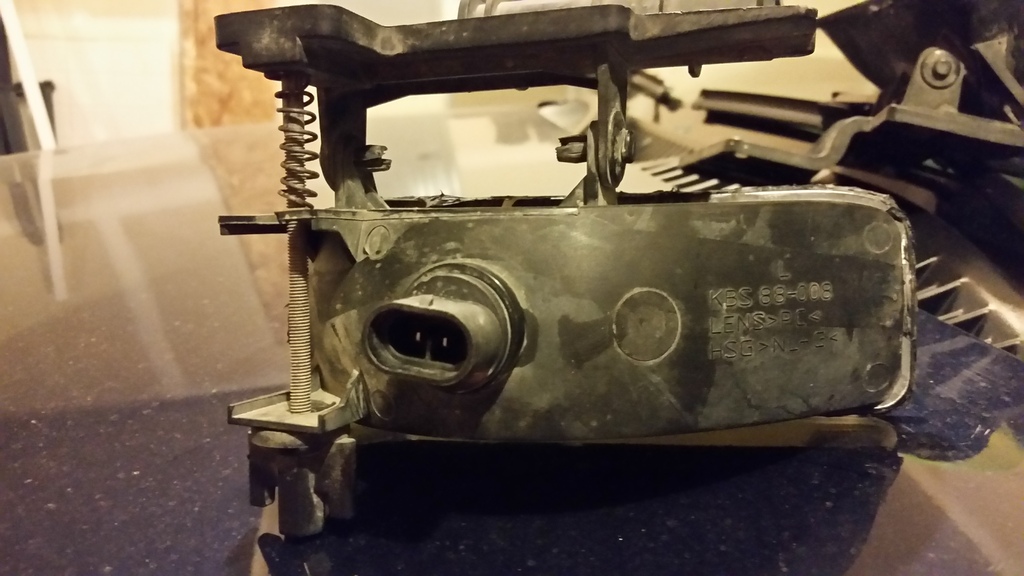

Remove the adjustment hardware. The adjuster nob unscrews all the way and releasing the spring and leveling rod. These springs get old and worn causing the housing to vibrate. Take the spring and stretch it out. Then install them back in for a snug fit and a lot less vibration from driving.
While I had the lens off I made a cover from a 12"x12" piece of acrylic from home depot. Traced the fog light lens and cut a left and right piece. Then applied a neon yellow film. And threw in some yellow coated bulbs for time being. Used a couple pieces of heavy duty velcro tape for removal and cleaning. If the film starts peeling or chipping I can take off the cover and apply a new film instead of applying it to the actual light on the truck. *lazy man's cover lol* (this is all temporary till a later set up. But was fun to do and works great)
Pretty nice deep 3000k color.
Against 6000k hids.^^^

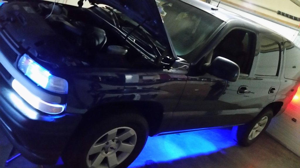

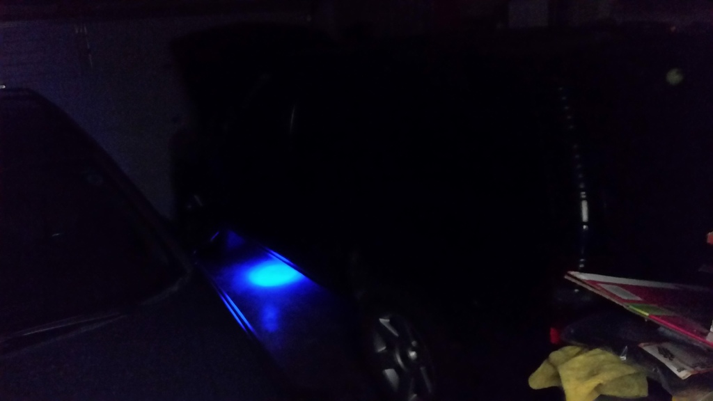

So for now till I get a real kit I'll have this, not finished yet but it's the idea I'm going for. Later I'll buy a legit kit with multi color function with a more uniformed glow look. Yea I know kits are cheap but at $12 for 10 of these eagle eyes that's not bad for a diy homemade led kit. 2 or 4 on each side and 2 in front and 2 in rear.
As you can tell they're spot projectors style leds. So I'm trying to figure out a bracket to angle them and create a flood light that glows on the ground. But this gives an idea and visual, some of you might like this look too, I've thought about it, especially in white. But look how bright these bitches are even in the light
With parking lights on
With the mirror puddle lights retrofitted with white eagle eyes

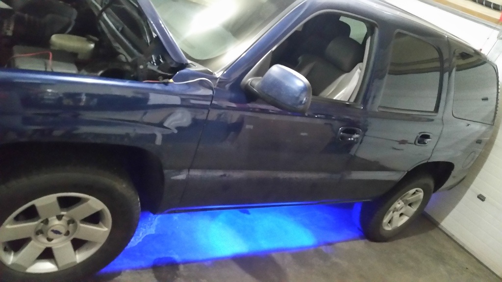

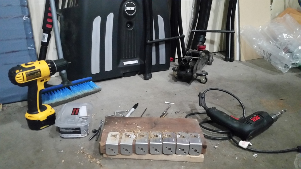

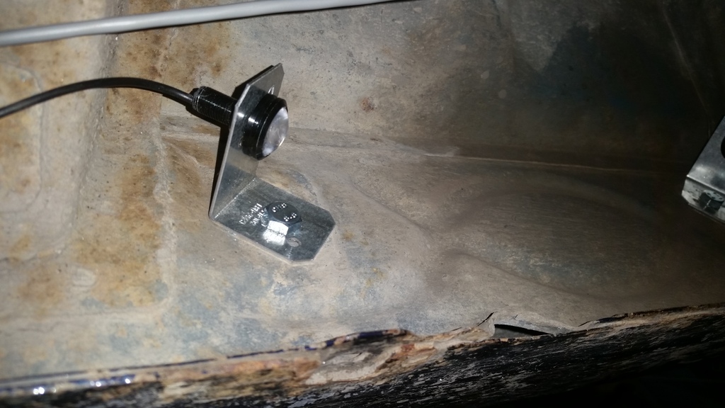

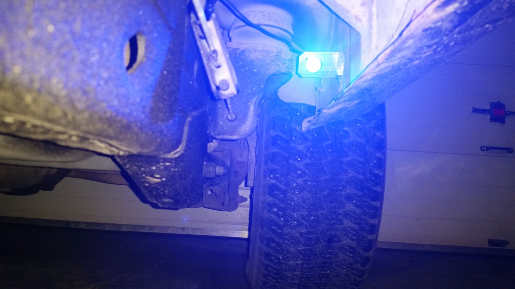

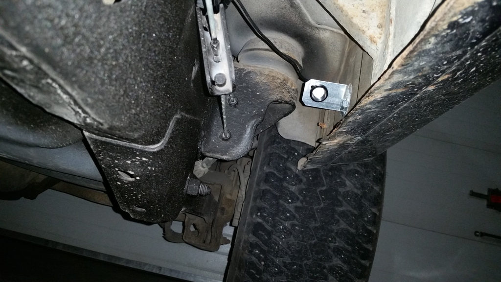

Used these L brackets from home depot for mounts x8. Don't have to be pretty as they are hidden under the body. Already had wire and connectors. Bolts were 0.50€ a piece x8.
Drilled out
Wire it up, how you want. Make sure it's not hanging so it doesn't catch on anything like twigs, rocks, snow, cats, clowns, exc....

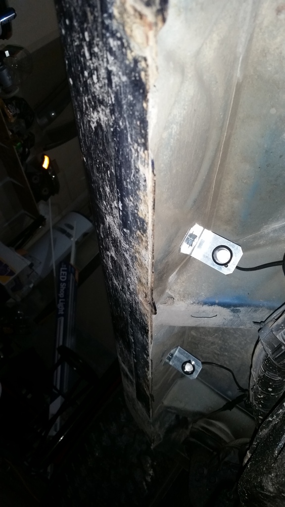

Can loosen and tighten and angle these straight down or up or at an angle like I did. You can also bolt them up to the rocker panel where holes are already existing for steps. But I wanted these tucked up higher
Taking care of that rust while I'm down here. Primer then spray can bed liner.
Anyway I'm at about $20 for everything.
05Single
05Single
afraid of the dark
Feb 26, 2015
8,244
11,648

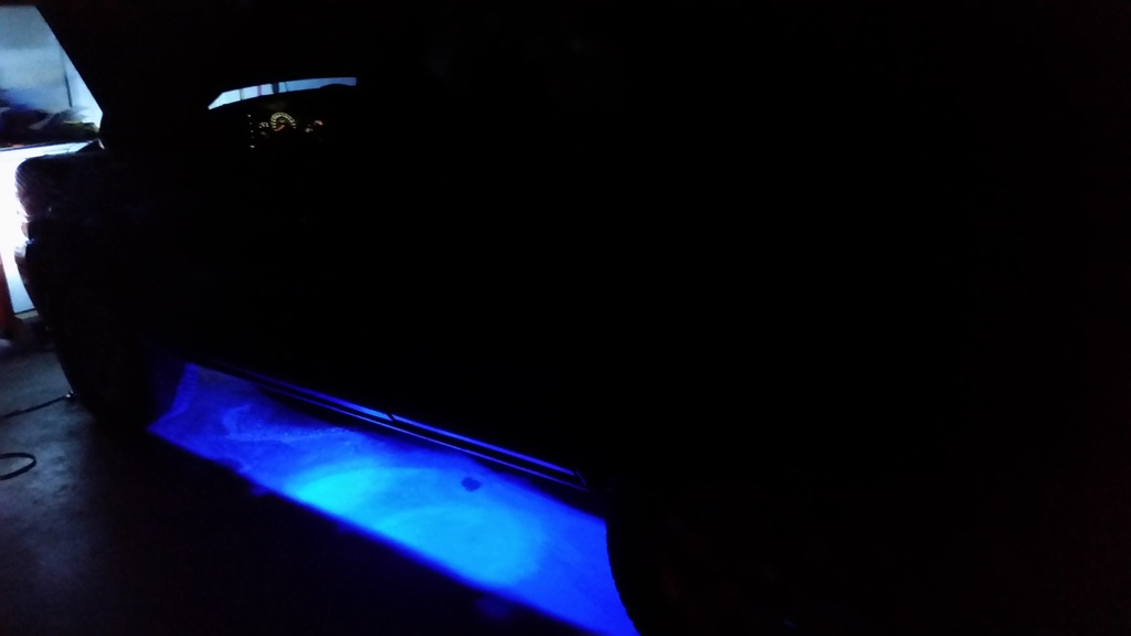

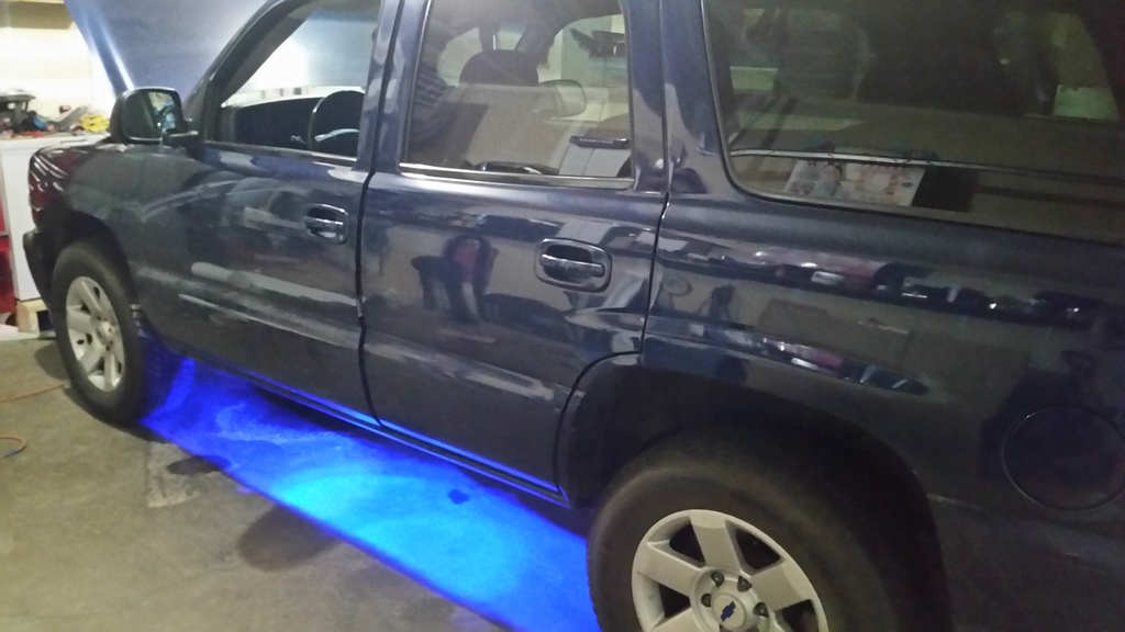

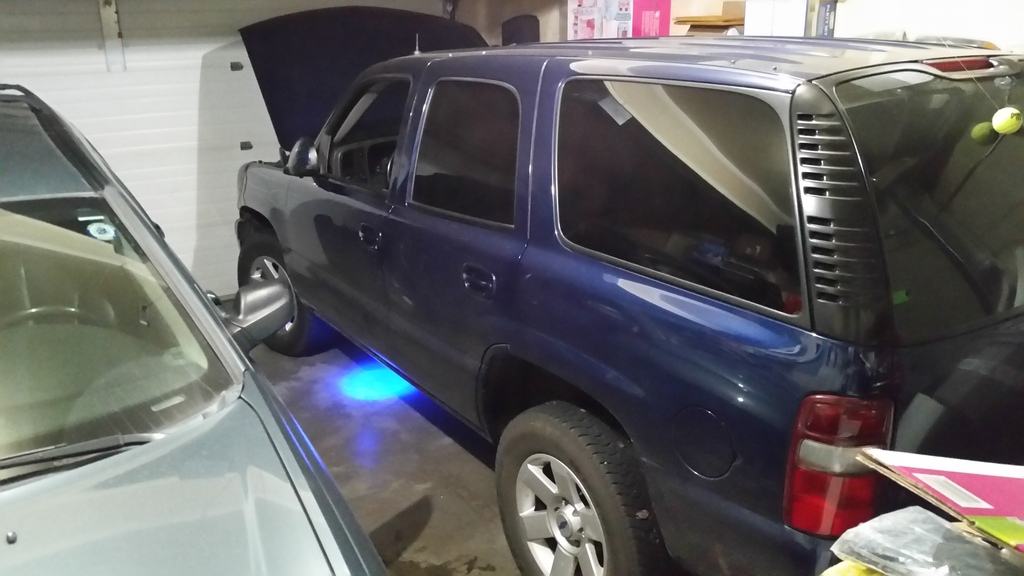

Since I put them up high above the rocker panel gives it a nice cutoff.
Way brighter than I expected or wanted but I'll roll with it. Later I might face them up to see how much glow I get. Was gonna do the front and back but I think this is more than enough glow for me lol
