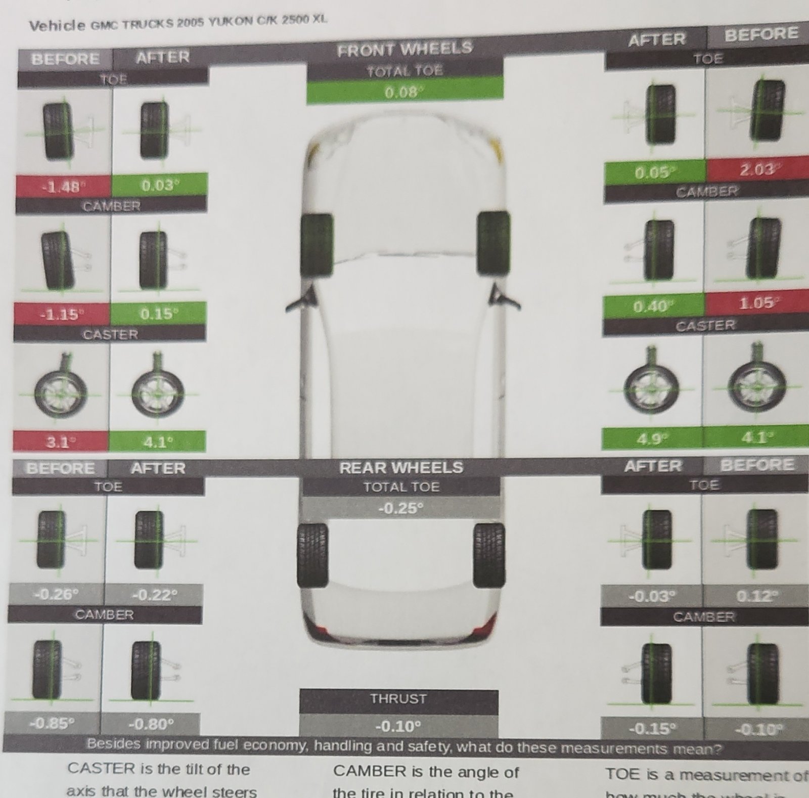

Got all 4, A arms... upper/lower ball joints, and both tie rods ( they needed replacing)......
They cleaned the heck out of everything...... I go back in a few hundred miles for a re-torque.....
They re-wrapped wiring, as needed, with my Summit Racing - wire-loom, while they were digging around there....

You should have a better riding front end now, and you're good there for the next 100k miles.
