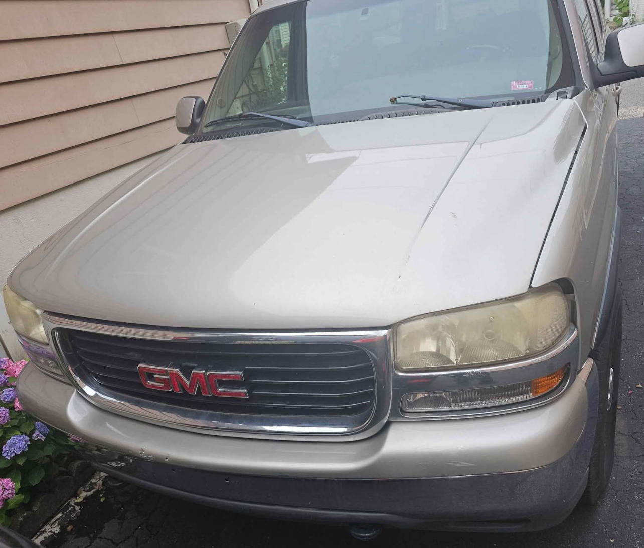

would this 05 yukon hood fit on my 04 tahoe LT? its the correct color code in good condition but not sure if it will line up correctly, look right or even bolt up right. anyone know for sure?

Bolt up and fit? Yes, most definitely.
Color? No telling... you'd be the right pets for making that call?
Aw the RPO codes the same for the color? There's some BC/CC codes on the glovebox...

yea the owner confirmed its the same color code "silver birch" im just not sure if its gonna look off. the tahoe hood looks like a straight edge line, this seems to have some curves near the headlights?

If you're concerned of the color, ensure the same BC/CC color codes on the RPO sticker in both glove boxes match, as @strutaeng mentioned. GM has variations in the color "name", which vary by year and or model. I'll take a closer look at the hood intersection with the lights on my hoe tomorrow to see how straight it is. You may be right about the slight curve... maybe a slight overhang, as long as no interference(?).
