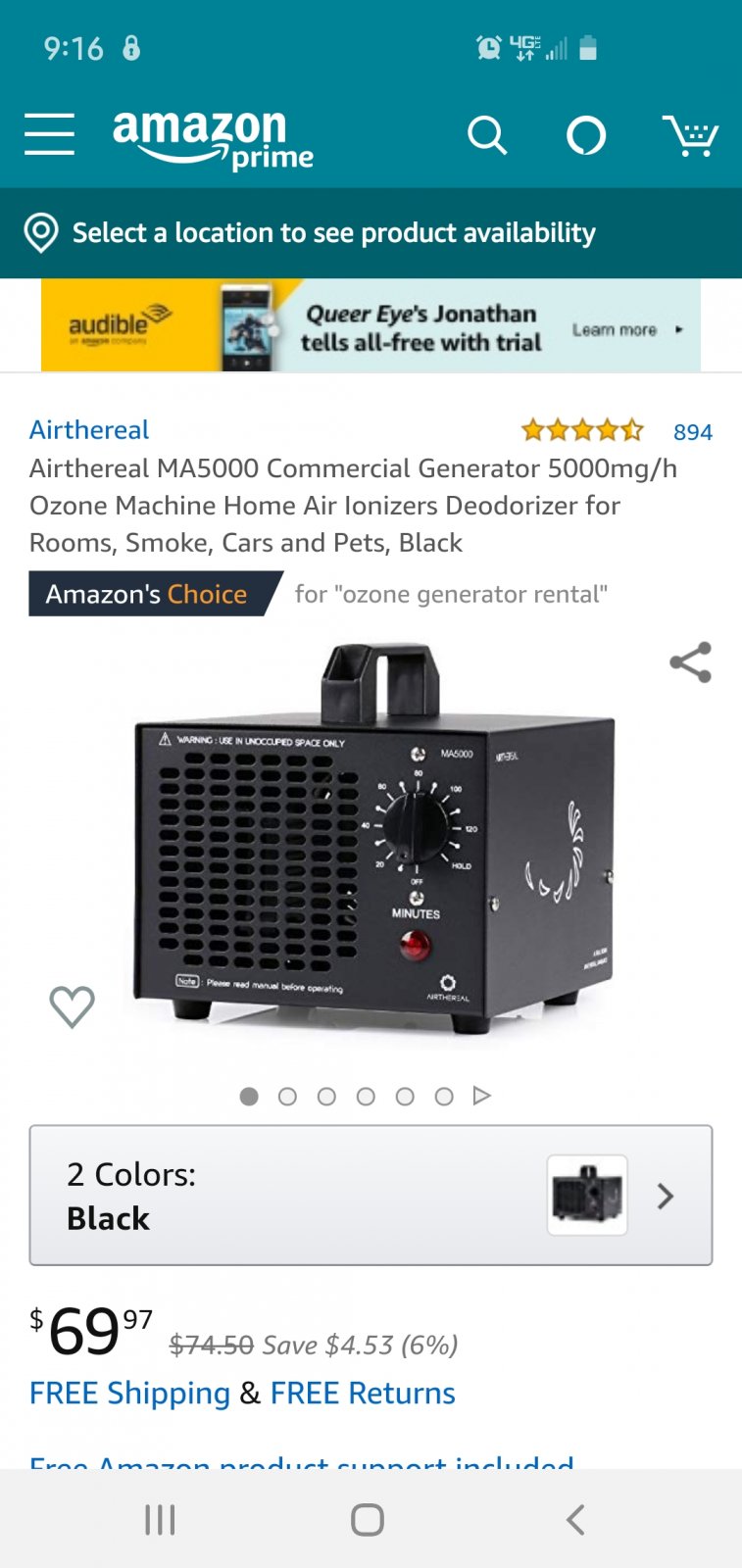

Ozone generator. Something like this.

Great. I actually had the dealer run this for 30 minutes the day before I got the car. It didn't seem to do much, but now that I have completely steamed/wiped down every surface, and isolated the smell to the area of the center console, I presume that if I ran the machine with the console open it would help. The smell really seems to be coming from there. I'll buy one of the machines and do it myself.

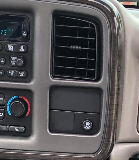

If anyone knows what I need to do to remove this vent here so I can clean it out, I'd love to hear how. I removed the five 7mm sockets but don't know how to pop up the dash so I can get it out. Maybe it's the screws on both sides of the car seen here?
30,578
48,070
If anyone knows what I need to do to remove this vent here so I can clean it out, I'd love to hear how. I removed the five 7mm sockets but don't know how to pop up the dash so I can get it out. Thanks.
That whole trim piece around the cluster and hvac/radio comes off, just put the shifter down to 1st gear, tilt the steering wheel down and just grab the lip edge of the trim piece and pull towards you it just has clips comes off by hand easy, then you can get vent out it just pops off or it may have one screw.
Thanks. I got that main trim piece off no problem, however, there's another 7mm bolt that is hidden behind the main piece of the dash which is holding the vent in. I think maybe I need to pop that up slightly, by removing the screws on the left and right of the car? These ones? And then pull up the entire dash cover to access the bolt that is holding the air vent in?

This is a photo of what I think I need to do to access the vent. Pop this whole dash cover up.
