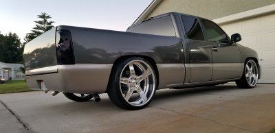

ok another question for the chevy guys. question from a good friend of mine.
he has a 2004 stepside Silverado and wants new factory taillights. some places he looks say 99-03 and hes having trouble finding 04 ones but the 99-03 looks right. however if he looks at the aftermarket "fancy" ones there is a different part number for 03 taillights and 04 taillights. can anyone give me some info on this will the 03 fit or what would i have to do to make it fit for him?
