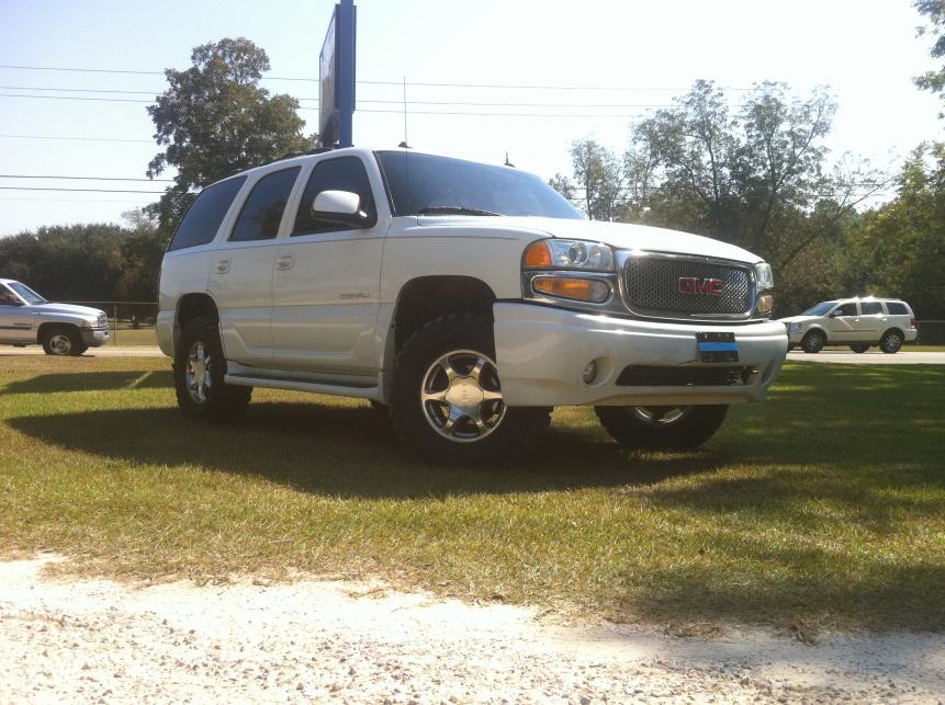

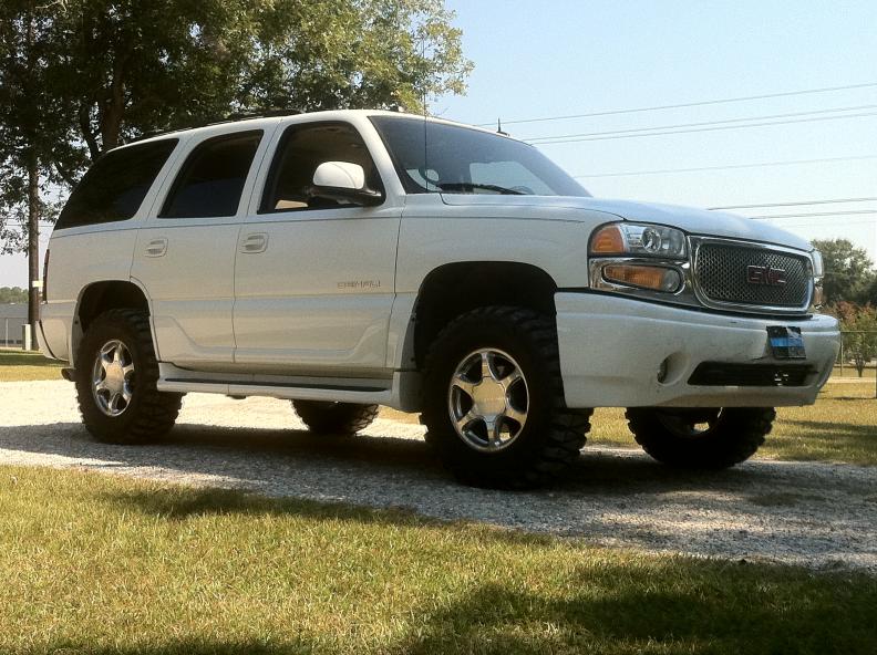

Just got them on last week, minor rubbing but nothing that bothers me.

Front end rubs when at full lock against the A arm at the top just barely. The rear rubs the plastic where the upper shock mount is (well it did before it ripped a small chunk out) which seemed to fix its own problem. So i cut the other side out. And i get minor rubbing going down my dirt road when rear axle flexes. I am getting some wheel adapters when i can find the ones i want to get the tire away from the inside wall. The tire is 33/12.50R17 which according to nitto is 32.97 tall and 12.68" wide. I think you would be fine with a 33 that is not nobby on the side wall like the grappler. Im thinking the addition of 1.25" spacers in the rear and 1.5" in the front will completely take care of any problems.. Also with the denali i did away with the air ride and put spacers with my rear end sits at 38" from what i have read for people with spacers thats stock.
---------- Post added at 05:45 PM ---------- Previous post was at 05:43 PM ----------
In the upclose picture of the rear you can see where the plastic is cut out near the upper shock mount.
