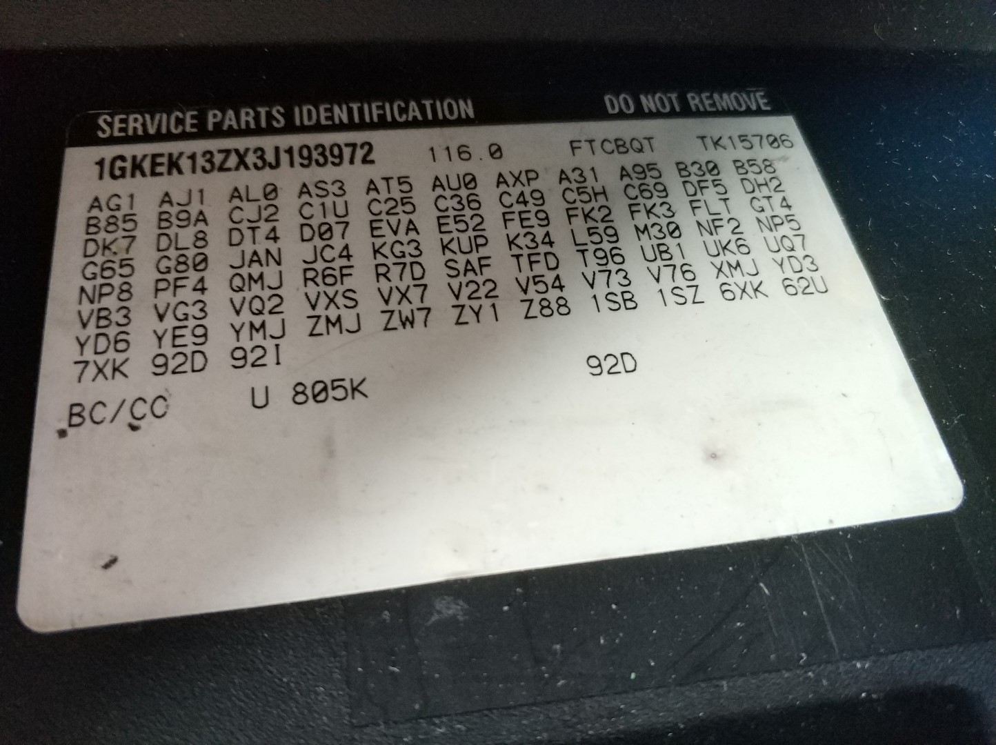

Hi All
I've just realized, there's only one heated mirror in my yukon. On the passenger's side.
Is this my version, or maybe someone (previous owner) has changed this driver's side mirror to non-heated one?
I'd like to have this mirror on the driver's side also heated :) Can I just buy such?
VIN: 1GKEK13ZX3J193972
And all the codes on the image below.
Thank you.

Truck has DL8 option which is "Power, Heated".
When you replace them with new factory mirror glasses, they come without the heater symbol.
Best way to check is either removing the glass or adjusting the glass to check if there is a small pigtail connected to the glass.
They might have just replaced it with a non-heated glass, or may have the new updated glass installed.

It's an 03....I smell a DL3 installation..... that power folding is pretty nice!
