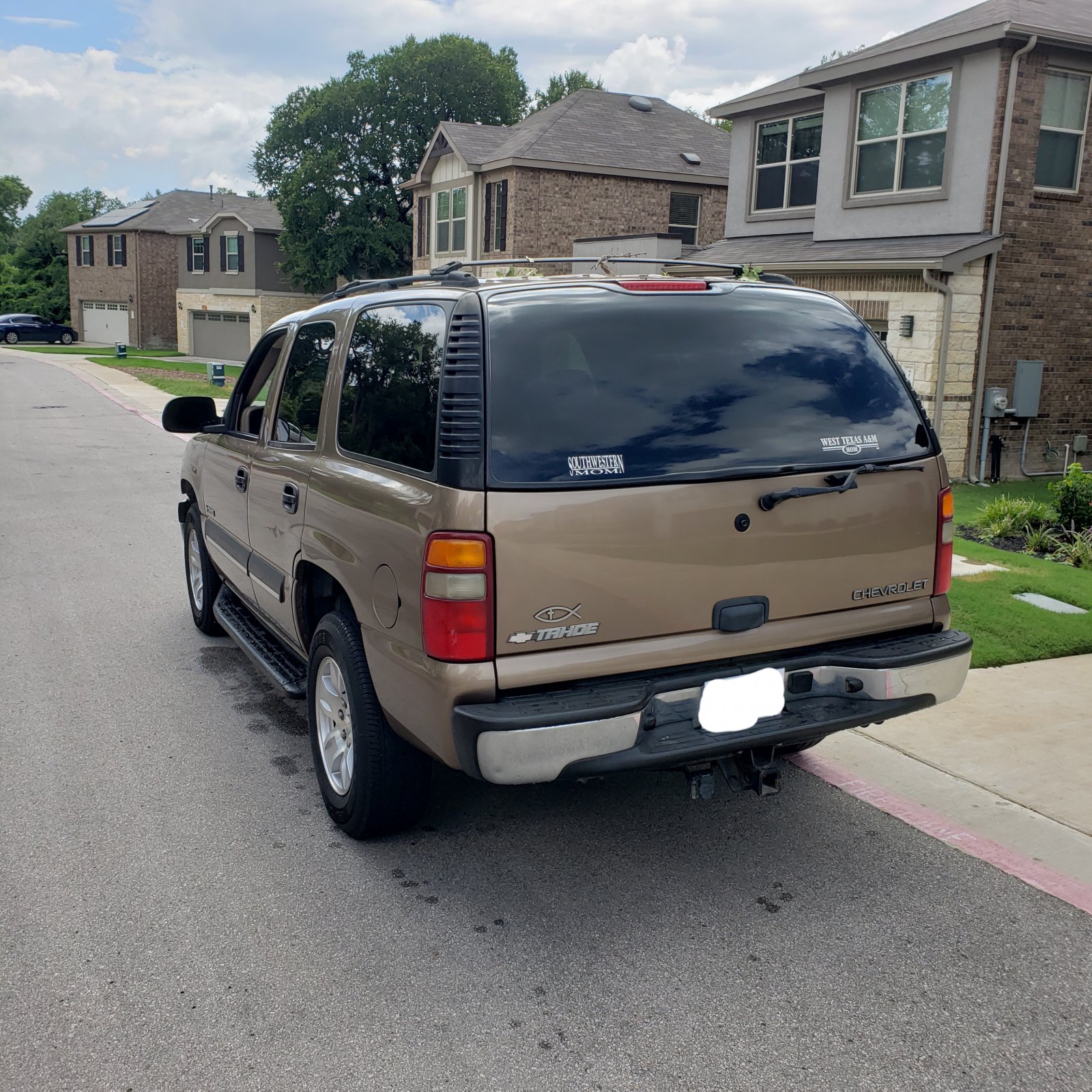

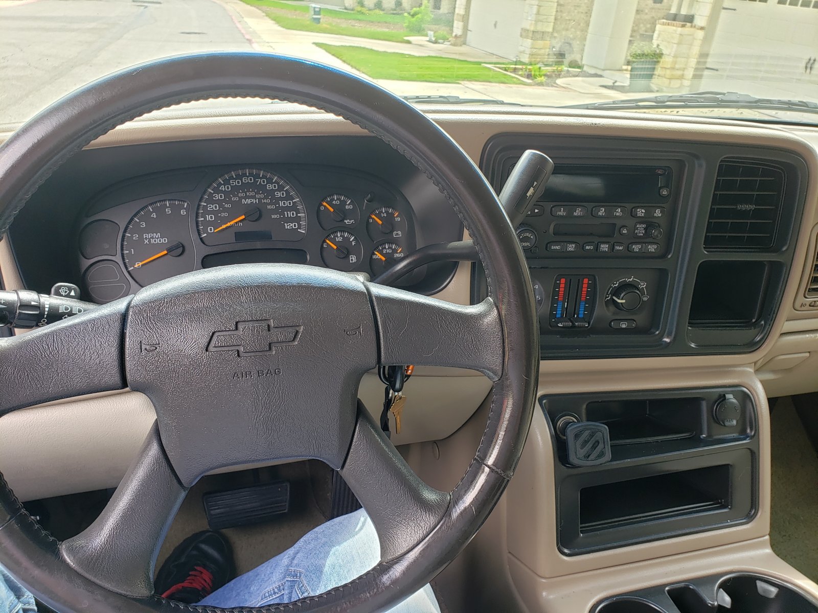

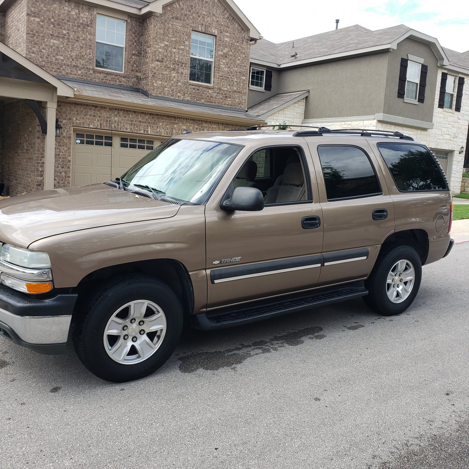

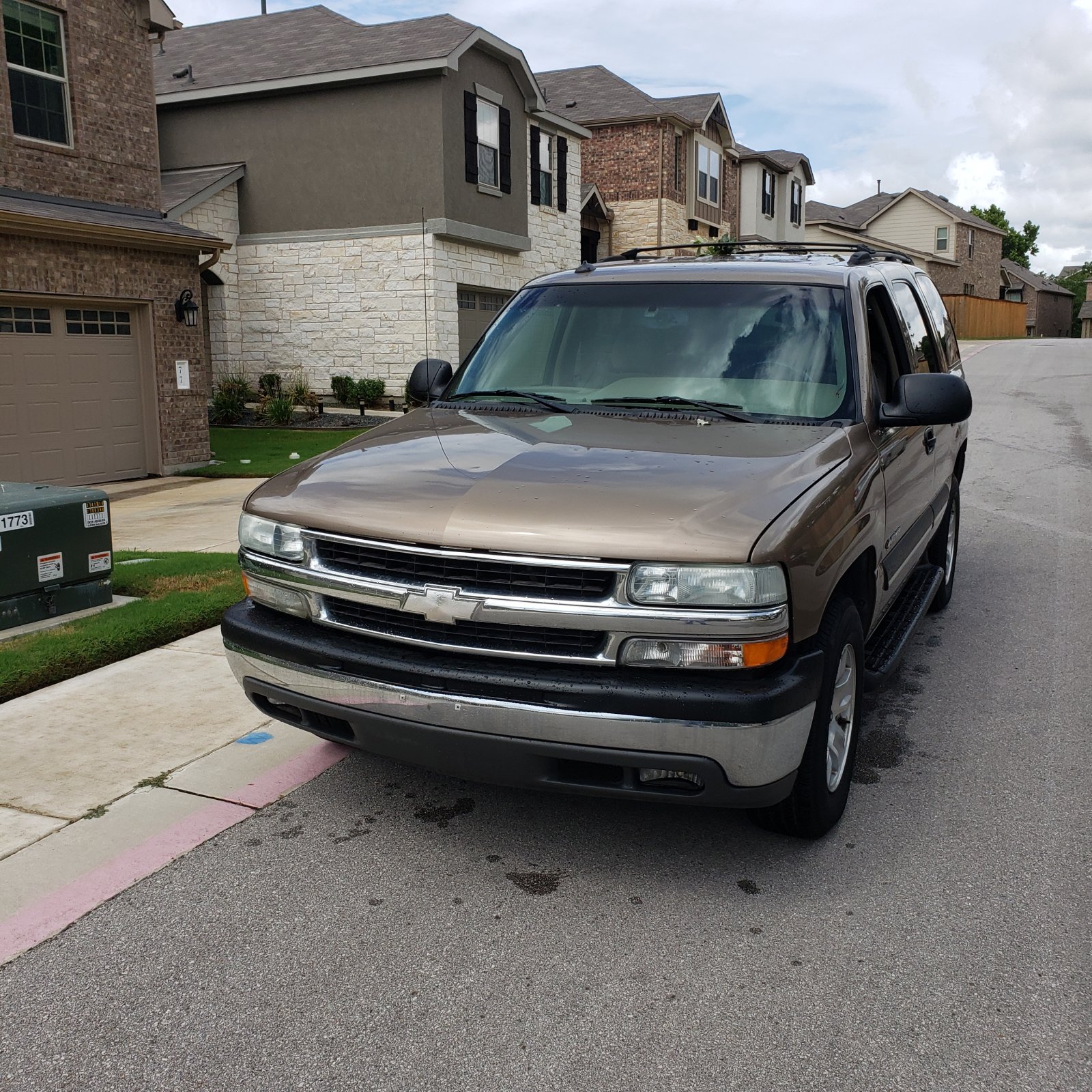

Couple weeks back I got a 03 Tahoe as my first car with 238k miles on it. Recently put in aftermarket headlights (still need to adjust) and tail lights (i haven't gotten any pictures of them installed but will upload when I get the chance). I also have a aftermarket stereo that I plan on putting in. I also plan on putting in some subs in the back and possibly replacing the factory bose speakers even later along the line. Mostly my other plans for it are just taking off the side door moldings, a leveling kit, and removing chrome parts off of it (front grille, bumper and rear bumper) and maybe different tires. Is there anything I should know and/or do to it before or while I'm putting in the new radio? Any tips, tricks, ideas or advice I'll take.

Congratulations, that looks like a nice clean and well taken care of machine.
What do you know about the maintenance history? Was it acquired from someone you trust to give accurate information about that? Most times when acquiring a used car with that many miles the focus is on correcting any deferred or neglected maintenance items. E.G. changing coolant, brake fluid, axles etc. If the previous owner kept up to date on everything then none of that may be needed.
You’ll also want to know the history on transmission maintenance to assess the probability of a significant repair cost, at 238k that’s the most common major item approaching end of life. If it’s original.
Enjoy the new ride!

Make sure you get a good install kit along with the proper harness. Metra and Scoshe kits are good, along with the chime box you'll need. If you replace the Bose speakers, those are 2 ohm, compared to a non Bose system's 4 ohm setup.

I really like the color of the rig. I like pewter or silver rigs but the ones I see with this color really catch my eye.
