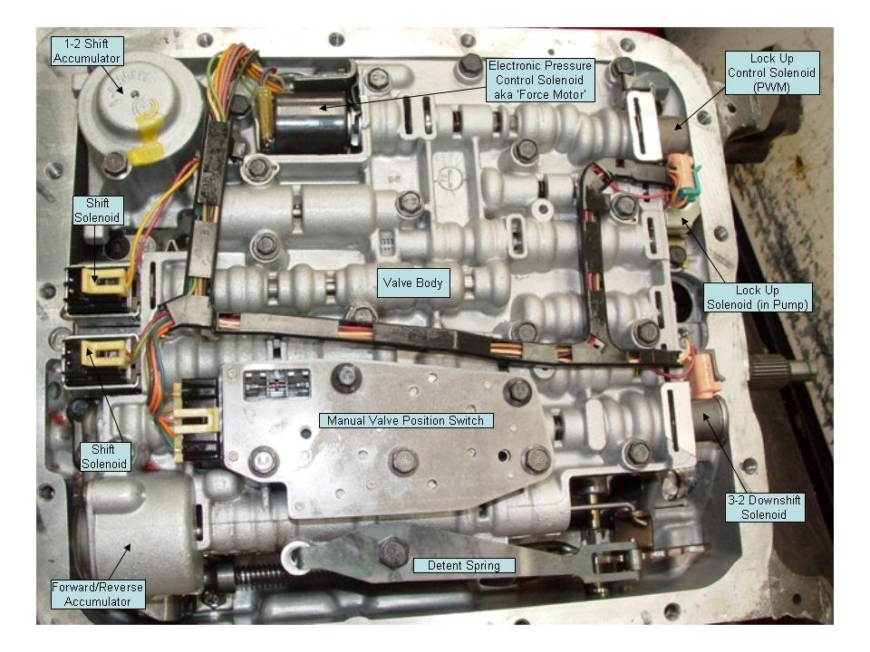

A stuck 1-2 accumulator piston or broken spring will cause this exact problem. Its not at all uncommon for the spring to break in half. In fact its very common to find them broken in half when the tranny is opened up for the first time since the factory built it. Also not at all uncommon for the guide pin to wear the center hole of the piston.
Very common during a rebuild for the 1-2 accumulator to need a need a new piston, guide pin and spring. Most shops will replace it anyway if original so the tranny doesnt come back. The purpose of the 1-2 accumulator is to soften the apply of the clutch pack instead of it being harsh and fast. If any of the parts are worn or broken then it will cause the 1-2 shift to be very firm and fast. Doesnt hurt the tranny at all, just most people dont want to be snapped during the shift from 1-2.
