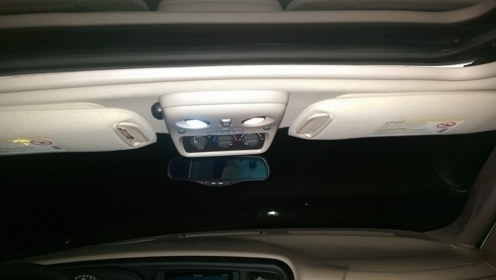

Interior LEDs. So bright and white... It was a mod that I kept on the back-burner for too long. Once you see the difference, it's hard to imagine how anything less was tolerated.
Comparison of map lights. Left is new LED and right is halogen

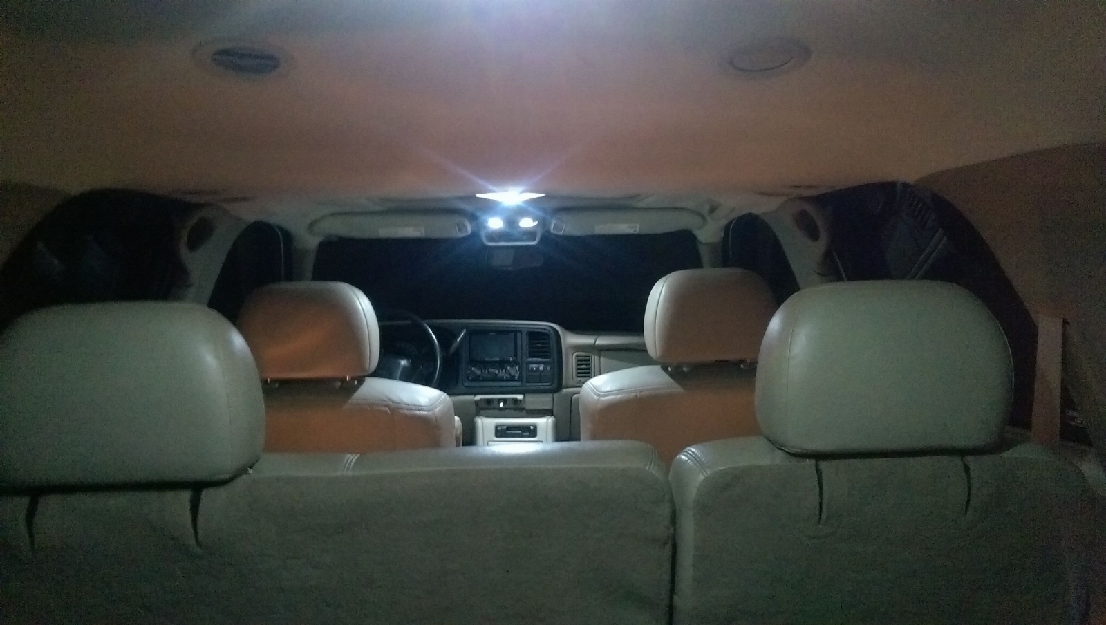

Puddle lights seemed to fit a bit more loosely than the stock ones, so I carefully wrapped some tin foil around the ends to make the connection more snug. You can pretty clearly see the dome lights through the tint as well...couldn't do that before.
And here's a view from the back. Pitch black outside plus window tint...now the dome lights are worth turning on!
