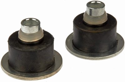

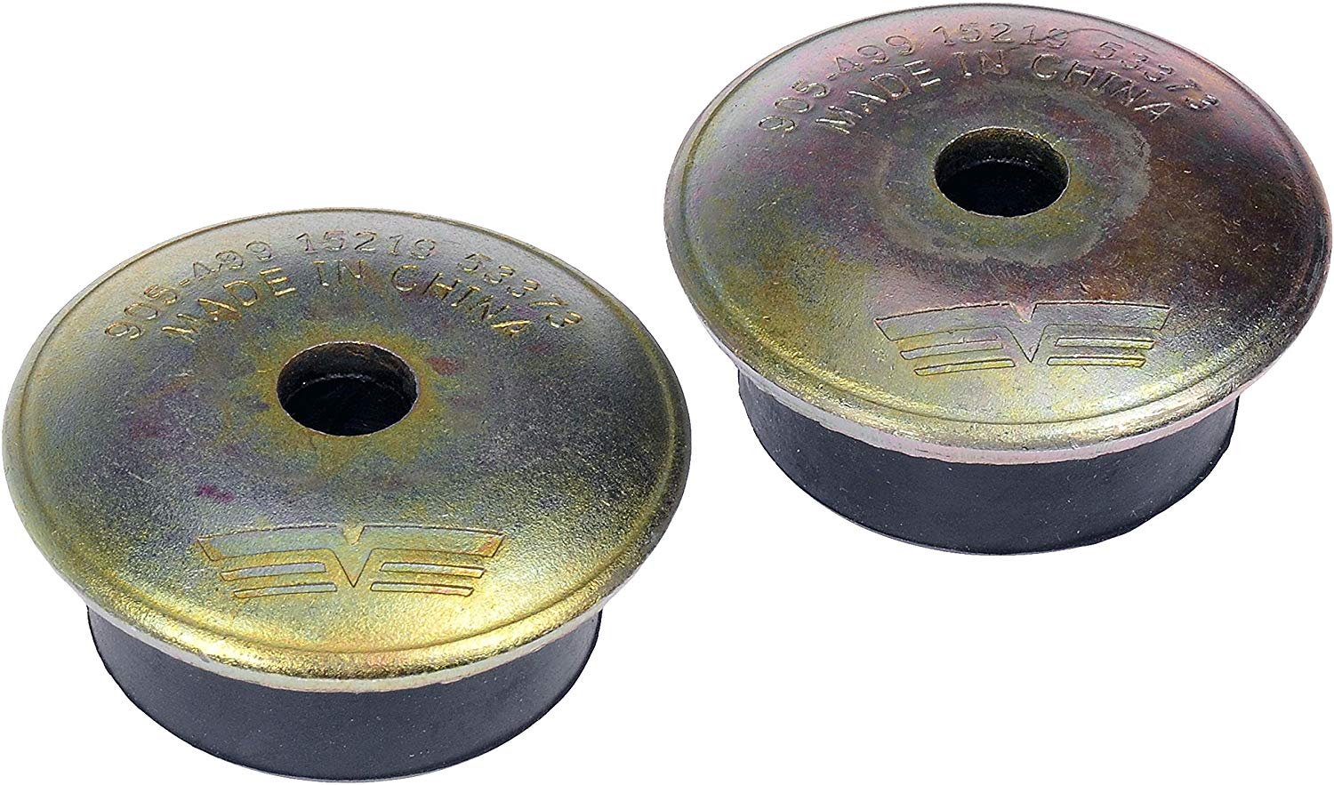

FYI, Make sure the front shock bushings are new. You will thank me later.
The Dorman ones available on Amazon are fine from my understanding. I got the GM dealer ones. These are the big solid round rubber pieces with large metal backing washers. They keep the top of the front shocks centered in the mount. Both halves (upper and lower). The lower has a center nylon guide which is very important on our model. Keeps the shocks from rattling around.
The ones that come with aftermarket shocks are usually lacking this nylon guide and are often thinner/cheaper...insufficient. Non-Dorman or non-GM ones will cause weird loud/loose suspension noises in the front going over bumps and such.

https://www.amazon.com/Dorman-905-5...hock+mount&dpPl=1&dpID=41ZCy4YI13L&ref=plSrch
https://www.amazon.com/Dorman-905-4...coding=UTF8&psc=1&refRID=08S9JDV1TW4633MNFZEQ
