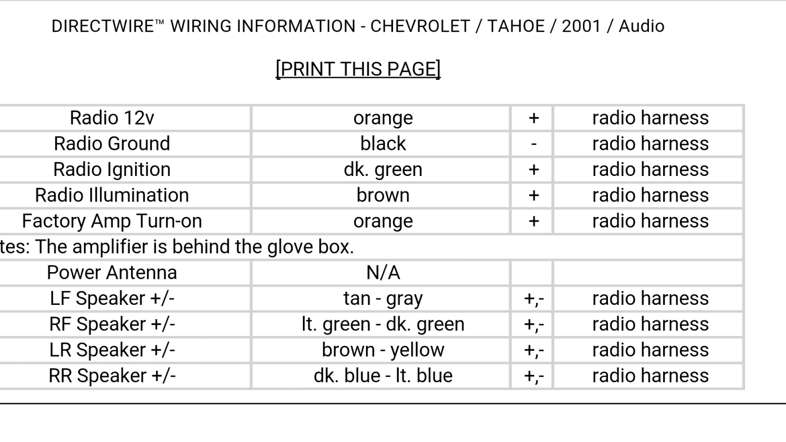

It would appear the orange wire is the amp turn on wire. And if I recall it is in the harness... should pretty well be plug and play

Turns out the orange wires were reversed or something in the harness. I had a minute to go check and jumped the amp turn on to the orange wires that was mated to the constant wire from the harness and it works like a champ even when moving.
