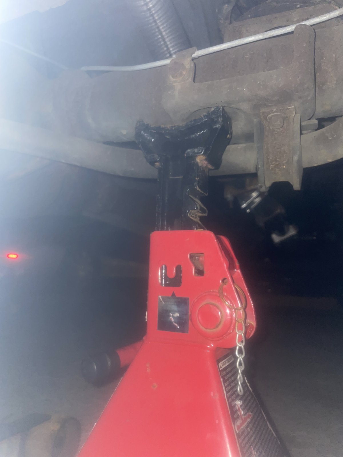

Is this what you meant last night? You
can see the sway bar is in the way but it’s right directly below the mounts which are attached to the rear axle.

Is this what you meant last night? You View attachment 456268can see the sway bar is in the way but it’s right directly below the mounts which are attached to the rear axle.
As long as the section of sway bar is directly under the axle tube. If the sway bar bushing bracket is wide enough, you could even set the curved section of the bracket down in to the curved part of the stand saddle.
I can see the sway bar itself, curving away from under the axle tube. If there is enough exposed axle tube, set the stand under the axle tube and let the axle tube down in to the curved part of the stand saddle.

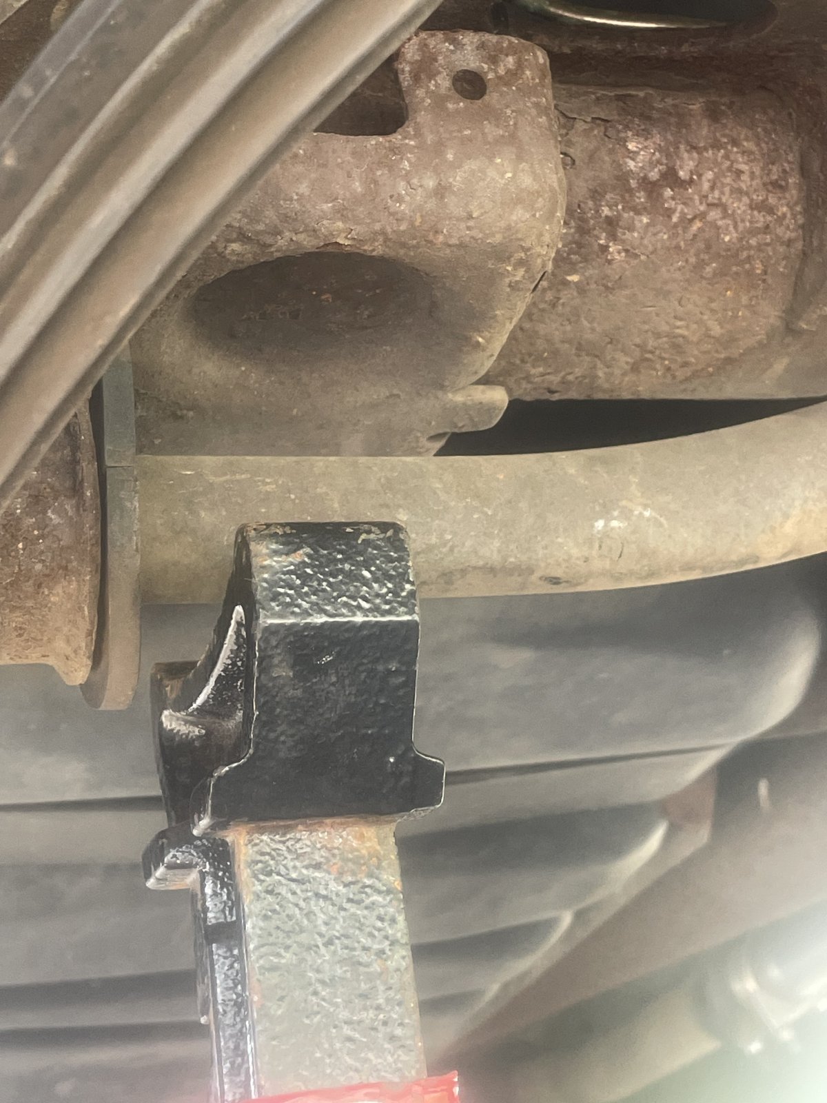

thanks! There sadly wasn’t enough axle tube space, but putting the jack stand on the sway bar where it is in the picture would be okay? The axle tube is literally right above it. And good to know about the bushing brackets, would make sense, as they’re attached to the axle.

Set the sway bar right down on the stand, again, as long as the axle tube is directly above the bar.
GET A BETTER FLOOR JACK!
