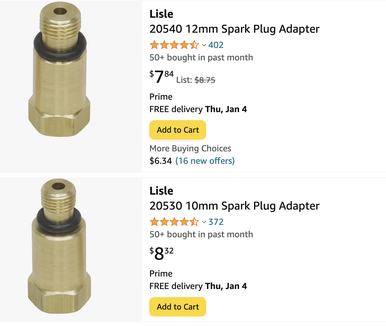

Are the post cat O2 sensors still there and hooked up? If so you can get a spark plug spacer and put it between the sensor and the pipe (make sure you get the right size). It doesn’t always work but is a lot cheaper than 2 new cats. I did see you tried something but not sure what it was (bung spacer).
Lol, yeah that's what I was told it was called. Same as what you are talking about. I spaced all 4...maybe I should do just the rear 2. Thanks!!
The front 2 control the fuel injection so they need to be in the exhaust stream. The rear 2 are only there to make sure the cats are doing their job. By putting the spacer in you are getting them out of the exhaust stream and not seeing the oxygen that should be depleted by the cats burning excess fuel. Programing (EFILive/HPTuners) is the only sure way to get rid of the codes/check engine light without putting cats back in.
