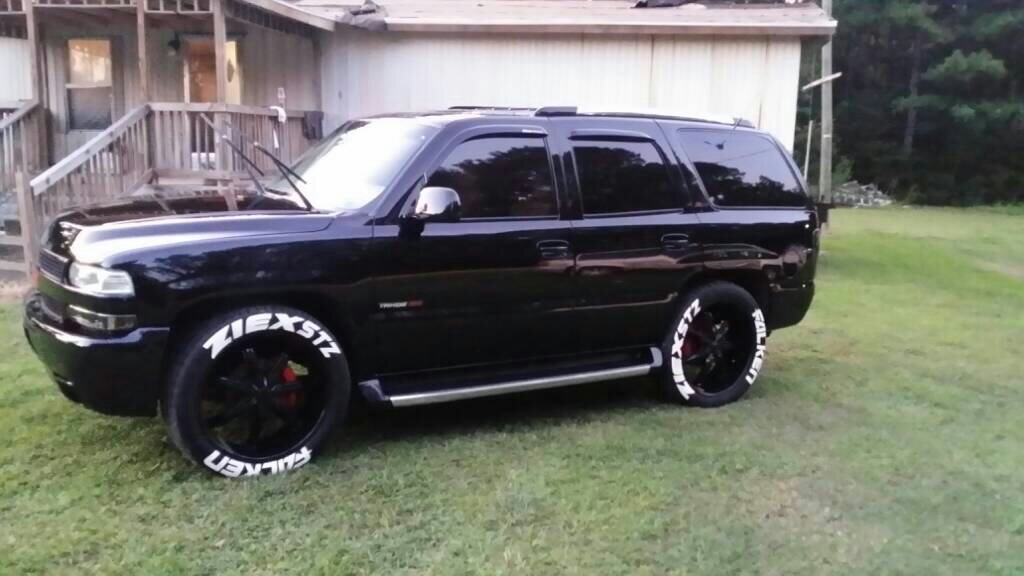

Your picture just shows a Vehicle with no motor??? At least that's what I see?? But if the compression and a leak down test checks out OK with your motor, your good to go!
