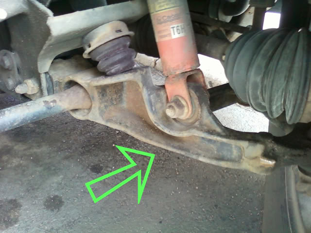

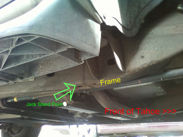

Related question, what's the best Jack point on these trucks? Is there a pinch weld or where can I put it on the frame?
rich5368
Feb 18, 2010
237
Cheyenne, WY
On the front i usually use the bottom shock mount area on the lower control arm to jack it up. Or you can always use the frame. thats where I set it up when i put it on a lift.
Last question, so when I jack it up on the lower shock mount, can I put the jack stand on the crossmember of the A-arm? or where? I guess I just need to crawl under there first . . . I know this sounds stupid but do you have a pic?

I checked the factory manual and crawled under there to take some pics. First, this is a pic of behind the front passenger tire - is this the "lower shock mount" you said I could jack it from?
Second, here's the underside behind the same front passenger side, you can see the frame and the body mount with the two thin metal strips coming towards the camera. The jack stand location is where the frame "doubles up" just behind the body mount (note the arrow) correct?

Those are the spots I use personally. Wal-mart brand brake clean is a little cheaper. I paid like $2.75 for it. Some guys jack from the frame point there and put the stand there as well.

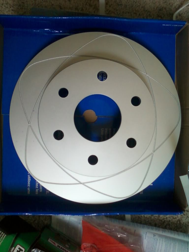

The new brake parts got here today - ATE slotted rotors and Hawk LTS Pads
ATE PremiumOne Disc Brake Rotors offer these advantages and benefits to the owners of domestic, European and Asian vehicles.
OE-engineered SealOriginal Equipment quality with premium features you can see that add convenience and help to enhance performance.
•Patented RotorLife wear indicator - Helps technicians and vehicle owners gauge rotor thickness at a glance, and notice when they are due for replacement.
•The wear indicator's interlaced elliptical grooves are machined into the rotor face at complimentary angles. - Groove design enhances dissipation of heat and gases to reduce brake fade, extend pad life. Looks great with cast spoke wheels.
•The MetaCote protective coating formulation is cured at approximately 572°F. No grease or oil to remove - Helps protect against road salt, brake fluid and other corrosives — sheds water and dirt for clean appearance behind cast spoke wheels. Reduces overall installation time.
•Application specific design is engineered to tighter tolerances than rotors that take a "one size fits all" approach. - Fits and performs like or better than the Original Equipment it replaces — provides added value and convenience for brake technicians and their customers. No machining needed.
