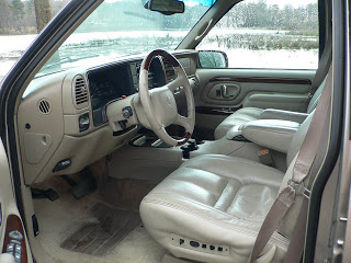

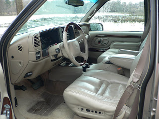

I don’t have photos of the donor truck, the shop which has the seats said they are from a 2000 Esky.
They are super comfortable and very good condition (I’ll take a photo next time I’m down there), but they look just like the photo attached.
Those are really nice seats. They asking alot? I have 95 Tahoe seats in my 05 Express van.
