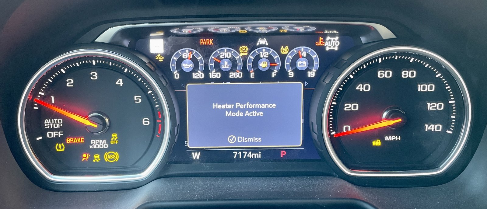

Here’s something strange. Twice now on days when the high temp was 0 degrees or less here in Iowa, when I go to remote start my ‘21 Tahoe and later get inside it the dash will display the message “Heater Performance Mode Active”. Anybody know what that means? I can’t find anything in the manual about it.
A few other observations about when it’s this cold. The magnetic shocks/suspension is real stiff and the steering wheel turns hard like I’m driving a vehicle with no power steering. Guessing all of that is normal since when it gets up into the 20’s it’s a much better driving experience.
Attached is a photo of the message that appeared.

This is what I found on the interwebs,
Heater Performance Mode (8-Cylinder Models Only)
When cold weather conditions are detected, the transmission raises part throttle upshift points after the 1 (First) to 2 (Second) upshift to increase engine speed. This feature shortens engine and cab warm up times. When the transmission is in this mode, upshifts may be delayed.
This is normal and does not indicate an operational problem.
