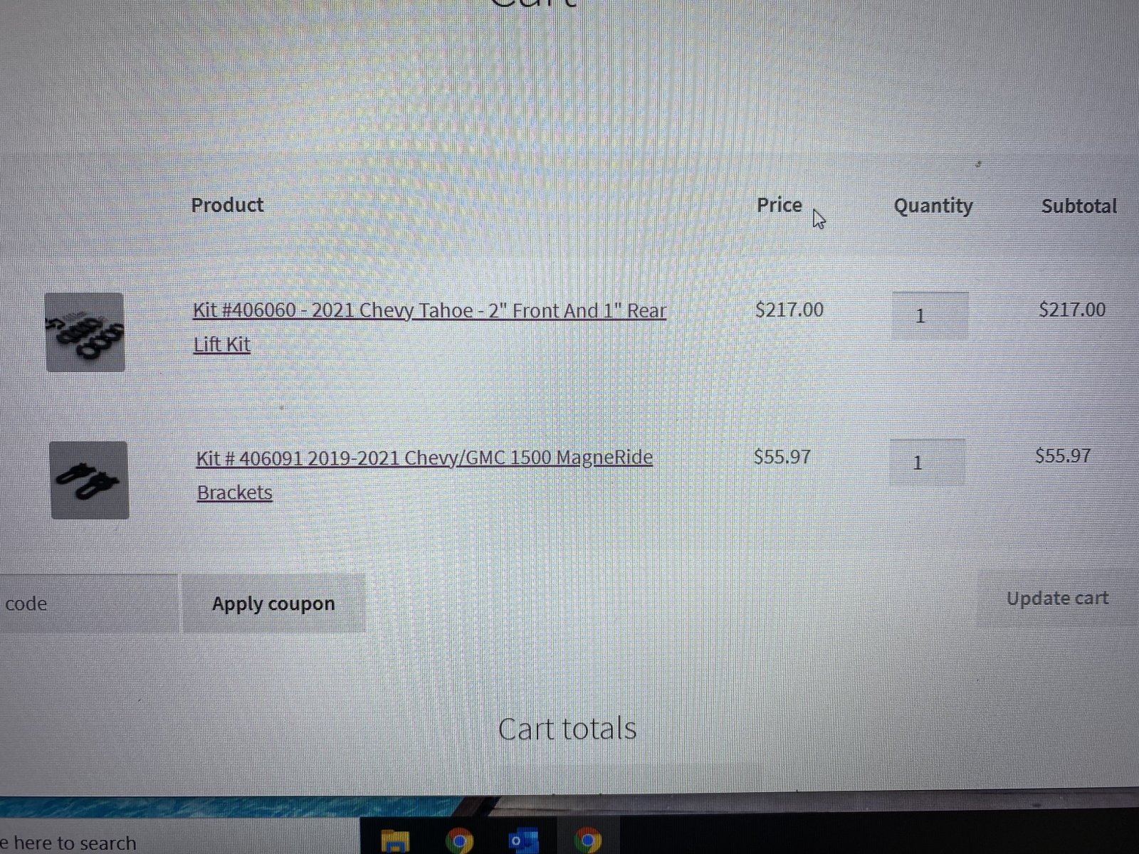

Check out traxdaliftkits.com. I spoke to the guy in the YouTube videos and he confirmed that he has a leveling kit specifically designed for 2021 Yukon Denali’s (2 inch front and 1 inch rear). I’m waiting for my 2022 Denali to arrive, hopefully next week, and I’m going to try a Traxda leveling kit. Give them a call, they are very helpful.
I recall pulling up the parts while I was on the phone with the guy and taking this screenshot for future reference.
