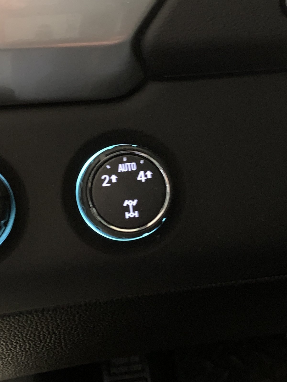

Not that it will help your issue, but can you post a pic of your selector knob with 2WD, AWD, and 4WD? I have 4WD and do not have the Z71 package.

Selector switch

Auto is 2wd normally, and 4wd when needed. Just a touch different from AWD.
