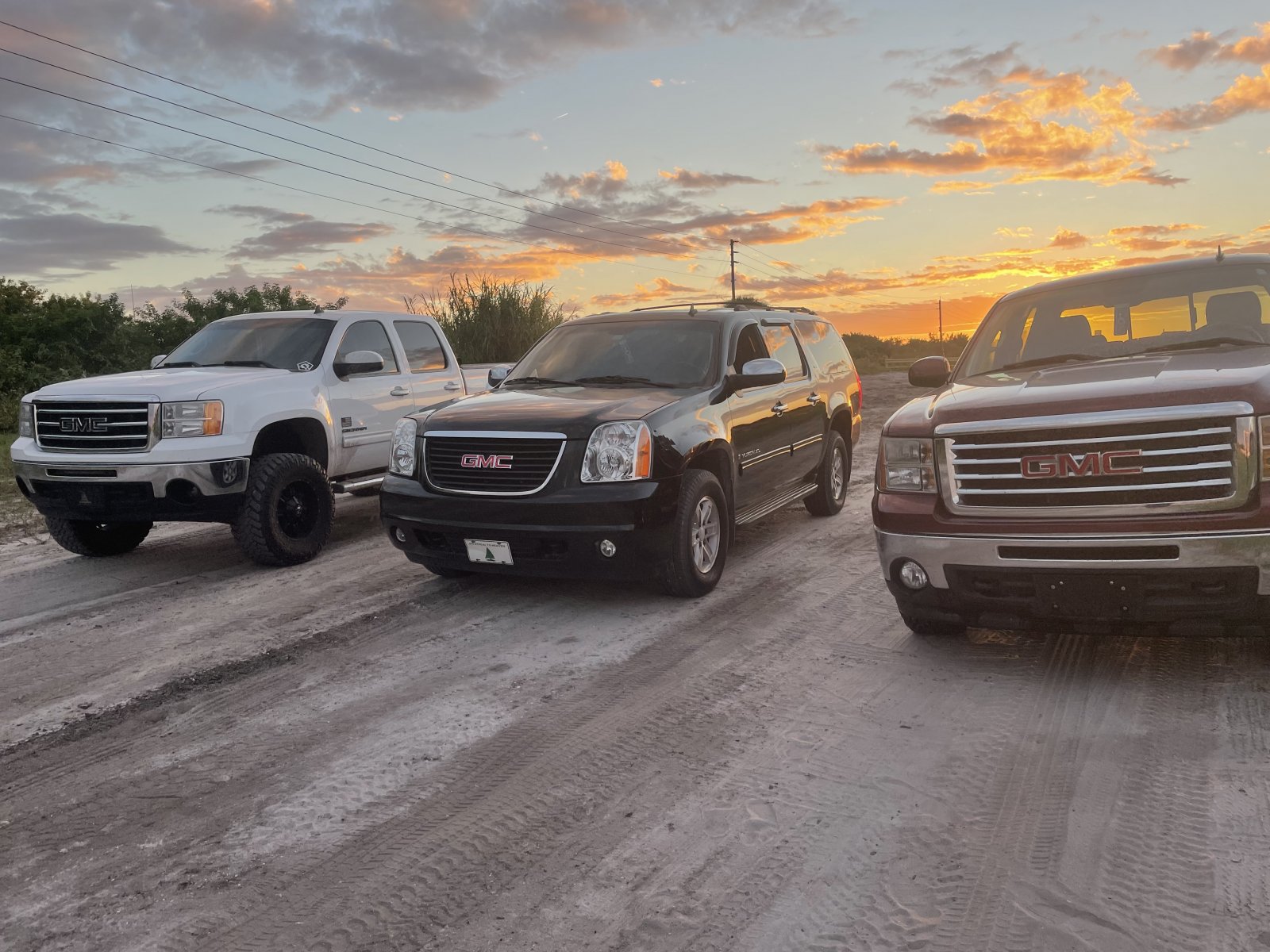

Got any pics to share yet?
Here's my little fleet, only one is a real Z71!

I think you’ve seen my turd-burban! I’ve got some more semi-progress stuff for it coming soon. I’ll throw a pic or two
of the new ride.
