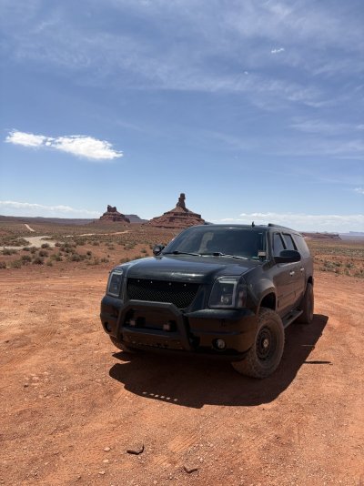

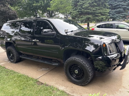

I guess pics would help. I found this forum researching so decided to join as I always have questions and love throwing ideas around. Best way to diagnose and figure out builds like what I’m trying to do is how I go about things
