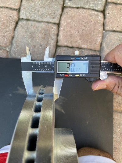

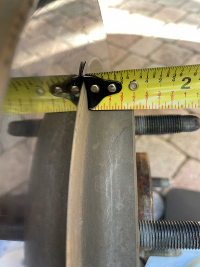

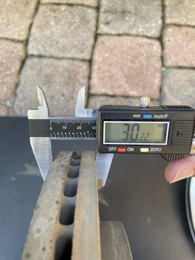

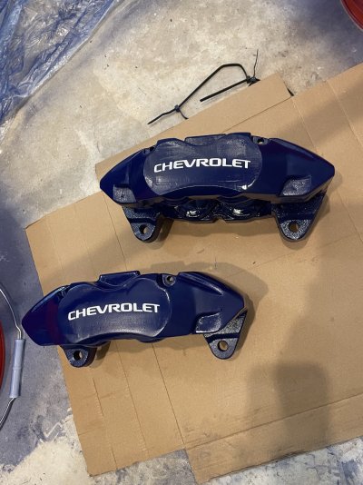

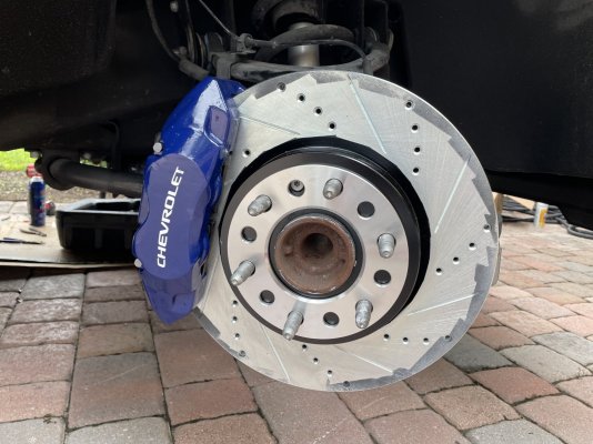

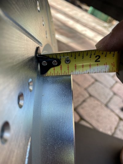

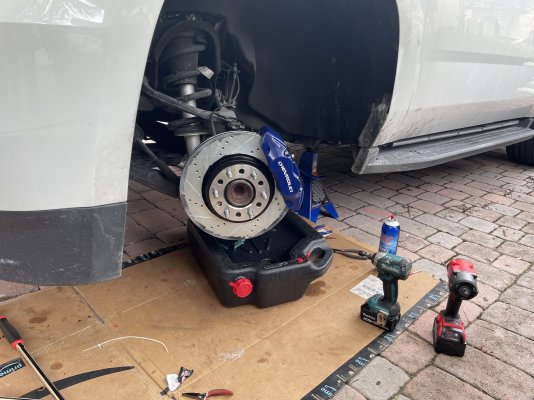

I noticed there's not many or any of these caliper swaps for the 15'-20' models so I'll post up all the info from my upgrade.

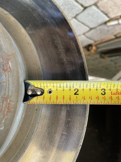

OEM Rotor specs:
Diam: 12.99”
Thick: 1.181” / 30mm
Silverado specs:
Diam: 13.58”
Thick: 0.790” / 20.06mm
Calipers:
GM# 13545382 DRIVER
GM# 13545383 PASS
8 1/8” thick washers/spacer so the caliper can center with the rotor.

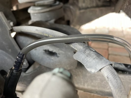

Banjo bolt:
GM# 11569589 30/ftlbs
Caliper bolts:
GM# 15016308
OEM 18" Wheels
1/4" spacers for the Calipers to clear the wheels
Rotors:
RST Dana

So far I’ve driven over 500 miles now and the difference is night and day. Very pleased with no complaints

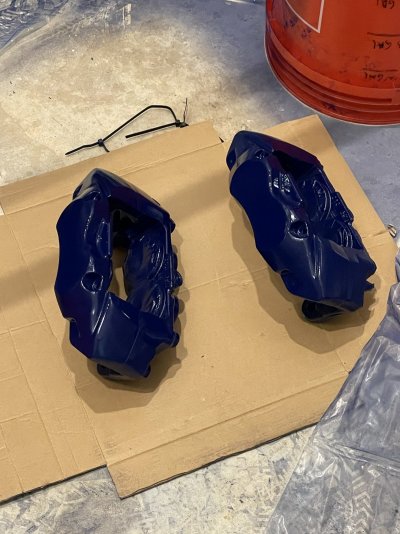

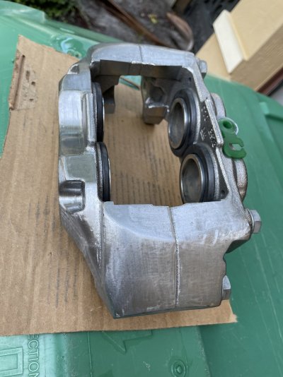

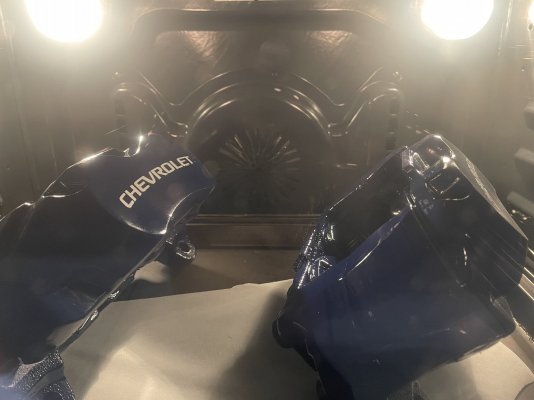

When you put them in the oven, did you remove the pistons?

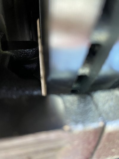

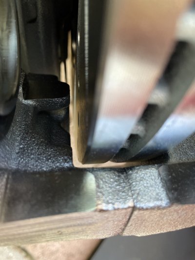

Outstanding post and how to. So my '19 Yukon XL SLT has 20" wheels/tires, so probably no grinding is needed?
mach1z
Apr 26, 2020

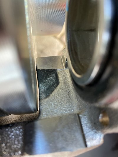

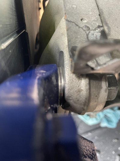

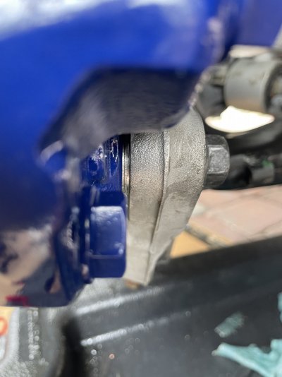

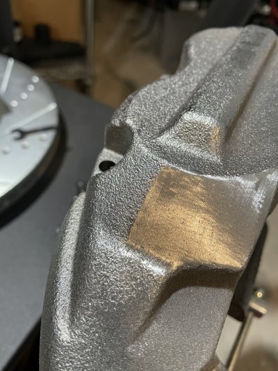

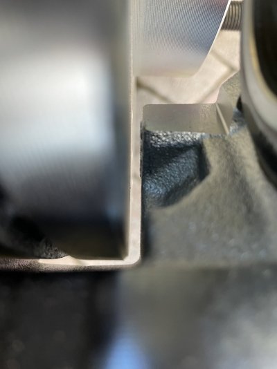

Here is a photo with caliper on my 2017 TAHOE with Z71 Wheels-18in. One could get away with grinding a chamfer on to the inside edge of the caliper before installation. However, I did the grinding after it was mounted so I had to touch the center rib to get that angle.
