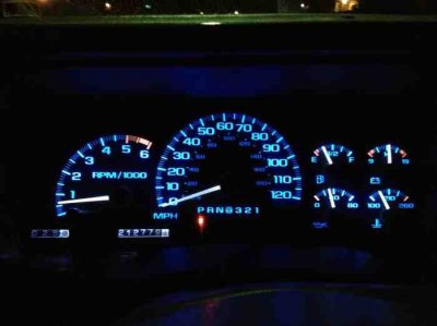

it would be a bummer if the tires had exploded
140 is fast as hell though in a tahoe. I've only been up to the limiter passing a train of cars that are too stupid to pass someone. :lol:
Sure and that picture you took at night at 95 to show us your fancy new voltmeter.
I've hit the governor a few times, mostly goofing off, but there have been a few times I got close passing a long line of weenies.
I was following my mom on a road trip in that pic. :lol: I swear to god I took about 10 pictures that night and they all came out blurry except for that one. :happy175:
