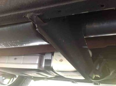

johnsoex
Dec 25, 2011
84
I had lt headers with no cats and a magnaflow and it was way too loud. Changed to borla and it was better but still loud. I added another borla and a 14 inch manga flow resonator and now it's quiet, very quiet until I get on it and then it opens up nicely.
Pacesetter coated Lt headers, y pipe, resonator, single in single out to single in dual out after the pass rear wheel all thru 3 inch pipe is a good way to go if you want flow but not the loud sound.

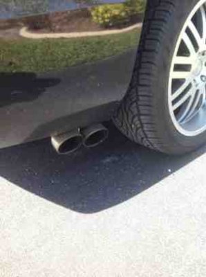

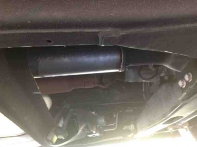

Where did you find space to put two mufflers and a resonator?
Do you have pics of the setup?
johnsoex
Dec 25, 2011
84
ImageUploadedByTapatalk1334519404.927416.jpgImageUploadedByTapatalk1334519430.689208.jpgImageUploadedByTapatalk1334519452.754060.jpgImageUploadedByTapatalk1334519465.086611.jpg
Here are a few pics. Sorry for the quality. Dropped 2/4 so its hard to get under there.
There's not much tubing. Lt headers into the y, then apprx 3 inches of pipe (just enough for the wide band bung) into 14 inch resonator, which is welded right onto the first borla, 2 inches of pipe then into the second borla, then duals over the axel turned out to the side.

Wow what a great idea to make it a bit more quite. Looks good underneath too.
