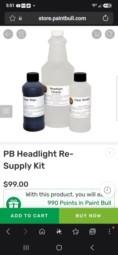

I use this stuff. I used it when I had my business. I never had any complaints. Screenshot_20260806_175153_Samsung Browser.jpg
The big bottle cleans the yellow off the lights, then you need to sand the headlights--differing grit of sandpaper depending how bad they are--then you buff with an orbital polisher--use 3M plastic polish--then you need to mix 1 cap full of each small 4 Oz bottle together in a separate small cup--then fold a.lintless towel--paper towels will leave lint behind, you don't want that--I fold it into a smallish square, dip it in the mixture and apply it evenly on the lights. Swipe it on going from left to right--or right to left, it doesn't matter, as long as you apply it going in the same direction. Make sure you the complete headlight is coated. Be careful you don't get any drips, if you do and you try to fix it you must do it IMMEDIATELY. It dries very fast.
I'm terrible at trying to explain stuff.
The 4 Oz bottles--last time I checked--was $45 each, so far the extra $9, it's worth buying that bottle of cleaner too. Those small 4 Oz bottles do quite a few cars.
