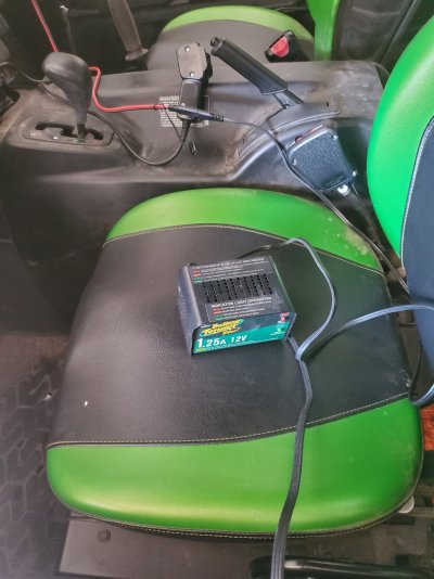

I'd get a battery maintainer/tender for it. When not in use have it plugged in. Even if in your current situation you end up getting a new battery.
Depending on which one you get. Get a hardwire cable or extension with terminals to wire it to the battery. Then run the line somewhere up in the front. So you don't have to open the hood every time to plug it in. My truck (ram) doesn't get driven much so after each time it gets plugged in. Doesn't even take 5 seconds to grab the tender plug it into the truck and plug it into the outlet. I got the 6' hardwire cable and ran it so it comes out of the lower grill on the front bumper. You wouldn't even notice it unless you were really looking for it.
I also did this on my aunts suv since she works from home and rarely goes anywhere. Hell I even have it on my side by side that stays plugged in all winter unless I need it to plow.

so I can wire that to the battery and leave the plug in the engine compartment?
Yep.
On my ram attached to the battery.
Where I have the plug for it coming out in the front bumper. When it's not in use I flip the plug up into the bumper and it's out of sight.
On my side by side the battery is buried under the air intake in the front and a bunch of other crap.
For now I just have it ran into the "cab" area. I just wind the cable up and store it out the way when plowing. I haven't decided yet on how to finish it. I've seen some cool plugs where you can mount them on a flat surface. So I might do that eventually.
