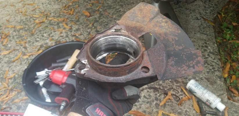

Bought these for nothing. View attachment 352900
The center of the hub separated, but the hub end piece is stuck. Not even budging. Beat it with a mini sledge--no dice. View attachment 352901View attachment 352902View attachment 352903
Axle is out.View attachment 352905
Would heat help to get the back end off the spindle? Any suggestions or ideas to get it off?
Air hammer. I live in the south and salt is here but… when I rebuilt my whole front everything came apart. The only part I needed the air hammer was the bolts for the upper control arms.
And I’m working 16hr days to feed the beast. Good luck my brother!

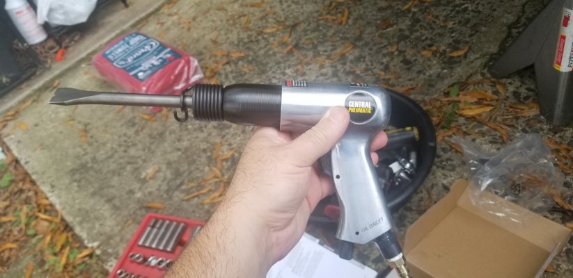

All done.
Literally took 2 mins and it was off! HALLELUJAH!!20211016_123940.jpg20211016_124238.jpg
Well worth whatever I paid for it. I also installed a new cv ds axle. Weird thing--the brake maintenance light went off, but the abs light is still on. I tried to clear the codes but they just kept coming back. Next step is to swap out the ps sensor--and take it from there.

Great! And you have a nearly indispensable tool now. Next to a torch and impact wrench that is a rust belt mechanics best friend. I knew it would work.
