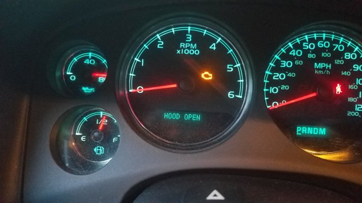

Guess I get the fun project of replacing the pressure sender. Yaay
Should I look for a specific brand or just any from the parts store?
I was just watching a video on replacing the sender with a socket and wobble socket, there is also a lisle socket for it I believe as well, the guy did it in like 5 minutes, I think I saved it
lisle 13250
30,765
48,460
So should I replace the screen that's under the pressure switch or just remove it? Why is it there?
I think it is put there to keep the sensor from getting clogged, some people replace it, some people take it out. :shrug:
if it's not that hard I would probably just replace it, just do like the guy does in the video.
