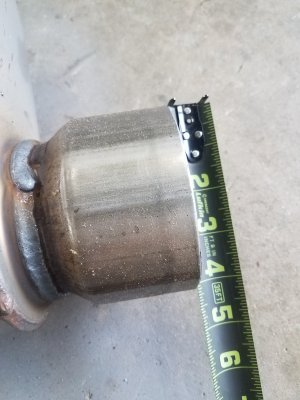

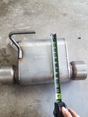

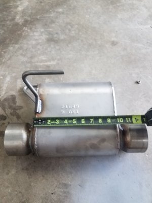

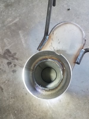

Here's some details on the Ram factory resonator, I was worried it would be super restrictive but its straight through! Necks down the 3.5 right where the pipe meets the case then it appears to open back up to 4" inside so I'm not worried about any power loss.
Super pumped to see and hear all this stuff cobbled together by a pro.
