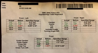

I replaced my tie rods yesterday, and had it aligned today. Taking an 800 mile round trip to MO soon and wanted everything to be perfect. These tie rods have been on the truck over 6 years, and around 110,000 miles on them. Only signs they were aging was leaking grease boots, but tire wear has been fine. This will be the third set I've had on the truck: the originals, and now this will be my second set of MOOG replacements.
