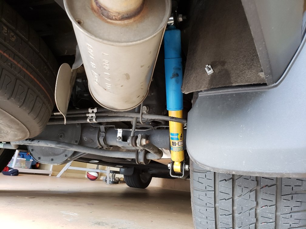

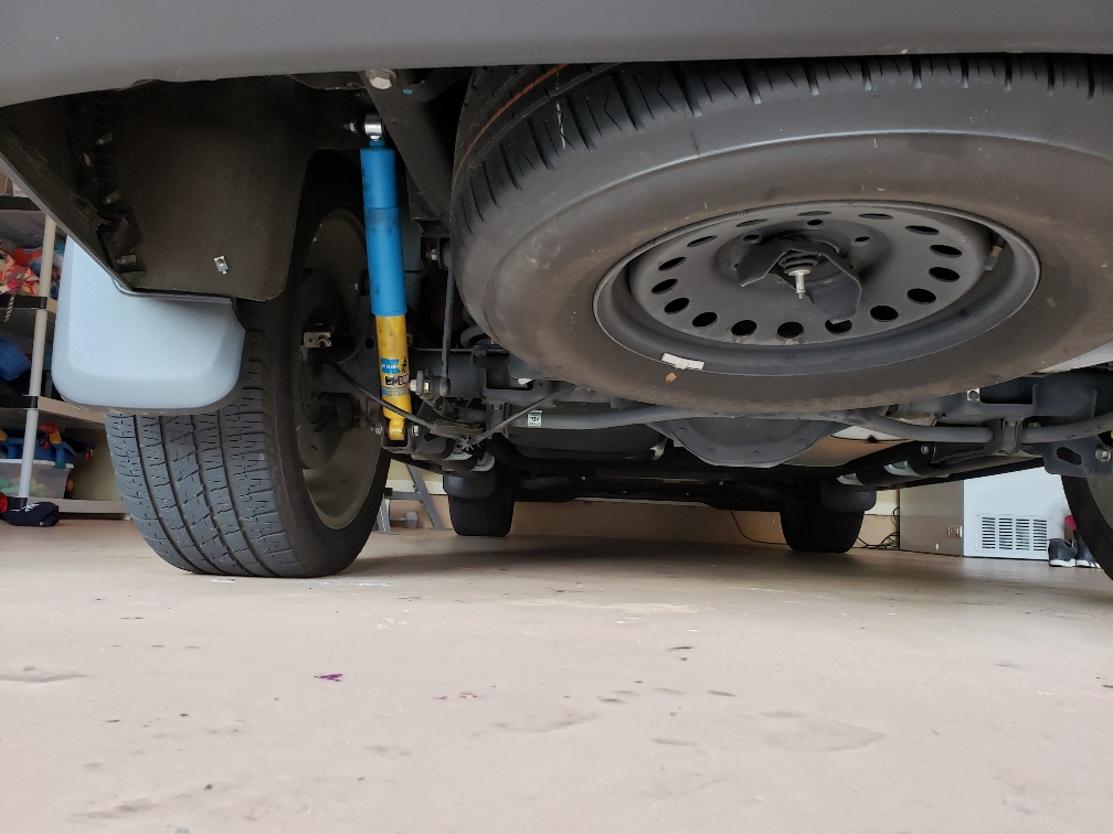

66
Got the Bilstein 4600s installed today. Took about 45 minutes total. Not a huge fan of how you have to get to the top shock bolts but other than that it was very easy and straightforward. Only tools needed were a 21mm socket with adjustable head and a 21 mm ratcheting wrench. It does help to have a 3rd hand when getting the bottom bolt through. I just pushed up on the shock body and my 5 year old pushed the bolt through. Can definitely tell a difference in driving. The rear end has way less "bounce". Can't wait to get the fronts done. Definitely recommend this upgrade.
