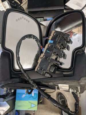

Is this all I need to add the turn signal power fold mirrors or do I need the passenger door switch also?
30,526
47,955
You don't need the passenger side. Do you have the proper driver side switch? Those the correct DL3 mirrors?
ya I saved the mirrors off of my 03 and got the switch today out of a 03 tahoe with power fold/turn signal I am going to put them in the 05 should be plug-n-play just wasn't sure on the passenger switch
33,181
51,390
Let me know if it's truly pnp. I tried to do this in my 03 and couldn't get it to work. @Sam Harris tried helping me too. I did get the turn signals in the mirror to work tho.
30,526
47,955
did you use the right switch? and were the mirrors power fold? if they were then the only other thing I can think of is maybe a updated bcm calibration would be needed
